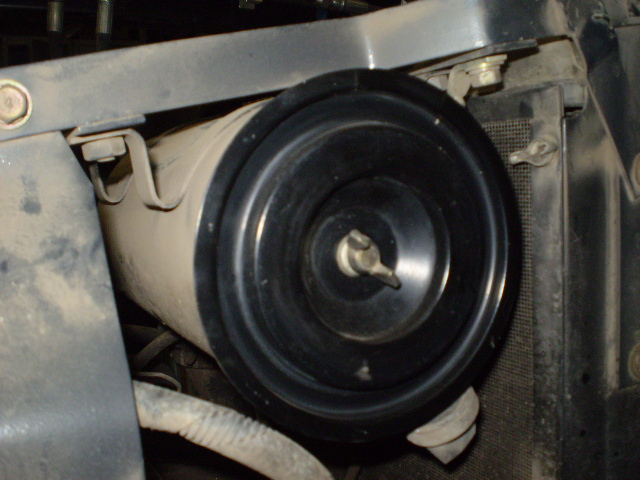

I,ll post a few pics , Of the filters on the Tractor just in case it might help . You might look at the spin on Hydraulic filter ( at least I think thats what it is in pic 3 ) on mine & see if it even resembles yours . My 247 did not have one like this . Thanks again , Bob

This is the info I have on a TA 270. I think they are really close to the same motor. Hope this helps
Oil NAPA 1568
Air Wix 46496
Fuel NAPA3507
Hyd. Wix 51712
