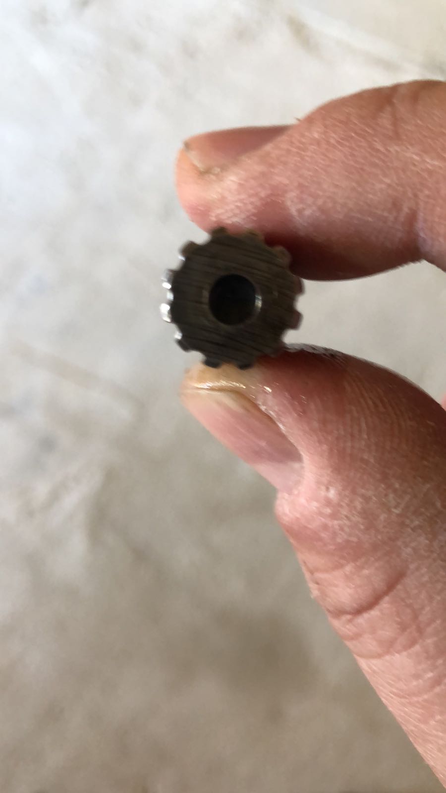

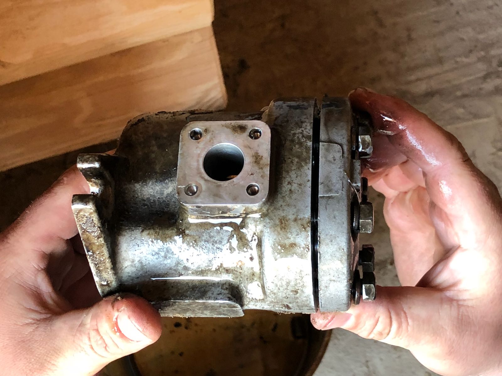

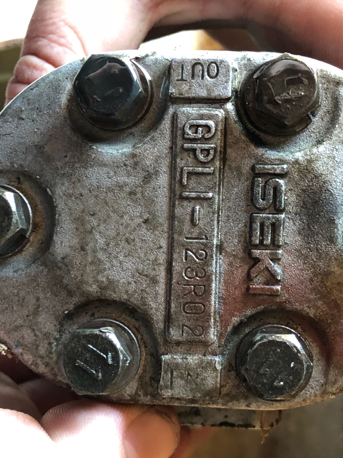

Do You know where can buy ISEKI HYDRAULIC PUMP.
Pump number: GPLI-123R0.

Ouch, that IS a problem! I suspect you have already done an exhaustive search for this pump. The pump appears to be hard to find. I again would suggest contacting Sheafer's Town & Country Sales Department . The owner, Len Scheaffer is very knowledgeable and can sometimes get rare parts directly from sources in Japan. In the end, if you can't find a new pump, I would take the pump apart and take the broken shaft to a good machinist and see if they can machine a new one.

I think your pump was possibly made by Kayaba (KYB). I see that their gear pumps use part numbers that start with "GPLI- " on the pump bodies. You may try to find a company that specializes in KYB pump repair/rebuild/replacement.
   / ISEKI TA437 HYDRAULIC PUMP #6
I called Kayaba Americas and gave them the information. They would not confirm or deny that your pump is a KYB but as soon as I told them that the number on the pump started with "GPLI" and "Iseki" they stopped me and said that KYB does have "proprietary agreements" with Iseki and as such, information, parts or replacement pumps would have to come through Iseki. Have you tried an actual Iseki tractor dealer ( not just an Iseki importer/seller)? There are none in the U.S. but I am certain there are factory dealerships in Europe, Asia and Australia.
