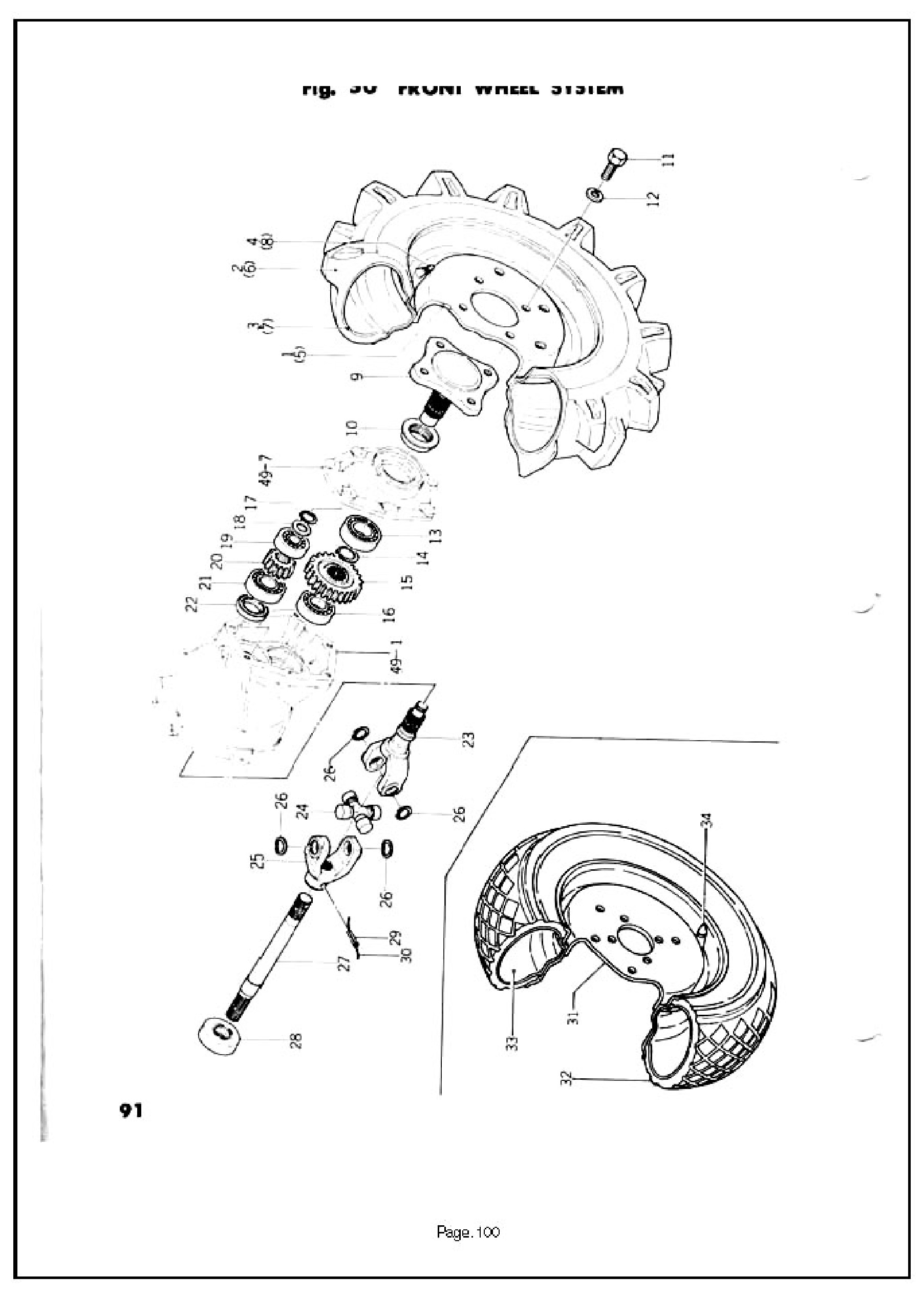

I would like to know if anyone can tell me where I can find the replacement oil seals for the front wheel system. Or has the reference numbers, to the seals that replaced the original oil seal numbers. The following are the original part code numbers to the seals I am looking for. I have attached files to show seals.
Each oil seal has two part code numbers they might be found under
Diagram No. 10
Oil Seal
1871754
Or
1427-433-0110-0
Diagram No. 22
Oil seal
1860729
Or
V74212-540050
If anyone can help, I would really appreciate it.

Take the old seals (if you have them) into an auto parts store and see if they can cross-reference them. If they can't get an exact cross, just use the O.D. and I.D. of each seal. I did this and the replacements worked fine. The thicknesses and whether or not they have a metal backing ring may be different, but seals made for the same hole sizes will work.
   / Iseki TX1000F Compact Tractor Oil Seals #3
You may want to try Sam's Bolens. He may be able to help you.
