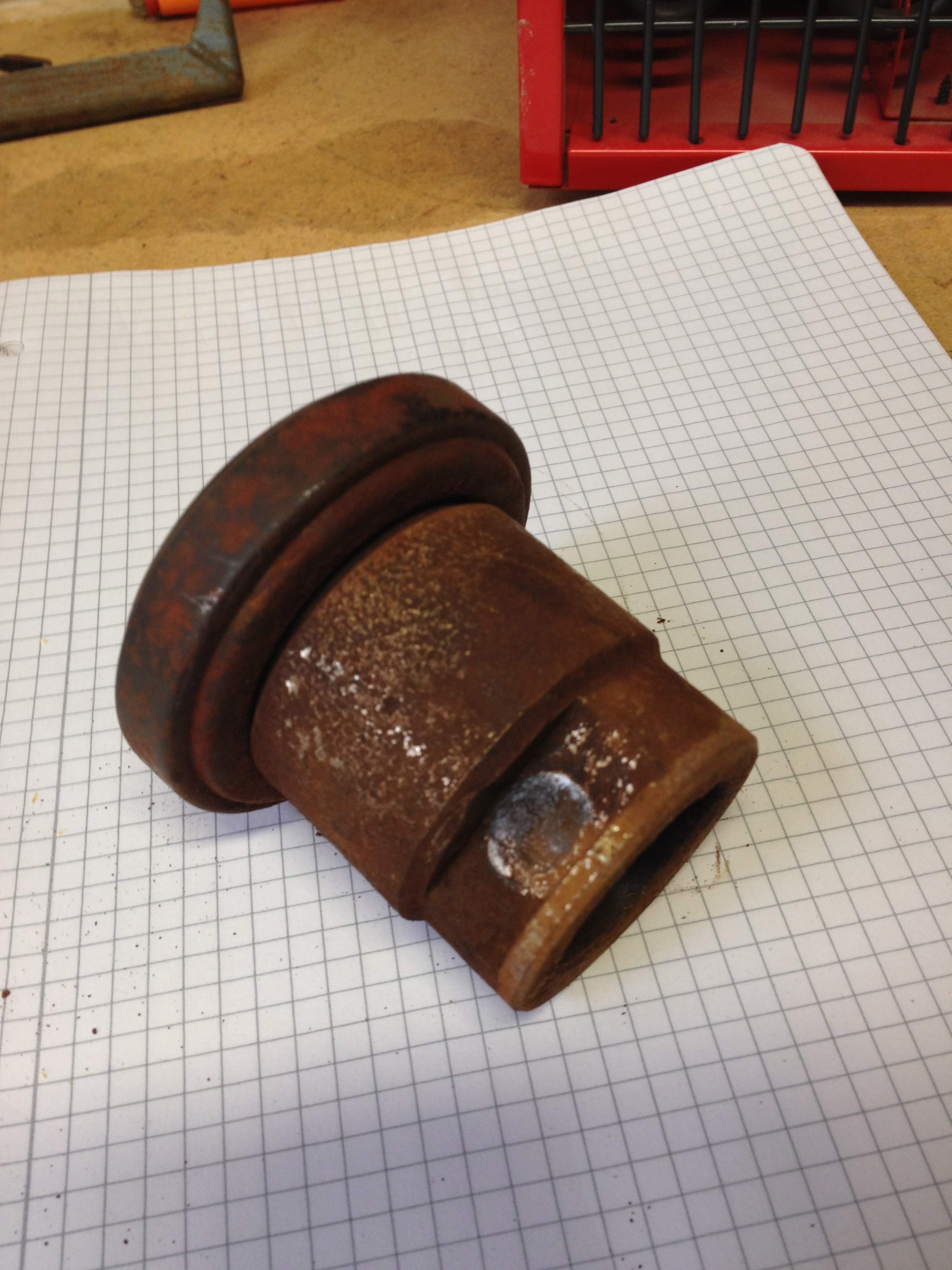

I have just replaced the clutch disc, clutch cover, pilot bearing and the release bearing. On my tractor, the release bearing was making a lot of highfrekvense noise, when i was clutching, before it broke down. Nothing happend when i pressed the clutch pedal. I had to start it in gear to get it inside the garage.

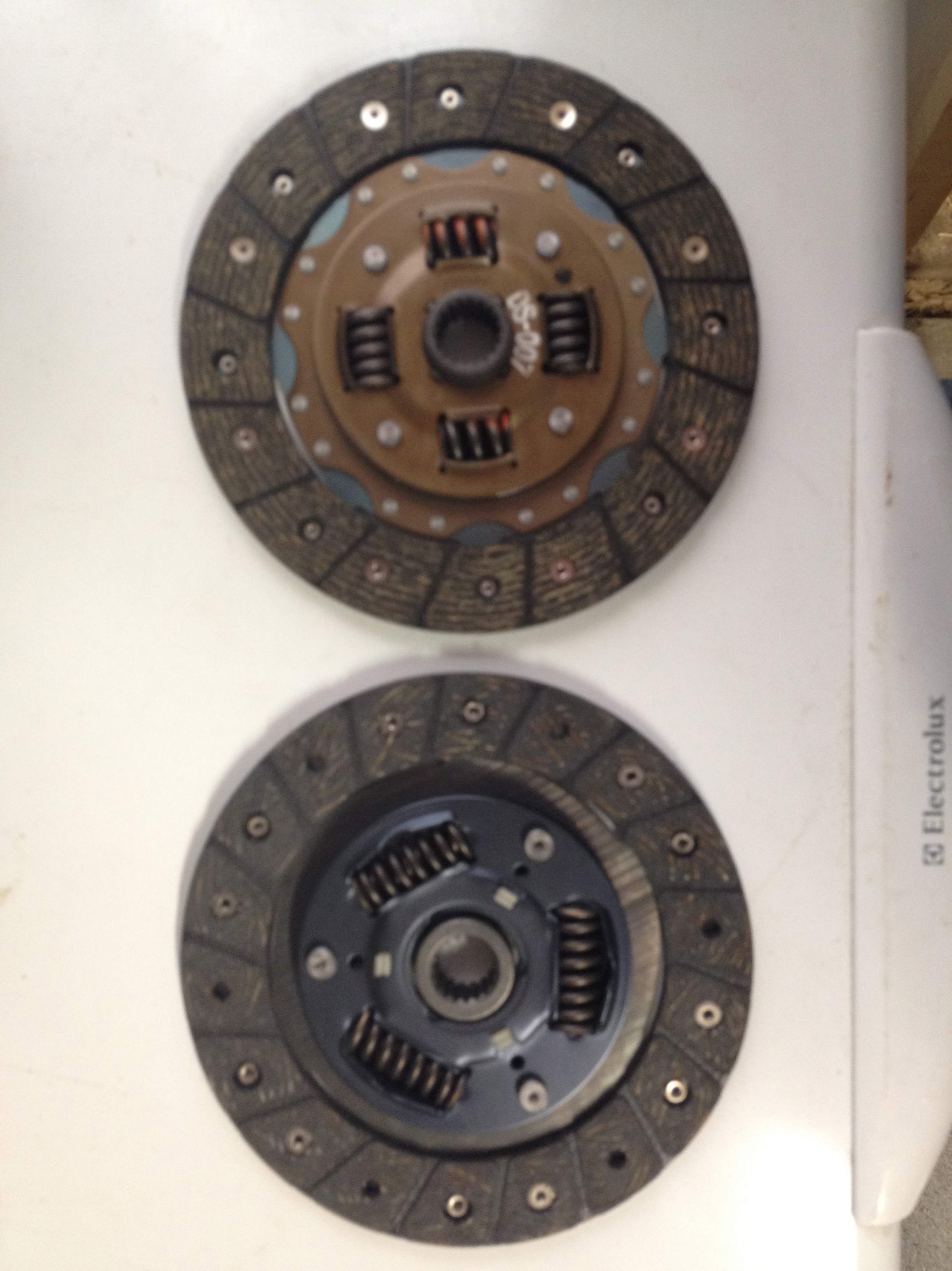

I first order clutchplate , cover and release bearing(throghout bearing) from bestfarm parts.
disc CDI 1427 (this has 18 splines, and an outer diameter of 181 mm)
throw out TOI 1416
pressure plate PPI 2400
Total price with USshipping $234
I wanted all the parts to be correct, before i opened the tractor. Unfortunate there seems to be some Isekis with a inputshaft with 13 splines, and this confused me a bit. I talked to some dealers, but they could not tell for sure.
Reordering parts.
Ordered from JeffCube on ebay.
JeffCubes clutch with 4 springs.
They both had 18 splines and an outer diameter of 181 mm - And they both fits my Iseki tx 2140f

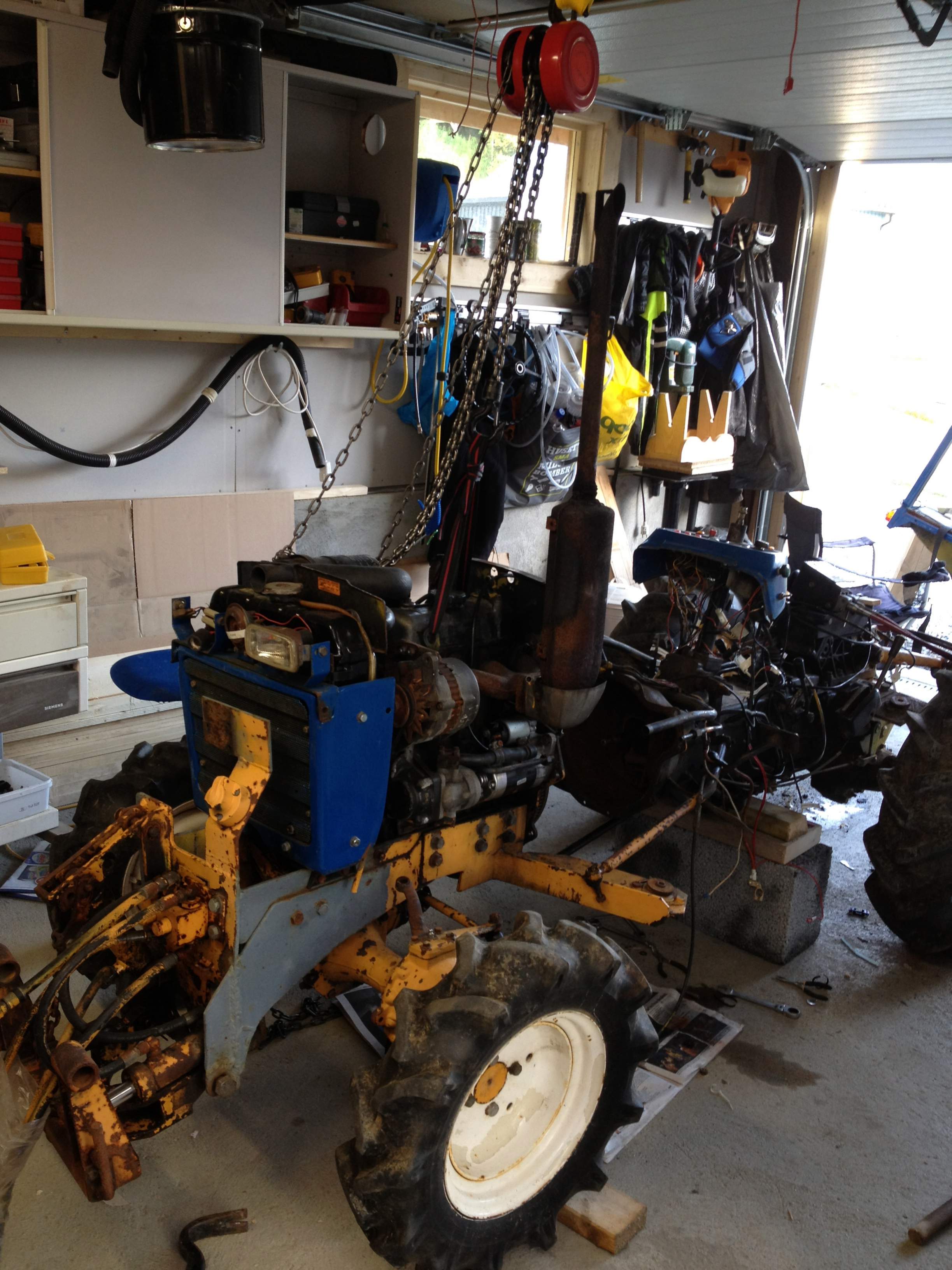

The splitting
You just need a simple hoist, a brick and some woodparts. some good wrenches, 17 and 19 mm, some smaller wrenches, and socket tool set, and a cheap balljoint separator.

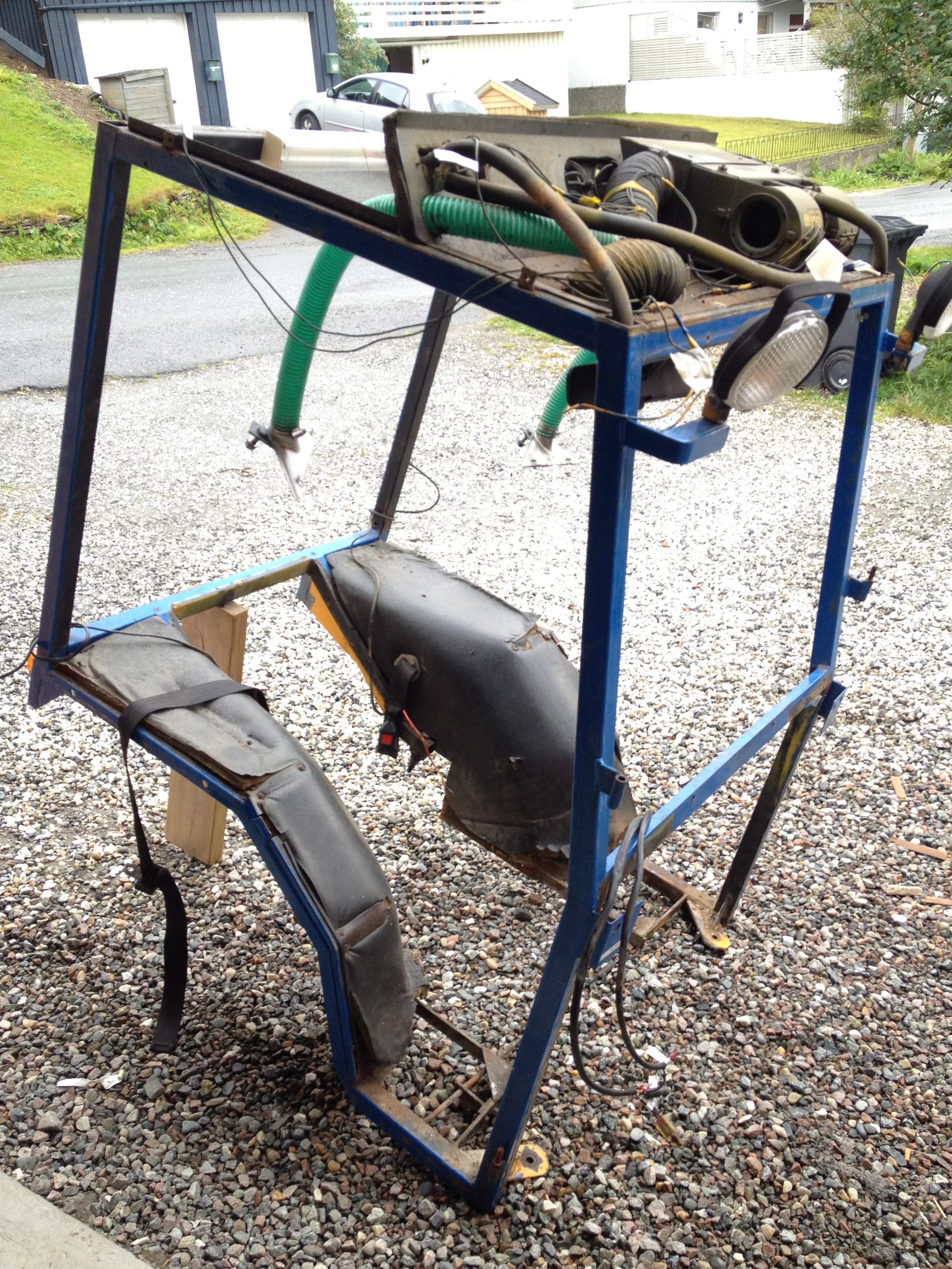

In my case i had to remove to cab, with watertubes to the heater.

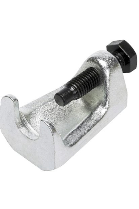

removed the battery and tank, and the bracket under. The electrical cords on left side only (starter, generator). And just the front end of the steering rod (see pictures)This was only time we used a special tool- bolljoint separator. 2 hydraulic lines also have to be devided on the left side.
On right side we left the electrical cords. Removed the accelerate rod. Removed one bolt for the sleeve for the front wheel drive
Then split it :)

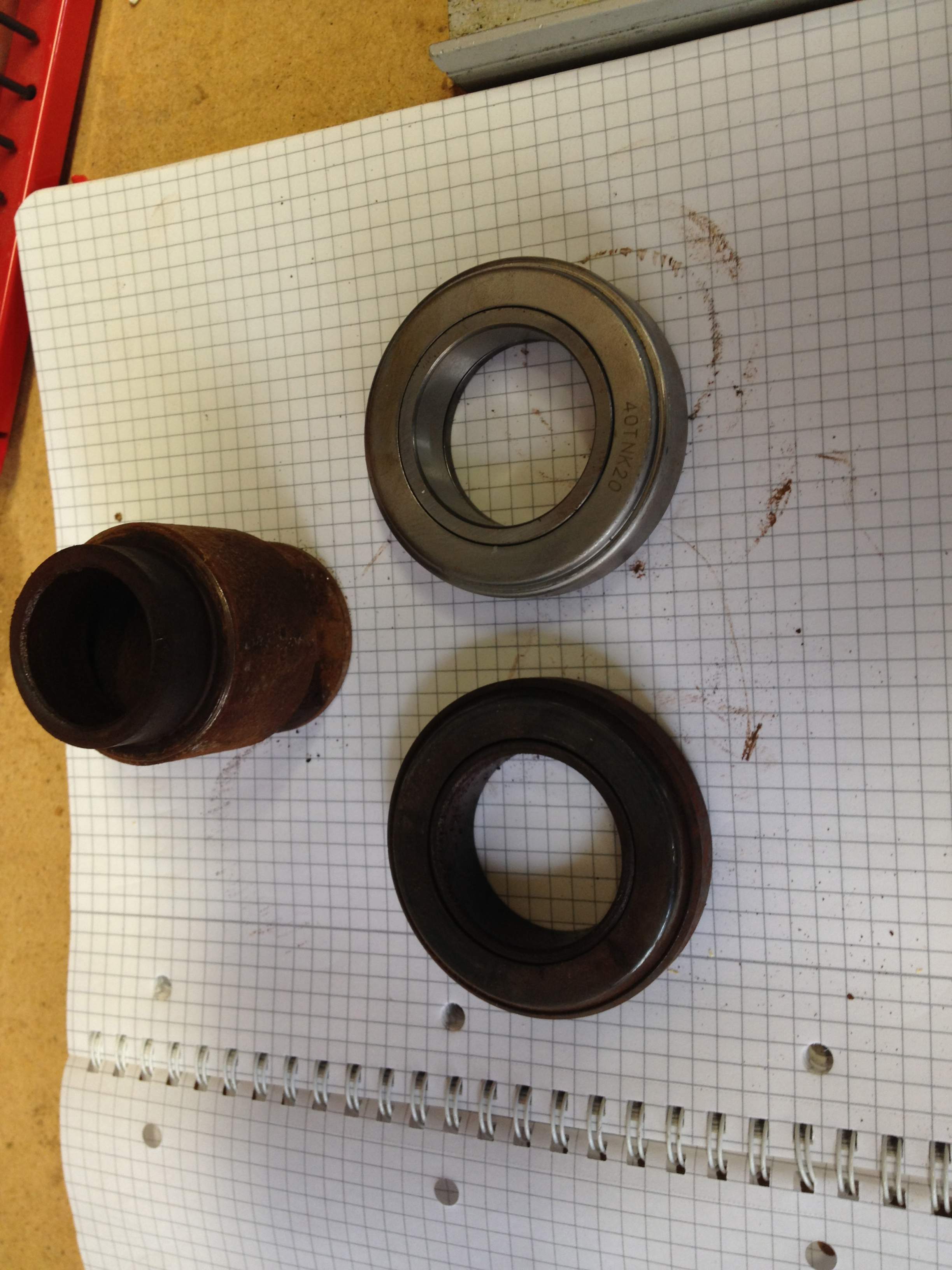

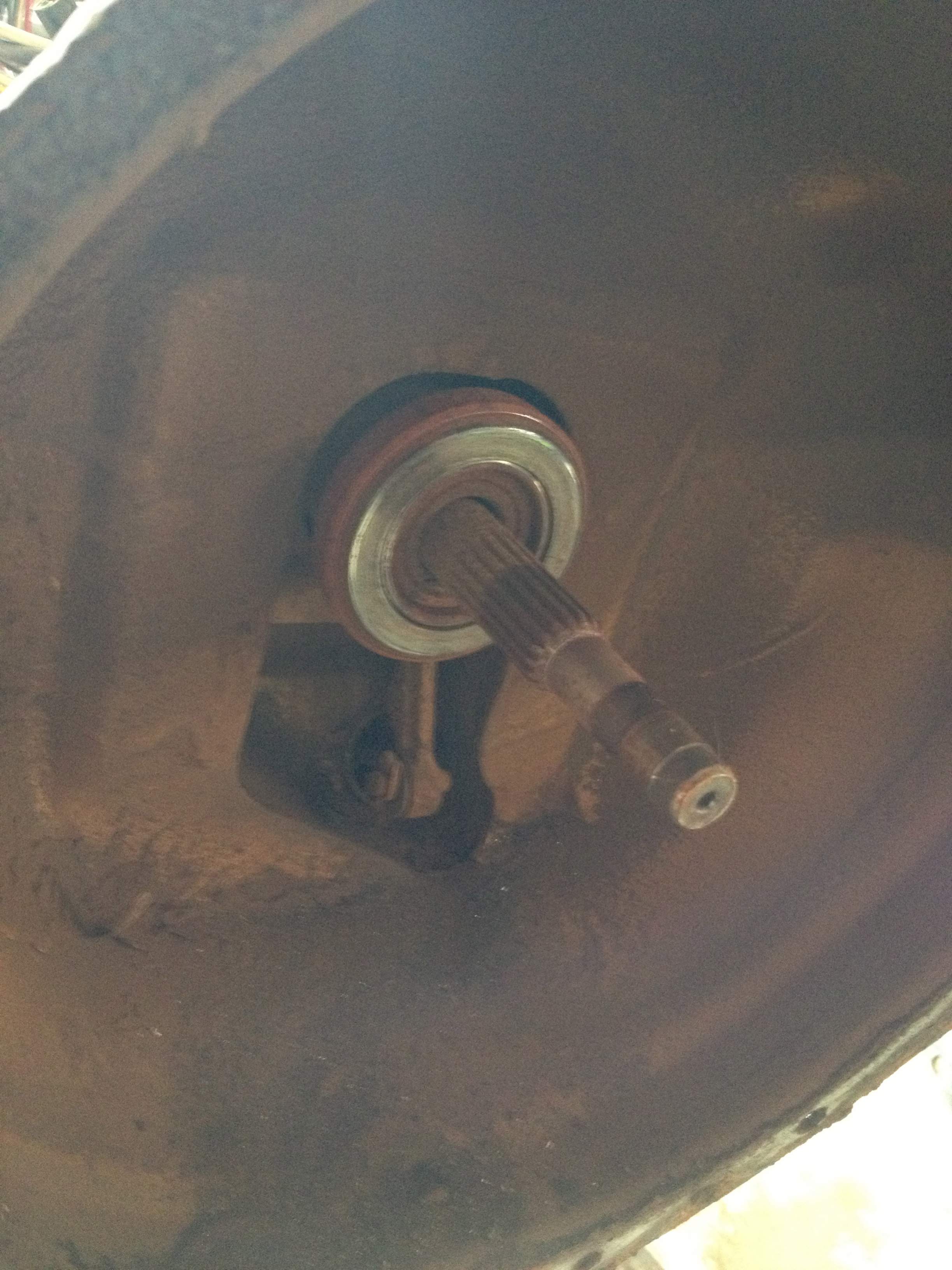

Inside, the release bearing was really stuck. Removed the fork( i had already bought one used on ebay) to get out the sleeve with stuck bearing.

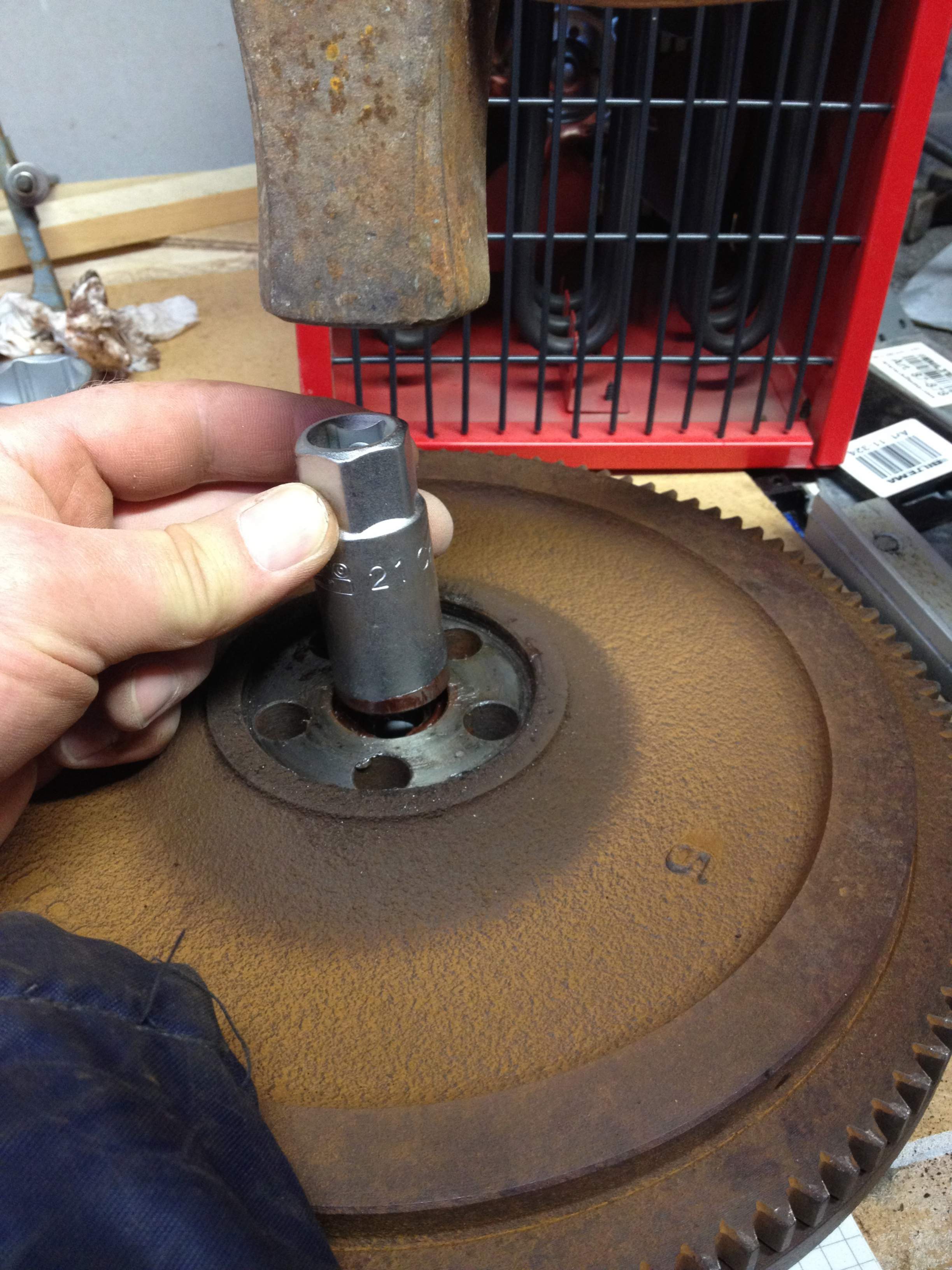

We removed the flywheel, to change the pilot bearing. (have no special tool for ball bearings, so we had to do it the hard way)
see pictures of how we used different sockets to remove and insert ball bearing.

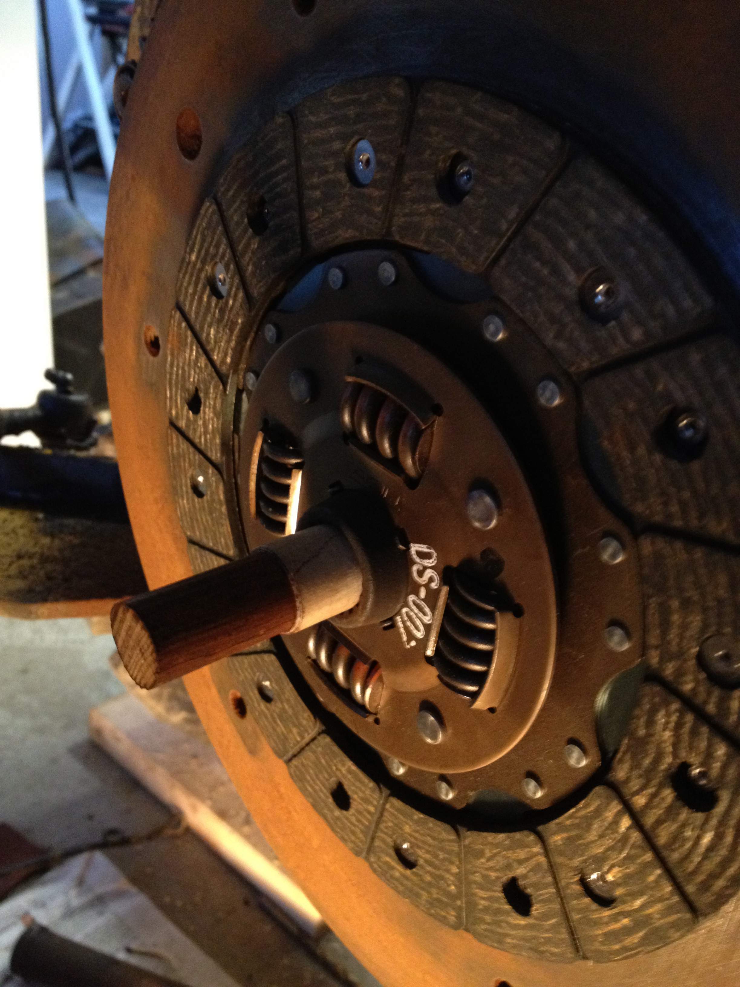

The alignment of the clutch plate.
We used a wooden rod. 15-16 mm diameter. sanded it i little, to fit the inner diameter of the pilot bearing. Then some tape, to center the plate on the rod. worked perfect - picture :)
Be aware of the bolts to fasten the clutch cover, one broke :-(. We got it out, and replaced them all with new.

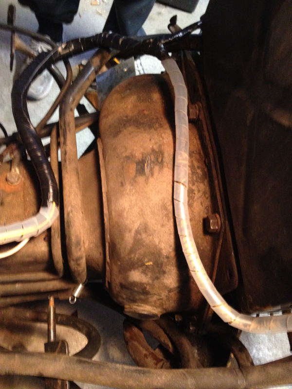

Secured the electrical wires with computercord collectors :)

The only special tool i used. This for disconnecting the balljoint on the steering rod

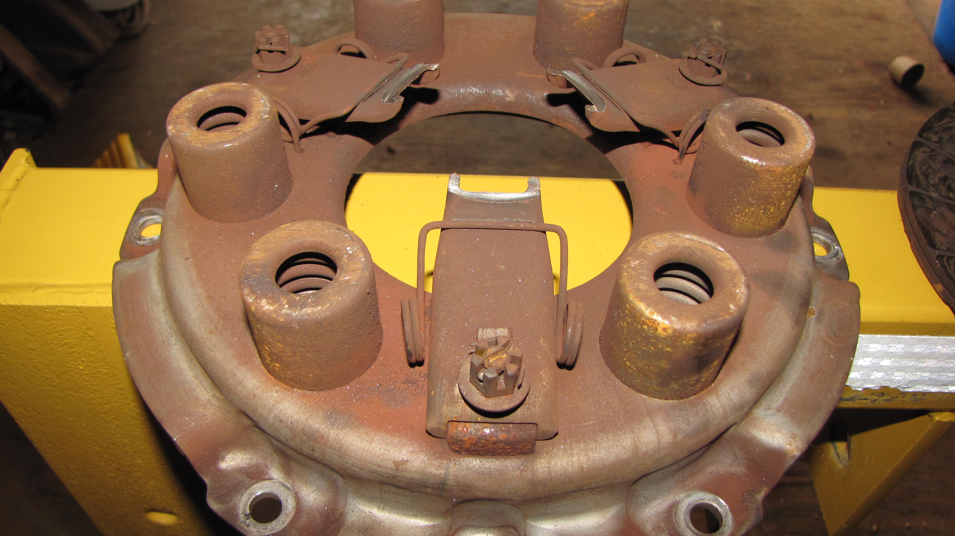

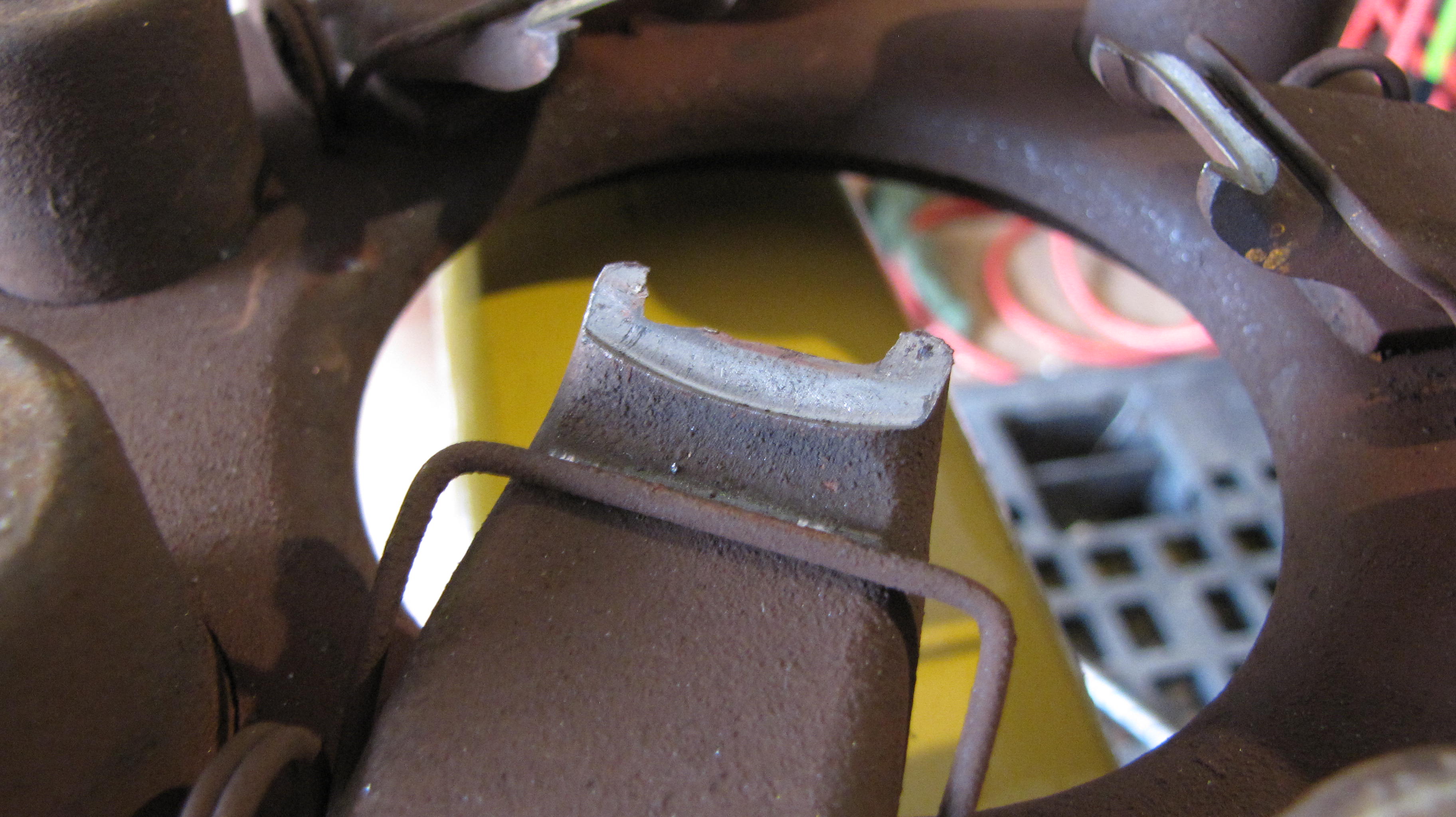

I finally replaced my clutch today! It works great, and it was quite a surprise to see the 30 year old clutch. The fingers were worn down completely. It was no wonder I was having such bad issues. I was worried that I was going to wreck my gears, so I finally bit the bullet, and it done.. It is really nice to be able to shift, and not have the gears grind! It only took me a year to do it! Thanks again, for posting this guide!
This is what was left of my clutch:
   / Iseki TX2140f The ultimate clutch replacement guide #7
Ouch. I heard that happens but haven't seen it yet. How was the throw-out bearing? I'm assuming that must have been bad. If the bearing was good I wouldn't think the fingers would wear down that bad unless the clutch was "rode" a lot.

Hi there Beaver. There wasnt much left of the throw-out bearing. It didnt turn at all. I had ordered the pilot bearing from the states, but it didnt come in time. Fortunately i could get the same ballbearing at a local carpartstore.
