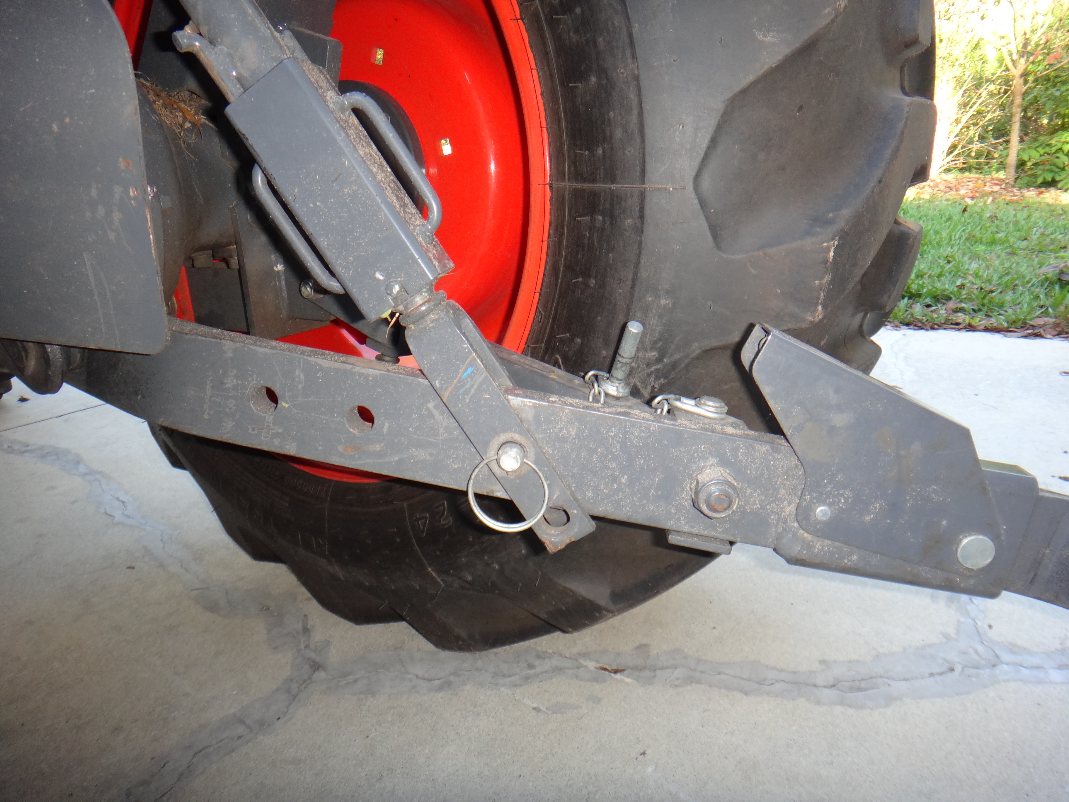

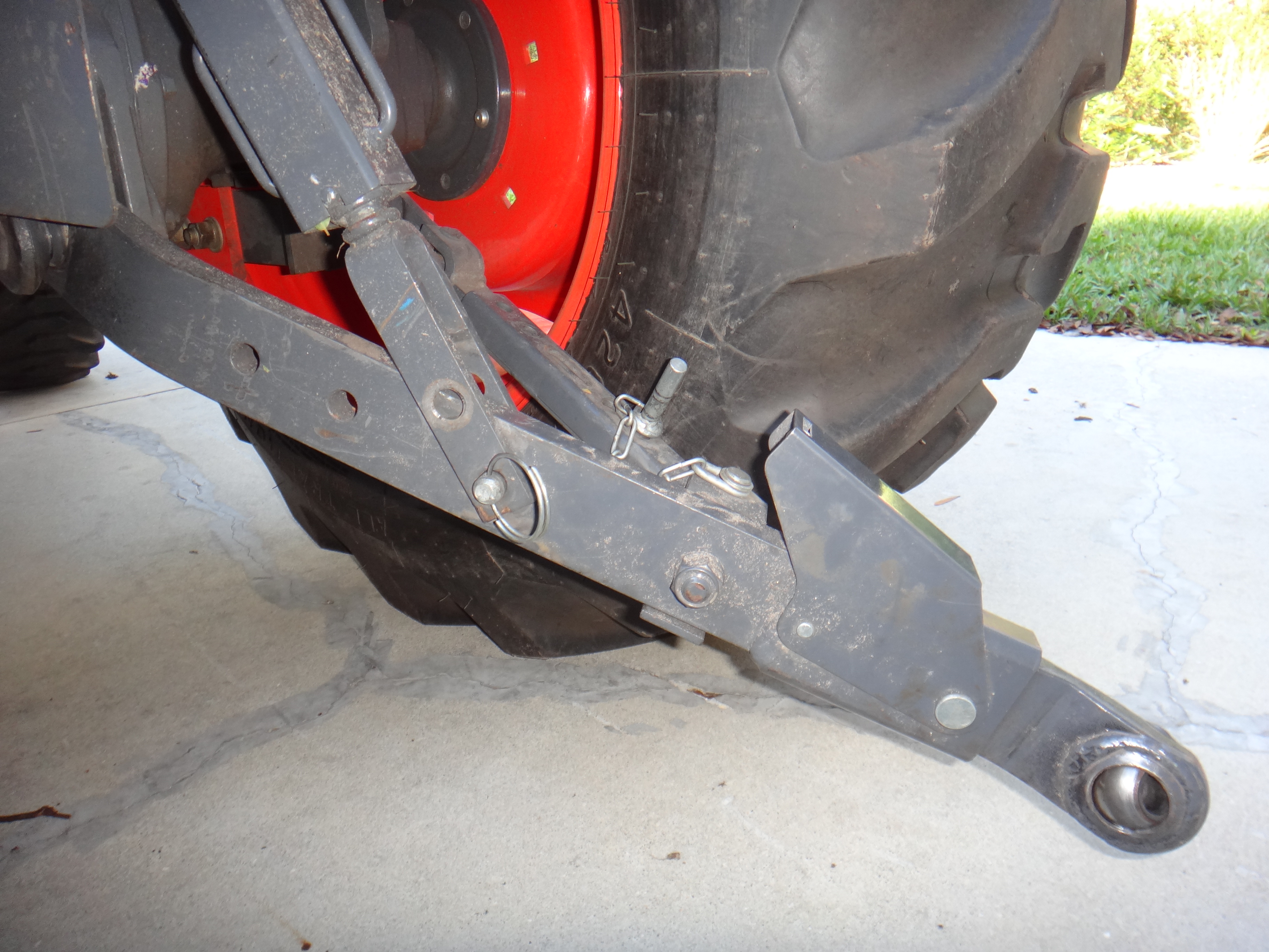

Check to see if Lifting Rod stirrup pins are in the highest adjustment holes. "Higher holes = higher lift."
If the pins are in the lower holes, changing to the higher holes will lift winch about five inches.
You can see in the two photos how much difference this can make.
If your winch is Category 1, Three Point Hitch should NOT require modification, only adjustment. Your TC35 is about as "standard" as tractors come. Norse is a mainline brand winch.
If my suggestion does not cure, see what suggestions others offer.

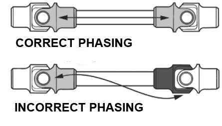

just maybe them-there u-joints have seen better days and time for new?
Are you sure the 2 u-joints on the pto shaft aren't 90 degrees out of phase?

CR: Great thought.

or.....
Hi good thought, i dont think so but i will check. The angle is extremely steep so i dont think that is it. It worked fine on my other tractor.
