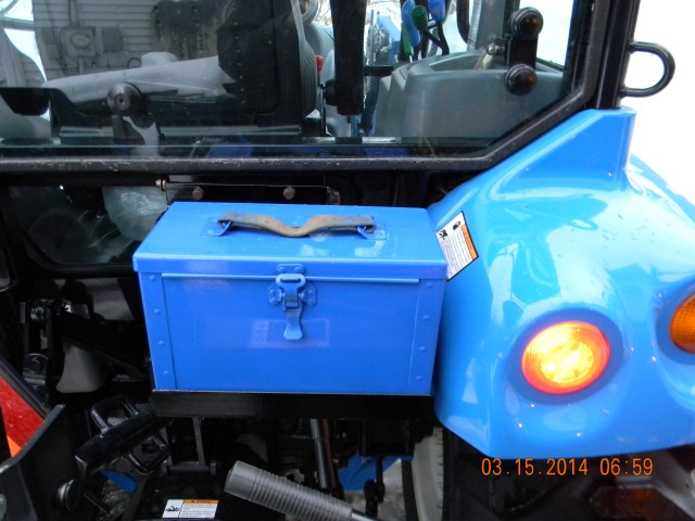

5. best place to mount a tool box?

5) I have the cab model so finding a place to mount a tool box was tough. On the back right side my tractor has two threaded holes. I made a bracket to attach in the holes and mounted a small box there. (see Pic) It just clears my remote ports and have just enough room for the top link arm to clear. Without a cab you could add a bracket to go all the way across the back and mount a box to that. I remember seeing another member did this but couldn't find the link.
