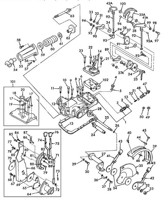

I have a 1982 Ford 4610 tractor with a front end loader. It has a position control lever and a draft control lever. When I have the six foot mower attached, it will not stay where I put it with the position lever. The mower and the lever itself drops. Is there a friction adjustment or is this a hydraulic problem? It just started doing this recently. It has always stayed put in the past. Any ideas are appreciated.

Yes, I keep the draft all the way down. The attached mower and the lever drop like a rock. It lifts fine but just won't stay there. I was sure hoping there was a magic friction adjustment I could tighten up to keep it from falling. As long as I hold the lever in place, the implement stays up. When I take my hand off, it drops. Thanks.

In the illustration below, look at Item #33. It's a nut that can be tightened to increase the friction on your lever. If that does not work, then you may have worn friction discs. They are Item #34 and part number 81717214 from your New Holland dealer. Messicks.com has them for $1.90 each. Some people make their own friction discs out of thin leather, but I'd suggest buying the NH part at such a cheap price. Probably, you won't need it, just adjust the nut a half turn and you'll be back to normal.
   / It Won't Stay Up #7
I had the same problem with a walking position control lever. It was worn out friction pads on the lever. Replaced the friction pads, now lever stays put .
