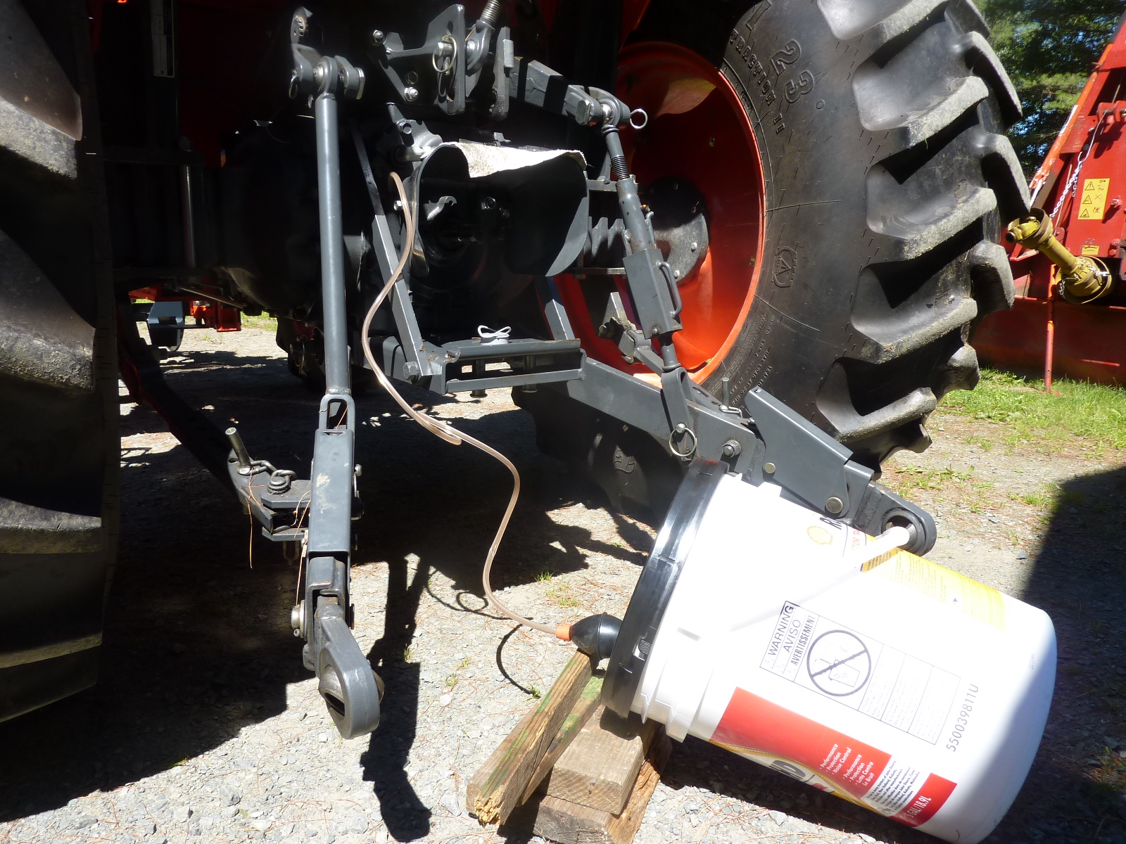

Did a transmission oil/filter change on a new to me M5640 (gear transmission) today. So the first time and a learning experience. No sight window just a iddy-biddy dipstick. Manual says 10.5 gallons (I realize this is for a dry transmission). I put in about 9.5. Over filled by about 2". Above the little stick and up into the stick retension/sealing gasket area. It would be so nice to have a plug at the fill line of the transmission or a least a reasonable oil/filter change gallon requirement number in the manual. The dry fill number is useless.
I guess I dribble some out of the main drain on the bottom and hope I can control the flow unless someone knows a better way which would be good.

I keep a few of these around for overfills:
Amazon.com: Air Power America 5:cool: Topsider Multi-Purpose Fluid Removing System: Automotive
It lets you suck extra oil out through the dipstick opening.
It's a bit pricey but has many uses. There are cheaper plastic models out there but this one is made of metal and will last. I picked one up on eBay last year for $10.

I got a $5 squeeze bulb syphon pump with a skinny hose I could stick down the dip stick hole about 3". It was slow but it syphoned to the bottom of the dip stick. From there I added 3/4 of a Quart to the full line. Now I see why I missed it. 3/4 Quart dip stick range isn't much when you are playing with 10 Gallons.
Thanks for the idea bdhsfz6
