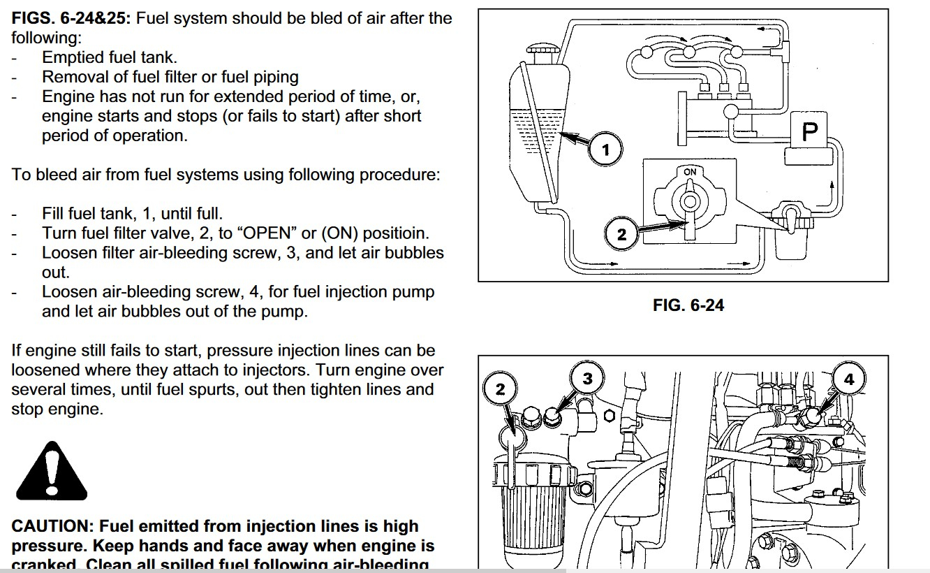

While running my newly purchased izeki tu1700 the tractor slowly started to loss power and died. It was like it just ran out of diesel but there is still plenty of fuel in the tractor. I have only owned this tractor for about a week and it ran great up to this point. Where should i start in trying to repair it? It is currently in the field and not sure i have a way to get it to a repair shop if i cant get it running and lift the front loader. Thank you for any help you can offer.
   / izeki tu1700 slowly died #2
Check the fuel filter to see if it's clogged.
Any more advice you'll need to wait for someone else to chime in.
Thx for the reply, I'll give that a check and report back either good or bad news. I found the following diagram online. I'll take all the help i can get.
   / izeki tu1700 slowly died #4
Fuel/air troubleshooting is essential, these are just airpumps that just goes suck-squeeze-bang ;)
OK this is a little embarrassing but i found the problem and it was the linkage. The linkage has a turn buckle on it and it rattled loose.... Screwed is back on and the tractor started right up. Sucks to be so green at something. Thx for the help, i am sure there is another event in my near future.
