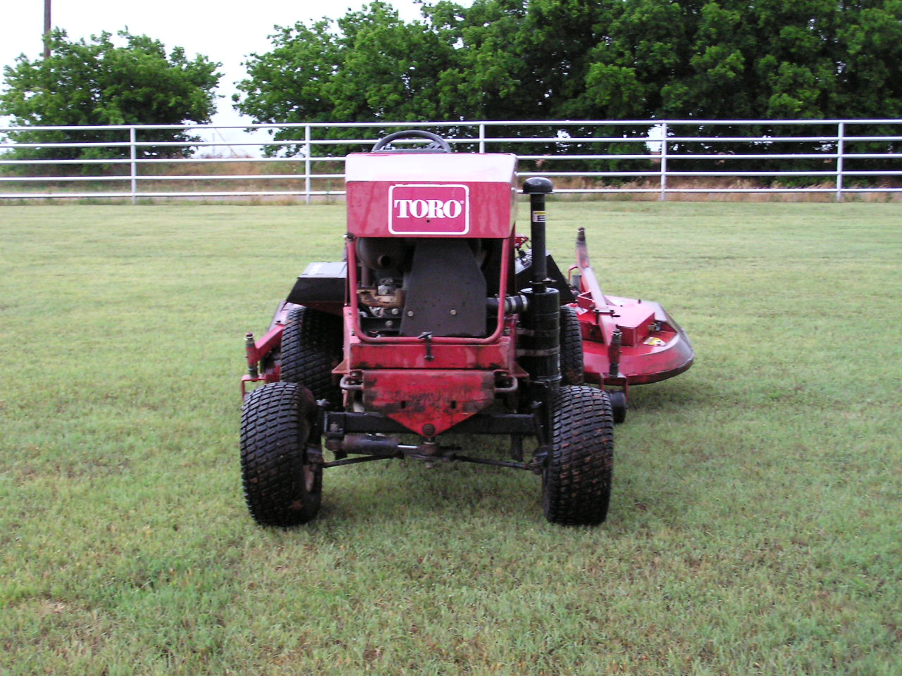

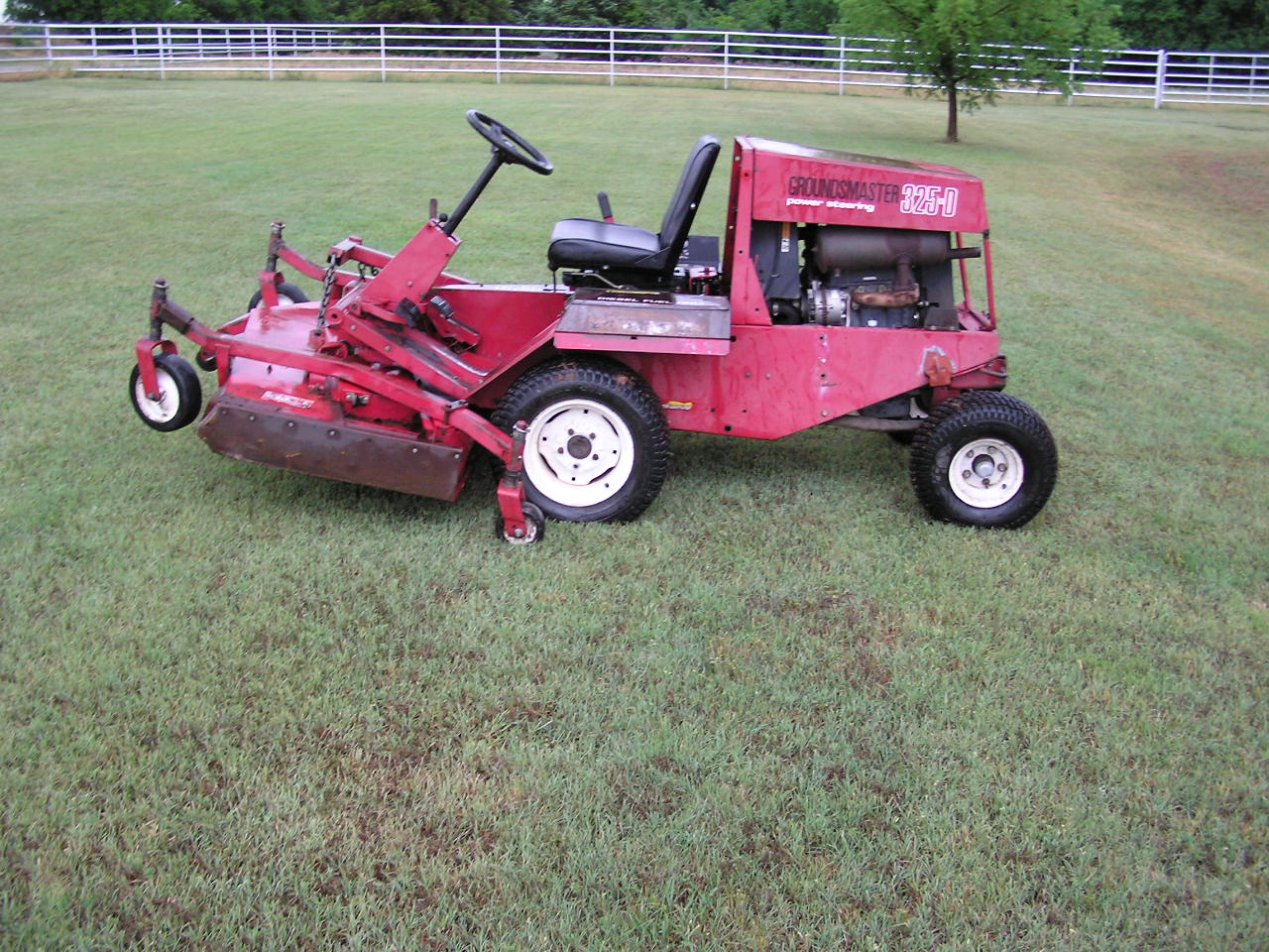

Looks good, I know you will like mowing with it since it is designed like my TORO, and like the Kubota F series.
Can't help with the PTO, but next time it starts to die, remove the fuel cap. If it picks up and runs, the fuel tank vent is plugged.
