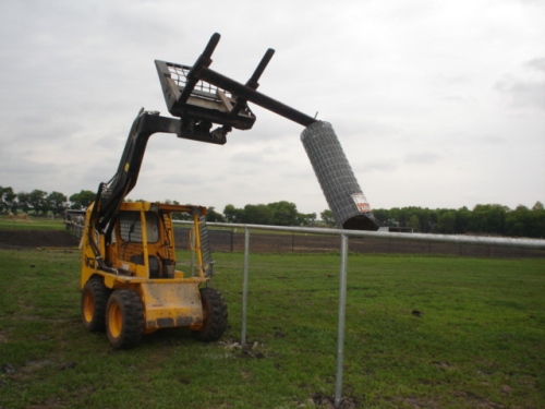

I have a 165HF that I've got about thirteen hundred hours work out of.
I love it.
I've had no problems with the motor or drives.
Yesterday I put a six foot Bobcat tooth bucket on it and dug a hole shaped like a swimming pool about six feet deep fifteen feet wide and twenty five feet long. This is in clay.
Keep in mind the six foot bucket is a foot larger than the stock one and I'm a little over the fifteen hundred pound capacity of the machine when full.
I have Case (hand) controls and wouldn't have it any other way.
If you click on the "life is good" you will find lots of pictures of the tractor in use. I've made and modified lots of attachments for it.
I'm wanting to supplement it this year. I want a JCB 1110T but I'll keep my trusty 165 named "Iris".
