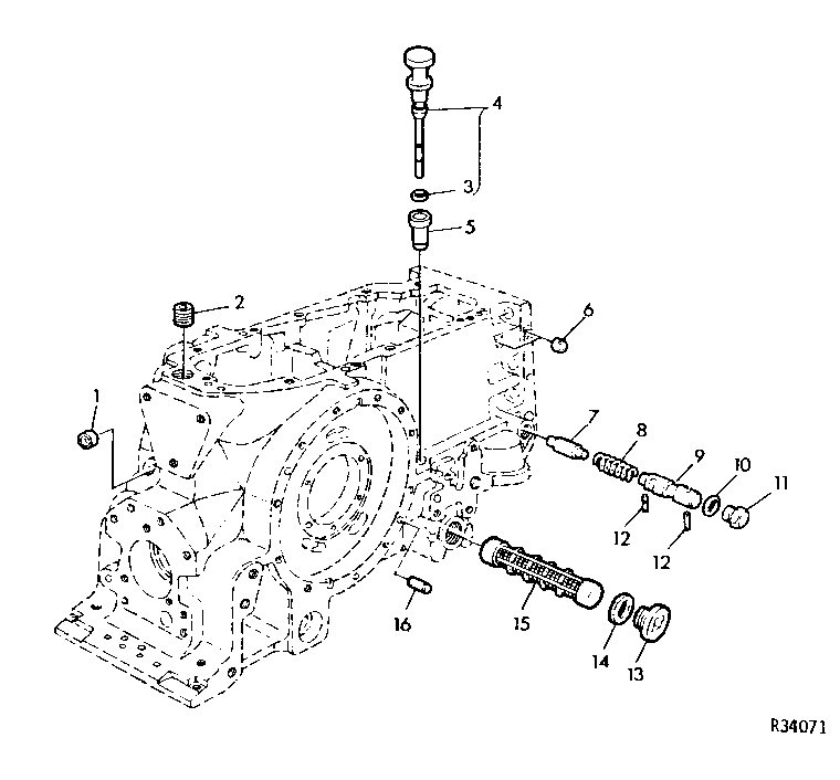

Although it's fine to check filter in frt hyd pump I've rarely seen it be stopped up. I suggest you check hyd filter relief valve(parts key 7 & 9) to be sure it's not stuck partially open. Screen is parts key 15 in my photo which isn't for a 1020 but still same location on all JD utility tractors of the same design.

After draining the trans Fluid I went to take the HYD Filter relief valve out and took the cover out then could not get the valve out. t tried needle nose pliers and a phillips screw driver. any tricks to getting it out. I was going to try and strike with a flat screw driver to see it I could loosen it. The fluid was really clean and the sump screen was spotless so I think the stuck relief valve might be the problem. I drained it thru the sump screen filter hole and took filter off. I got about 6 gallons out, should I open the drain plug on bottom to get the rest?? my serial number is 052884T made in 67 in Dubuque Ia. Thanks for all your help

Thanks for all the help from everyone. I found the relief valve was stuck. I had to drill it and put a screw in it then grab it and pull it out. Ordered a New one (it helps I am 3 miles from the Milan warehouse) had it the next day. Installed it and fully drained the rest of the fluid and changed filters. Refilled it and it works great. Love the older tractors I use it to pull a 72" mower and drag my drive. Once again thanks
