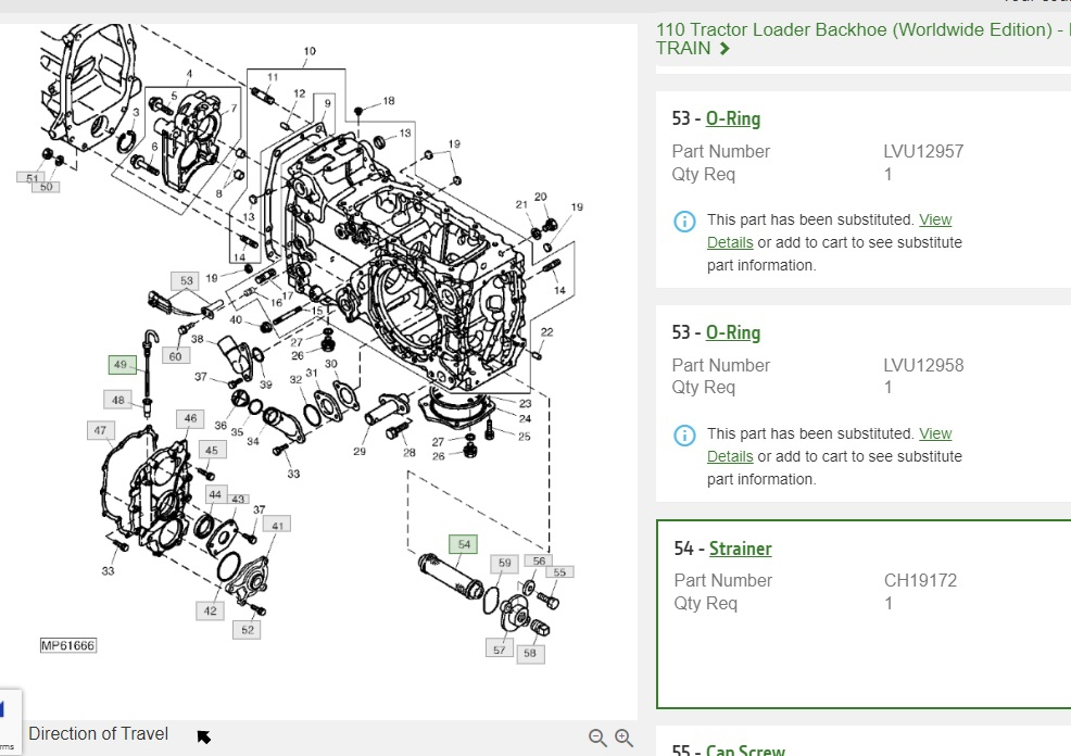

JD 110 slows down after warm up, as in slow forward speed when adding power.
   / JD 110 Backhoe #2
Transmission type? HST or gear?
History of hyd. oil change is what?
When last changed, was the strainer also cleaned?
What hyd. oil being used in the tranny?
   / JD 110 Backhoe
HST tranny
Not sure when last changed, mostly has been sitting.
Where is the strainer you asked about? Found the 2 filters.
   / JD 110 Backhoe #4
Here is a schematic from the JD parts site
It is a fine screen that may be clogged and never changed. I'd consider a tranny oil change to help or at least establish that it isn't the problem.
key# 54

Thanks That's a big help.
