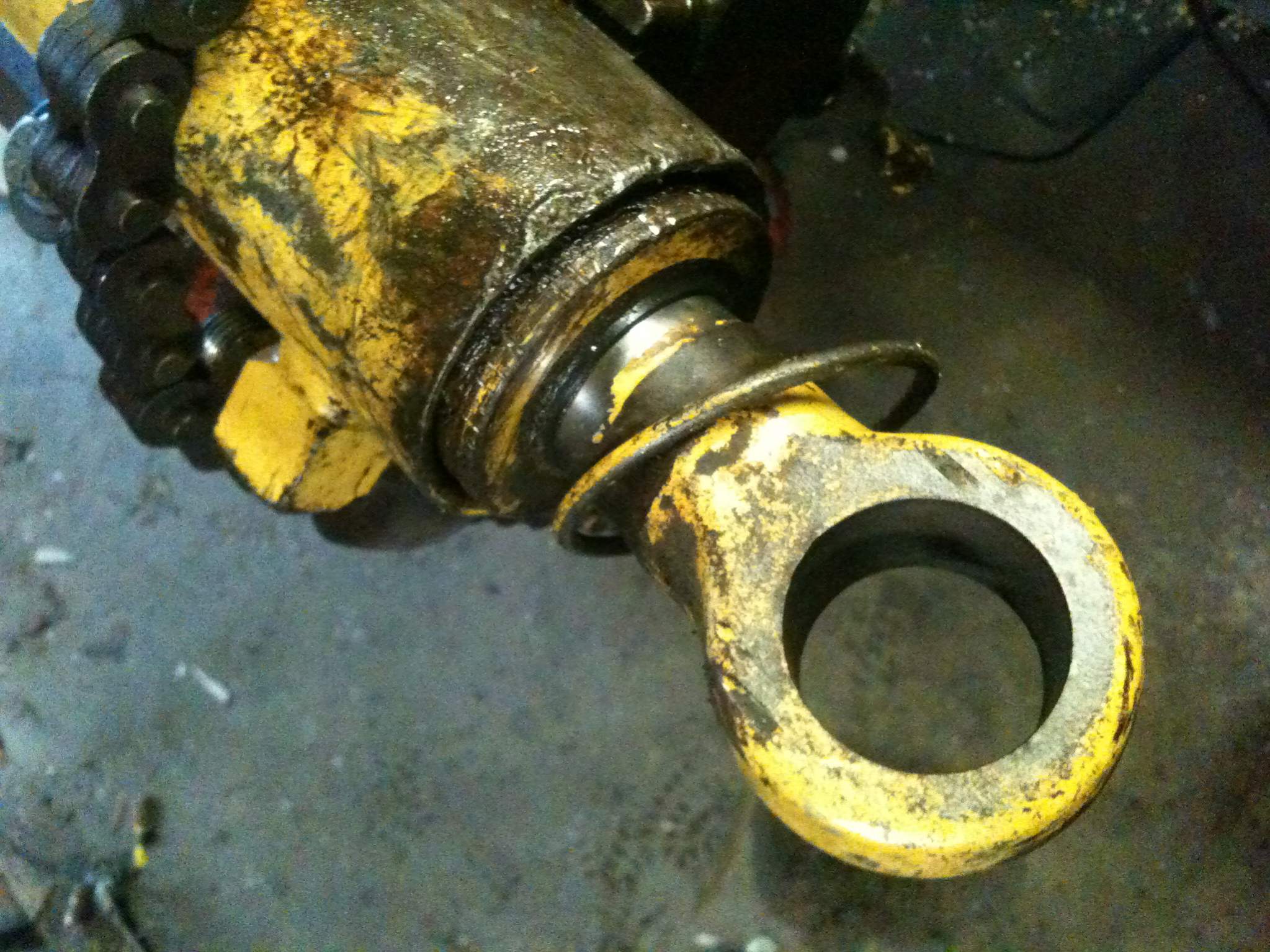

Curious if anyone has any experience disassembling an outrigger cylinder on a 110 TLB. I removed the ring in the picture and can push the gland in far enough to see a second groove, but cannot pull it out. Is there a second internal ring that needs to be compressed? Thanks.

Your rebuild kit has an orange plastic ring in it that you insert into that groove that you can see when you push the gland back into the cyl. This plastic ring allows the internal snapring on the gland to ride over the groove and slide out instead of snapping into it.
   / JD 110 TLB Outrigger Cylinder Disassembly Question
Thanks for the reply. That makes sense. Now if I just had the rebuild kit, I'd be in business.

I was thinking the same thing. Talk about locking you in. I'm replacing the rod and can't even get it out without buying their kit first. I'll make a plastic ring and get it apart first. Then I can get the seals.
