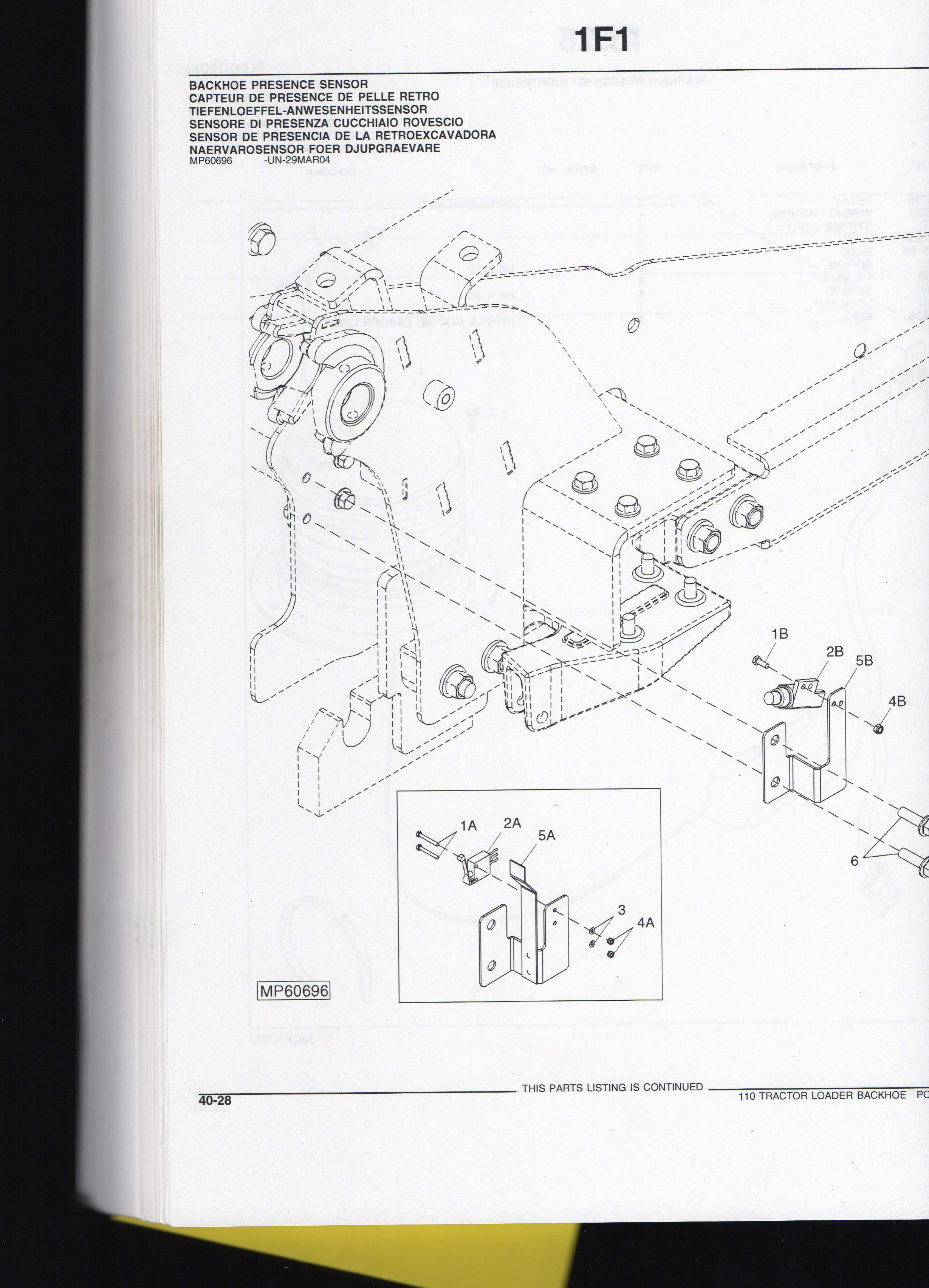

I have removed the backhoe to check on the 3 point hitch. The rockshaft does not do anything. No lift, no wiggle, no pressure, nothing. It feels like there isn't any oil in the lift cylinder. I can lift it by hand and it simply drops with no resistance at all.
Is there a sequence of checks I can do to eliminate potential issues as to why this is the case?
I have followed the factory manual as far as checking oil, on level ground, in neutral, high idle. Maybe I could check an electrical connection/switch, etc?

I haven't seen this on the 110 but have heard there might be a switch that the backhoe frame contacts when it is installed. You might want to look around the lower hitch points to see if one is there and see if it is stuck. I don't see the need for a switch since the 3ph is disconnected when the backhoe is hooked up but it is worth a look.
I would have someone operate the rockshaft lever and make sure it is turning the shaft feeding into the rockshaft housing first. This can be done with the engine off. My backhoe and cab are mounted right now so I can't see much to offer additional help.

There is a backhoe presence switch that I believe will prevent the hitch arms from raising. If I recall it is on the right hand side, but I will have to check on that. If the backhoe has not been off for a while, the switch could be stuck in the 'backhoe installed' position. Let me know if you need more info. good luck.

Disney - a few more specifics on where this switch might be located? As far as I know the machine had NEVER had the backhoe off of it. That would be a great thing to check -

Sorry the scan is not the best, but here is a page from the parts book. If you can not see it on your machine, let me know and I will try to get an actual picture, but I believe it is not a large switch, and therefore could be easy to 'miss'. good luck !
   / JD 110 TLB Paint color and Rockshaft -
The scan is fine - now I know what I am looking for. I'll check on it first thing in the morning. Thanks - Chris
