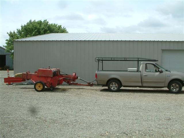

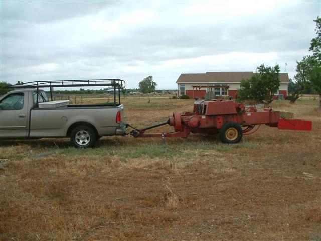

My Massey Ferguson 124 baler is about the size of a 14T. I towed it home about 35 miles behind my F150 after buying it a few years ago.
Use the back roads and kept the speed below 25mph. No problems. Just be sure the tires and wheel bearings are good.
I've seen guys towing similar balers down I5 at 45-50 mph (not recommended).
One of my neighbors towed his baler, an NH 500, about 300 miles up I5 behind his Ford minivan after buying it (again not recommended).
