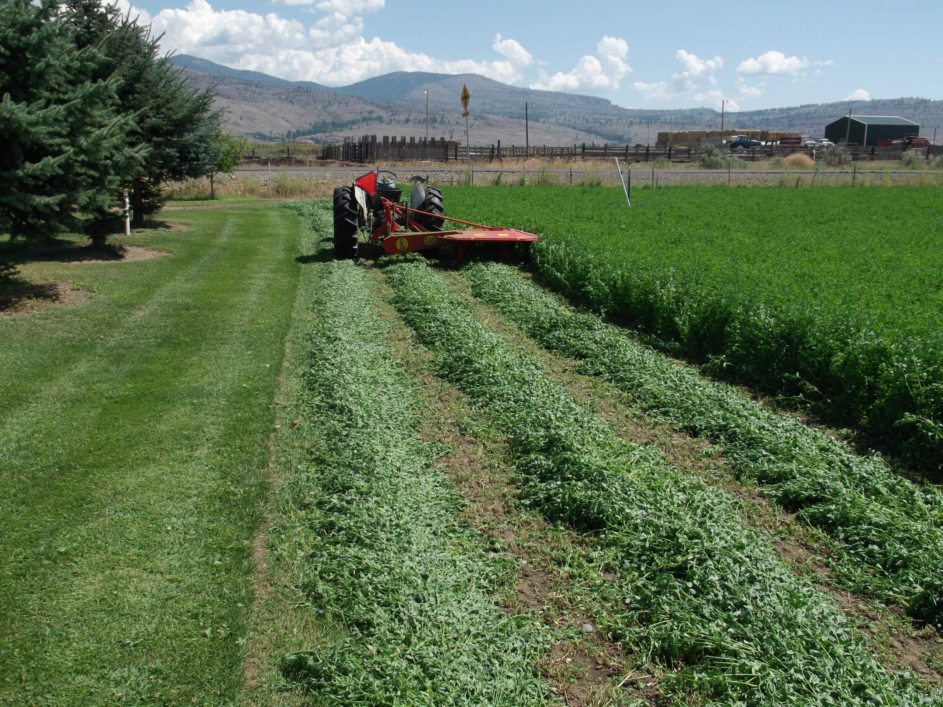

I had trouble getting my non crimped alfalfa to dry.... Then I bought a drum mower that cuts a 4 foot swath... thin swaths dry faster than thick... my dry time now is 4 days or less.... I do wish I had a crimper....
