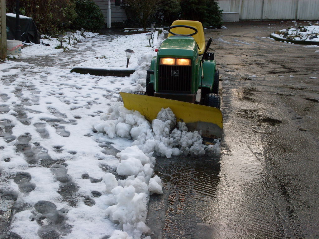

Thank you very much for your assistance. I took the carburator off my engine and re-built it. I then removed the one off the tractor, cleaned up the whole area and replaced the fuel line. It fired up immediately and ran like a brand new engine.
I can't wait to re-build the old engine so I have a good spare.
Again, thank you for your advice. It paid off. I actually got to plow my driveway so that I'm ready for the big snow event tomorrow and Wednesday.:thumbsup:
   / JD 165 Won't Start
#15
Was actually able to plow my driveway today. Waiting for the large snow storm to hit so that I can put it to work. We usually get 1" to 4" of snow, and they are predicting 6" to 14". Just hope it doesn't turn to rain so quick so that I can enjoy plowing again!
