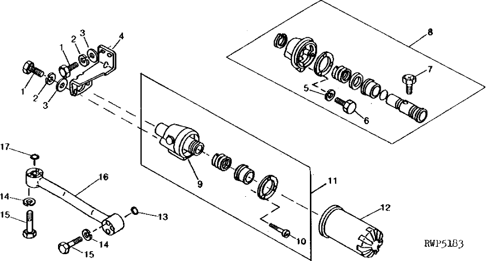

I think you need to acquire a JD tech manual of which I have not. I'll guess that it's possible that parts keys #35 & 36 have failed.

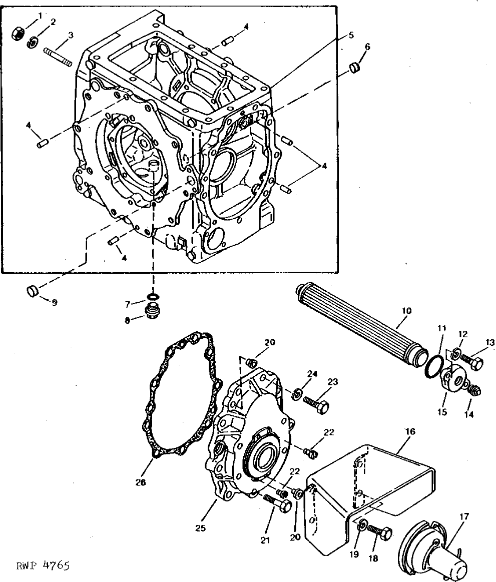

I'd start with the basics first.
Check hydraulic oil level/condition
Change the hydraulic filter Key 12
Clean or replace the suction filter/screen key 10

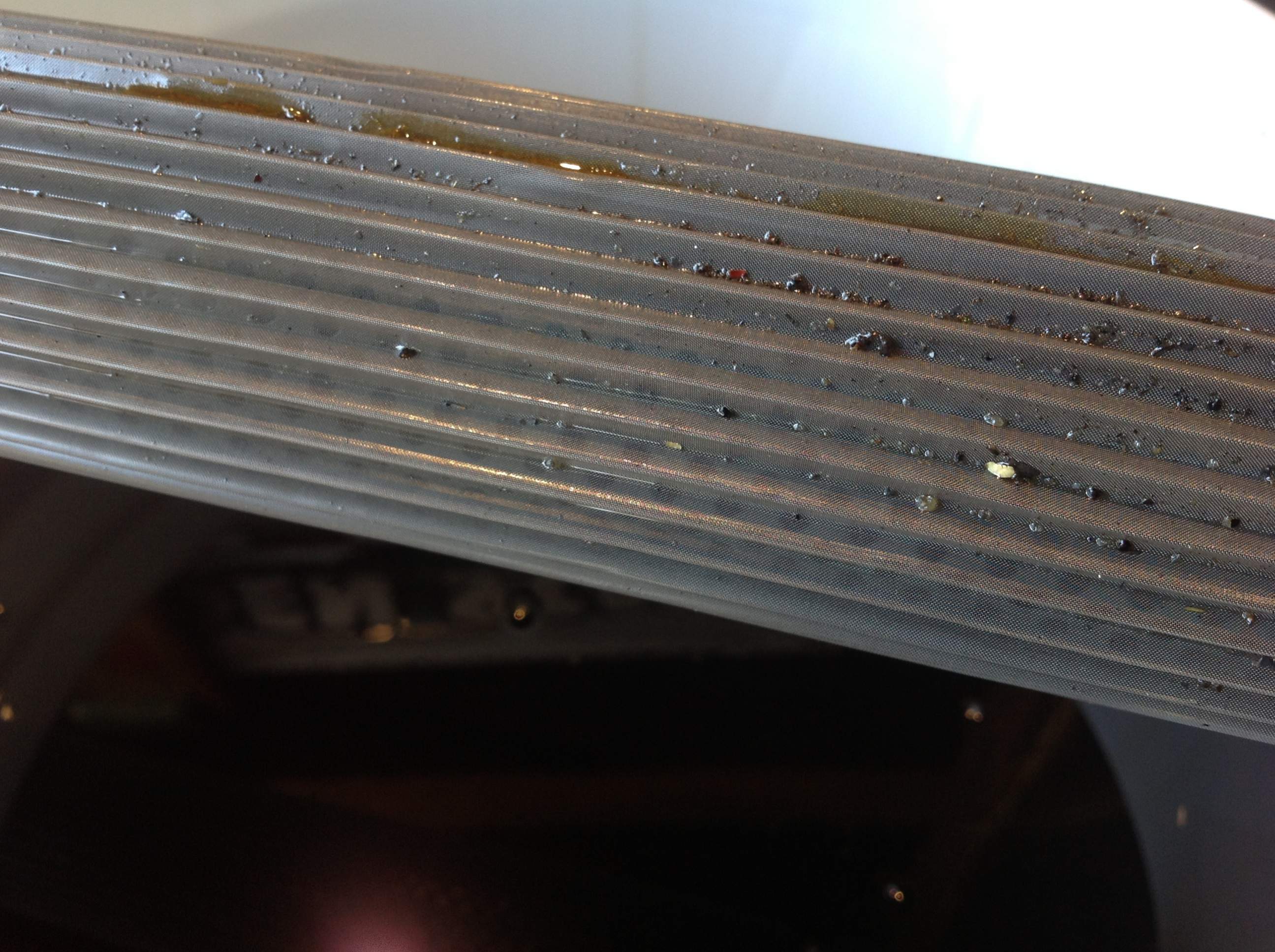

The hydraulic oil level was fine. I drained the oil and removed the filter screen in the rear. The oil was very dark and full of very fine dirt particles. there's quite a bit of small silver metallic pieces stuck to the screen. There's a few gold/brass ones. You can see the color of the old oil and filter screen in the picture below. I'm trying to locate a tech manual now.

So, I cut apart the old filter and inspected the fiberglass element. It was 100% restricted with fine particulate matter. I got a new JD filter from the dealer (finally) and refilled with fresh Hy-Gard. I was all ready to start taking the steering gear out. I started it up and let the new oil circulate, and the steering worked great! Who would of thought? No more leakage around the rockshaft arms either. I'm going to change the filter again after running it a little. I'm sure there's more dirt in there that didn't come out when I drained it.
