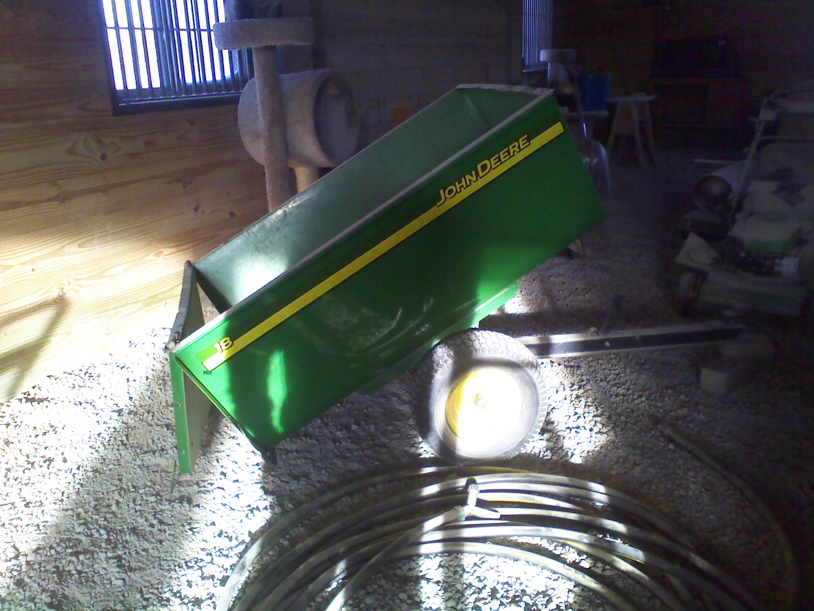

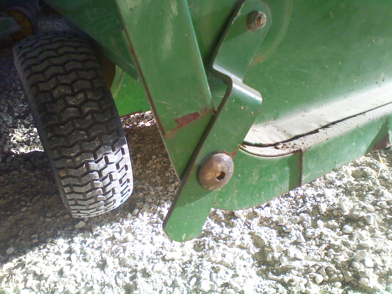

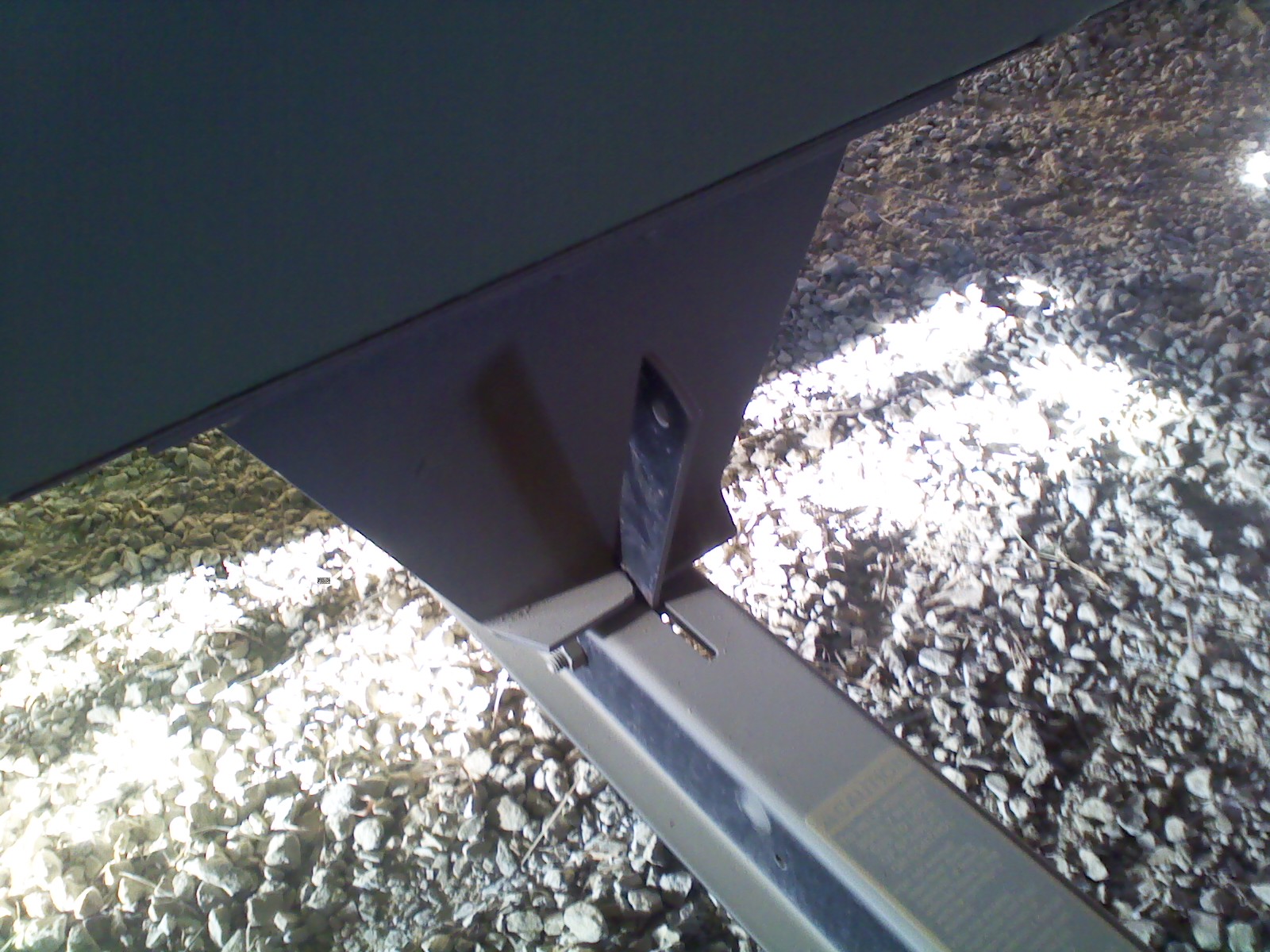

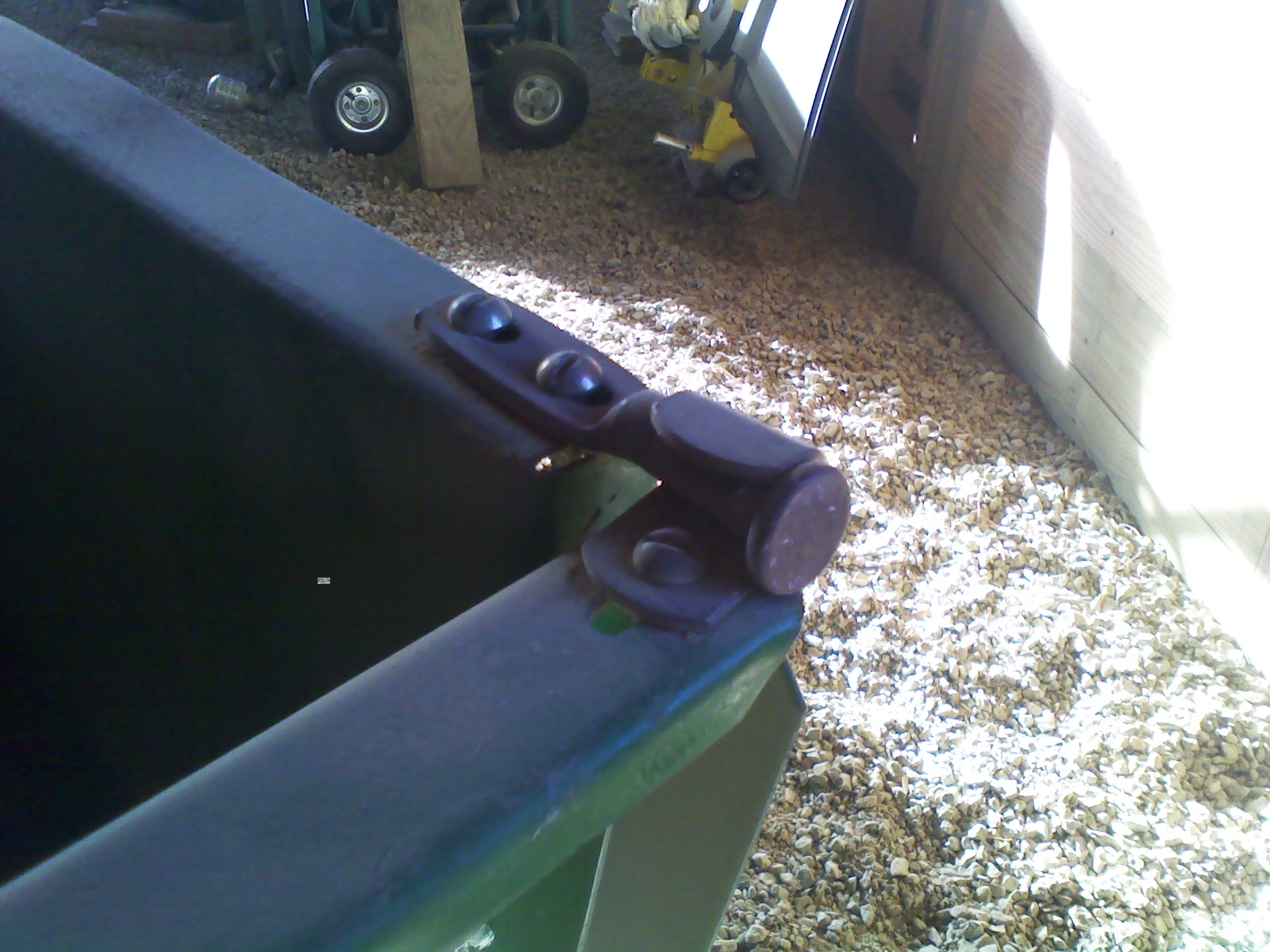

Hopefully these show you the basics.

Thanks, those are exactly what I needed!

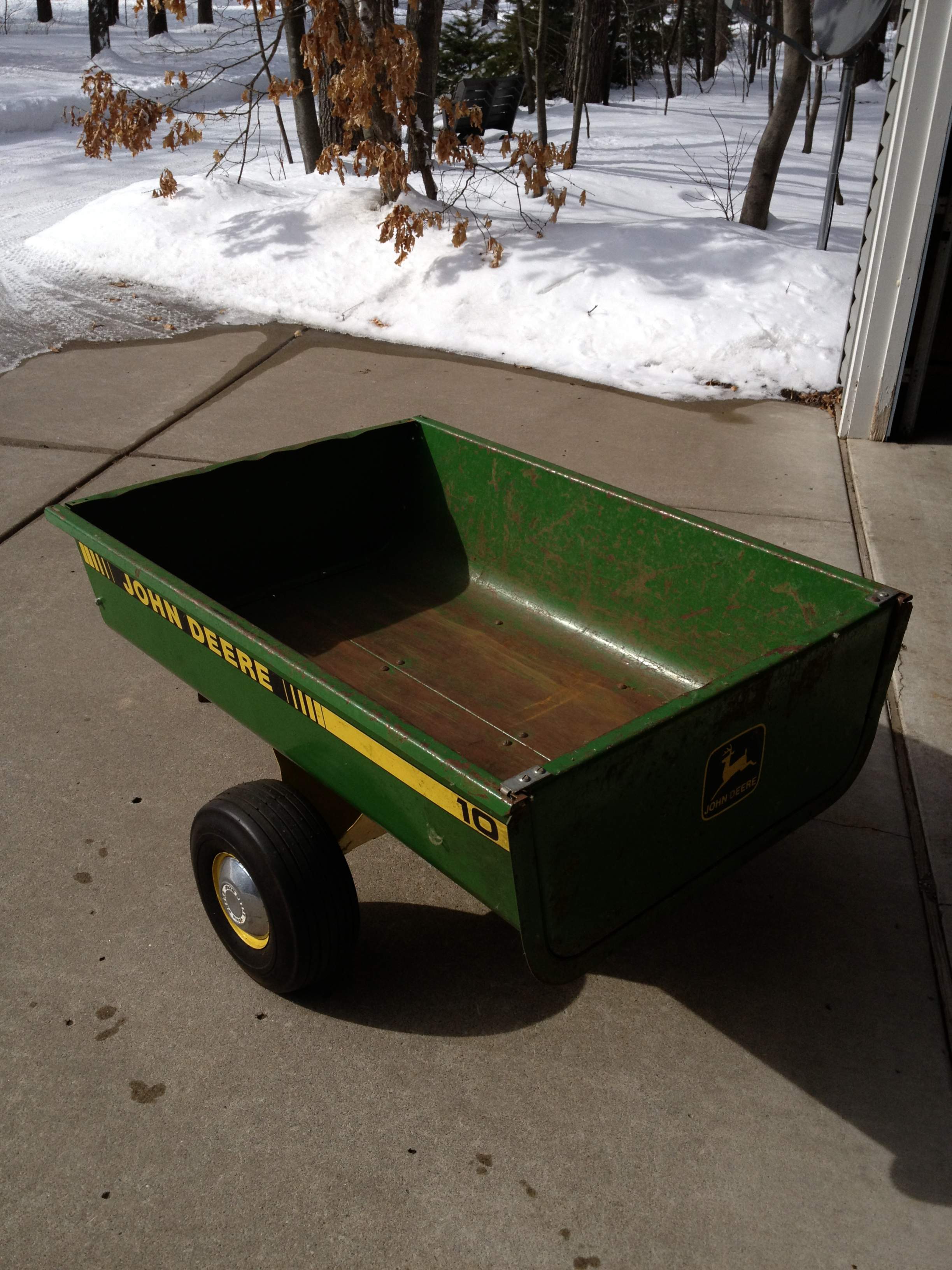

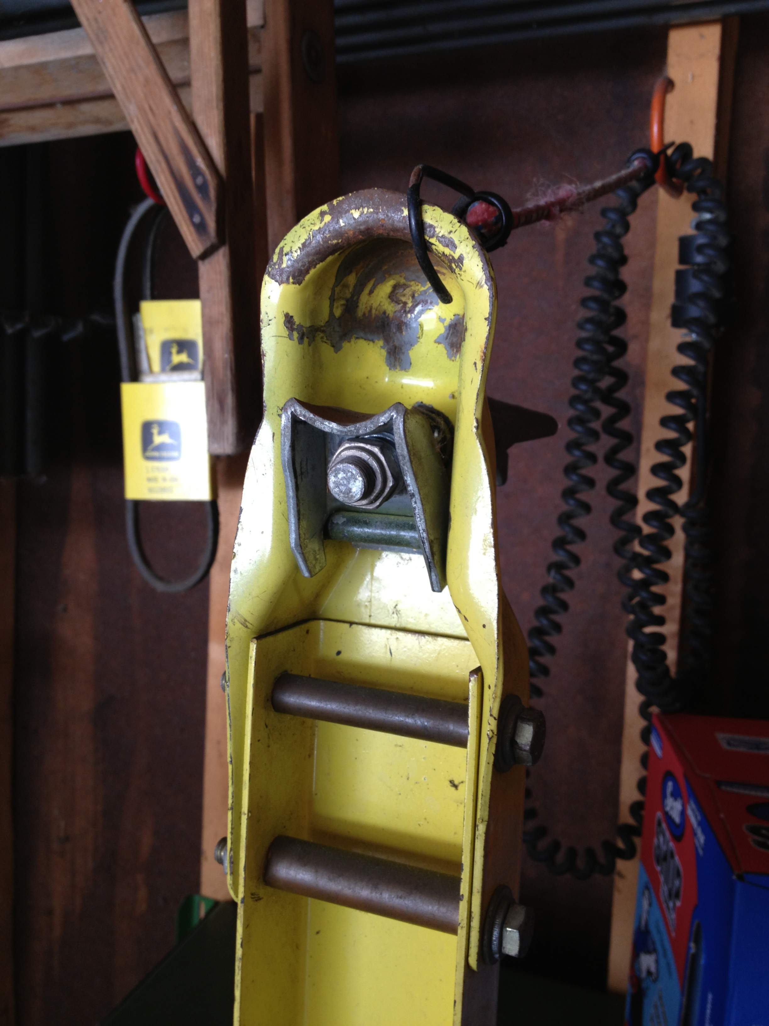

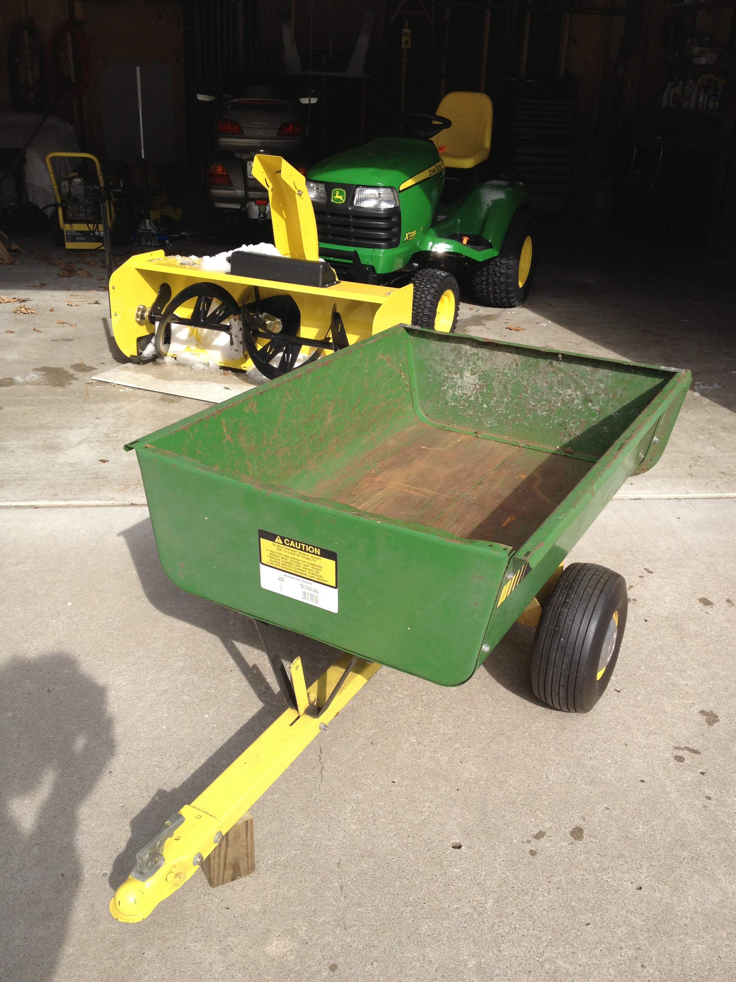

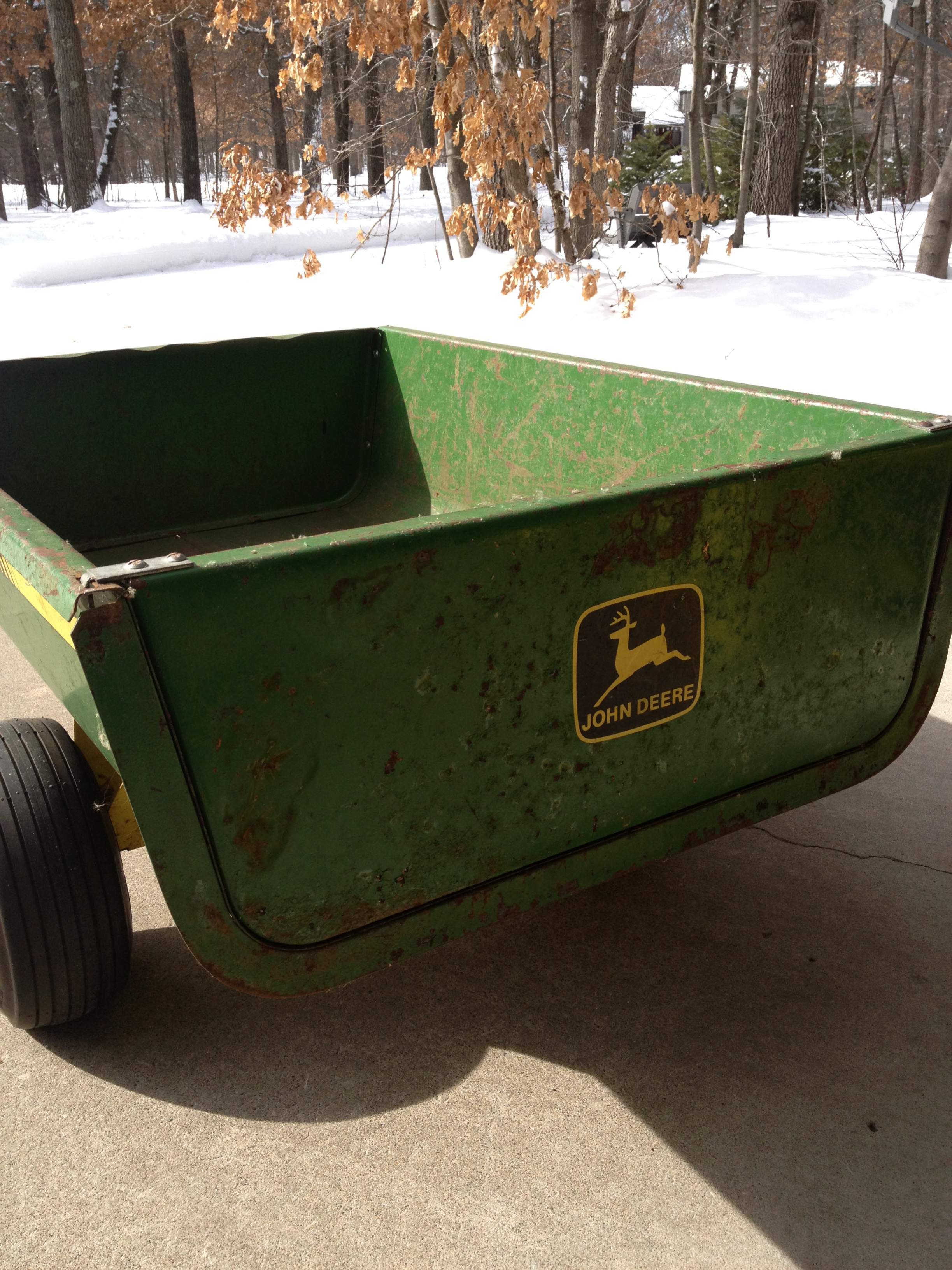

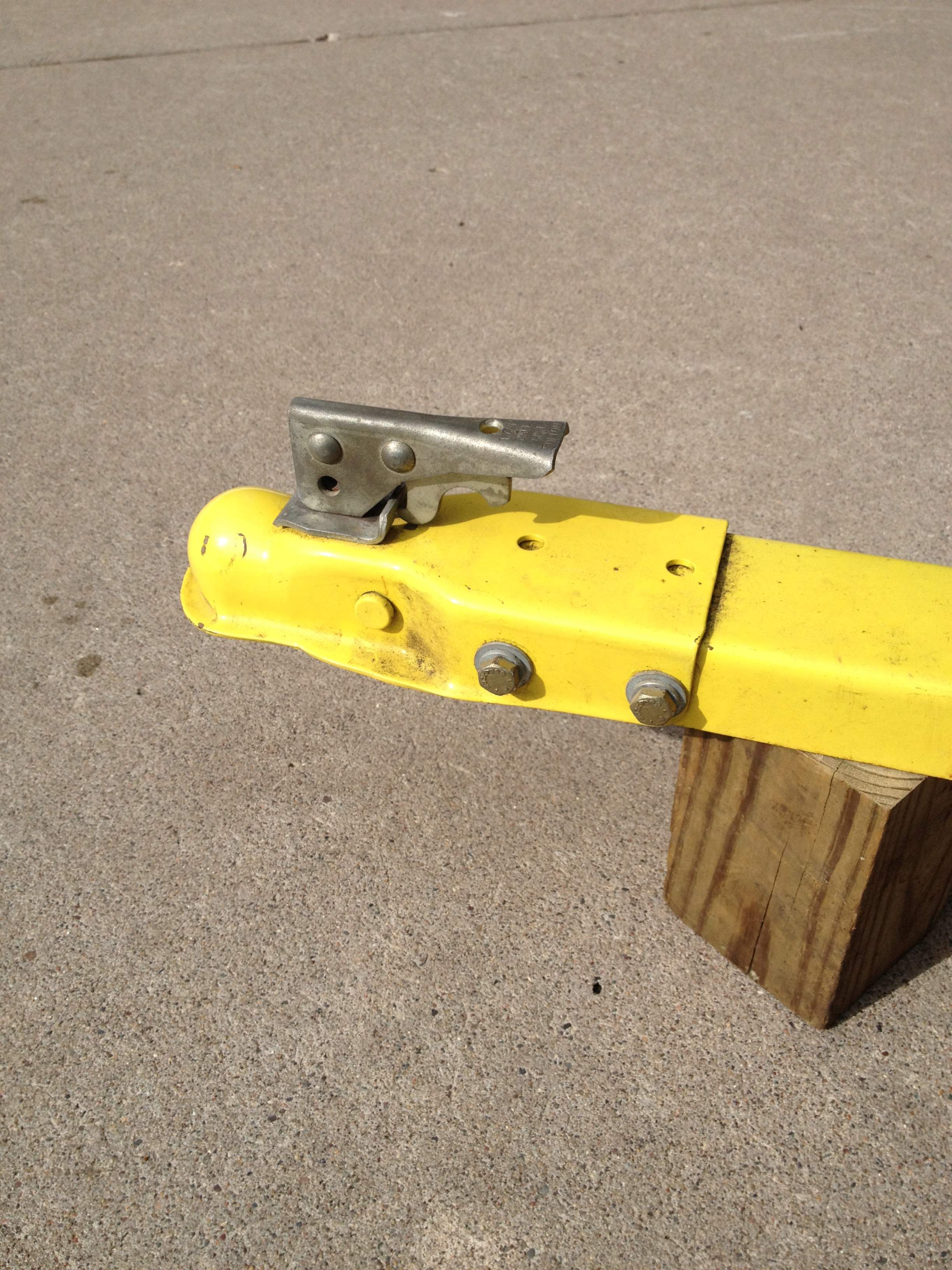

as you can see, this is one tool i have not babied. it has hauled a lot of rock, dirt, logs and concrete. they don't stay new for very long.
anyway, i cut off a couple inches on the front of the tongue and bolted on the hitch. i also painted the tongue and under-carriage yellow. the copper pipe spacers are to prevent the tongue from deforming while i tightened the through bolts. the body may be beat up, but the moving parts get frequent service and have never failed me. the tires are original.

Thanks for the pics glgeek. I think the tongue on the newer #18 carts is a bit different, so I am not sure I can do this mod to it. However, my cousin is a welder and works in a fabrication shop, I think I may get him to build me an entirely new tongue for this trailer, as it is the weak point of these carts.
