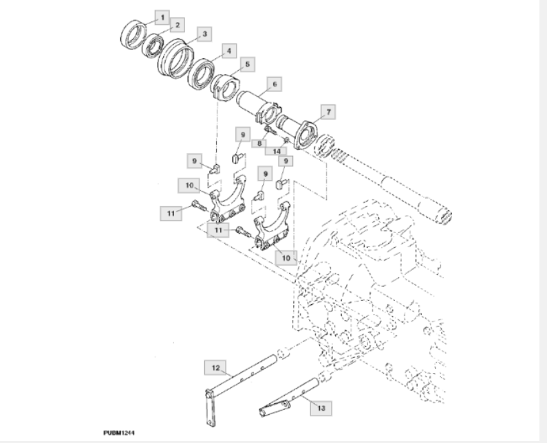

X3 on keeping 2040 instead of purchasing 5303. I'd choose the 2040's dual stage clutch mechanism over the 5303 pto clutch contraption that reminds me of the Famous JD 2010 pto control mechanism. Early model 5000 series JD tractors aren't know for long life traction clutches but 5303 may have longer life traction clutches. Also 2040 won't have the cold start sensor that has a very long history of failure that the 5303 will have.
