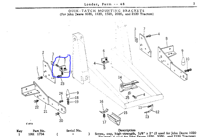

Hello all,
I have a 2030 and I need to unmount the loader. I've searched on line and haven't found any info on the process to remove the loader. I would prefer to avoid the trial and error approach.

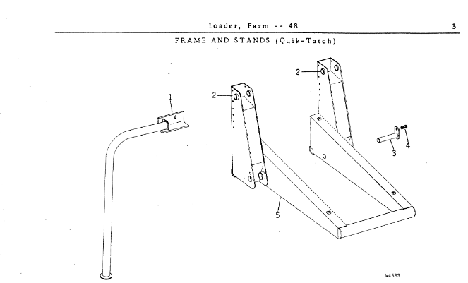

   / JD 2030 with 46 loader - how to unmount the loader #5
Remove the 3 bolts(circled in blue) on each side then raise loader up off of mounting guides(parts key 9) and back tractor out from loader. If you have mounting stands(1st photo) you could use them to support loader
