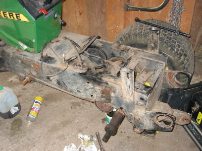

Here are some pictures of my restoration project that has stemmed out of trying to fix this broken axle housing!
This is the original tractor, minus the fender pan and gas tank. Not bad shape for never really being cared for in 20 years!

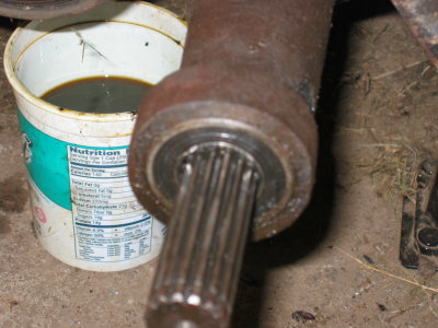

Here is a close up of the rear axle. You can see the fancy "drain pan" I used to drain the transaxle of it's fluid. Sadly, it looked like glitter had been poured in there, which is what is prompting me to take the whole thing apart and restore as best I can.
The crack in the axle housing is barely visible here.

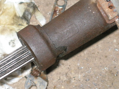

Here is a close up of the crack.
I was doing a routine check of things when I noticed that there was oil on the inside of the tire. Since my wife drives this as much as me, i'm not sure how long it has been like this. With the tire on and the fender pan on, you really couldn't see this unless you were looking for it.
Also note, the parts guy at my local deere dealership said he'd only seen one broken axle housing in all his years and it was when a tractor rolled away from a guy and the back tire struck a tree. Still not sure how this happened! I'd like to think i'm careful /forums/images/graemlins/tongue.gif
