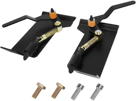

I bought this framework from Deere for my 80 loader. 'They' said it wouldn't work. It does if you make a tiny modification to the curl cylinder pin collars: Grind off 1/16".
then I bought a new bucket all set up for the Deere QA, but a grinder can remove all the old bucket's pin fittings and then you weld on these 2 plates. I even made up a new offset post hole digger from a set and it runs hydraulically. Nice to see where the auger is headed into the ground and my owl neck is gone. Even my bucket old level rod fits right in. By far the most use I get from it is forks. I even move my golf carts around with them. Built a snowplow frame up by this year I want to try a broom. Have not used the tree puller yet, but pretty soon !
