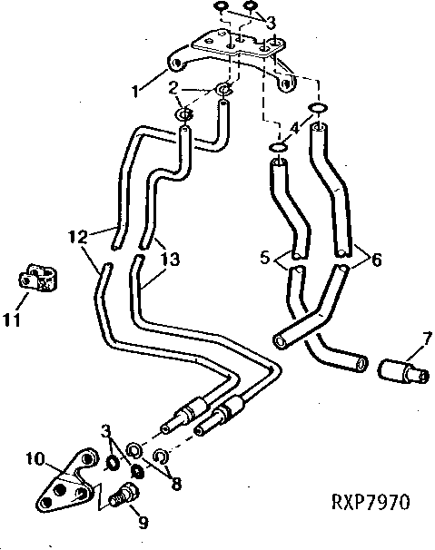

Does your tractor have hyd ind pto(lever between gear shift levers)&/or hyd hi-lo(rabbit/turtle on LH side of dash)? If so there's probably a blown o-ring that is intended to seal those options supply tubes.

You'll have to raise trans shifter cover.Parts listed are available from a JD dealer.
A3917R O-Ring - O-RING, PACKING ADD 1.06 USD 2.12 USD
R375R O-Ring - PACKING,O RING ADD 1.12 USD 2.24 USD
R54189 Gasket - GASKET,CLUTCH HOUSING COVER ADD 5.90 USD
*Subtotal 10.26 USD
*Total 10.26 USD

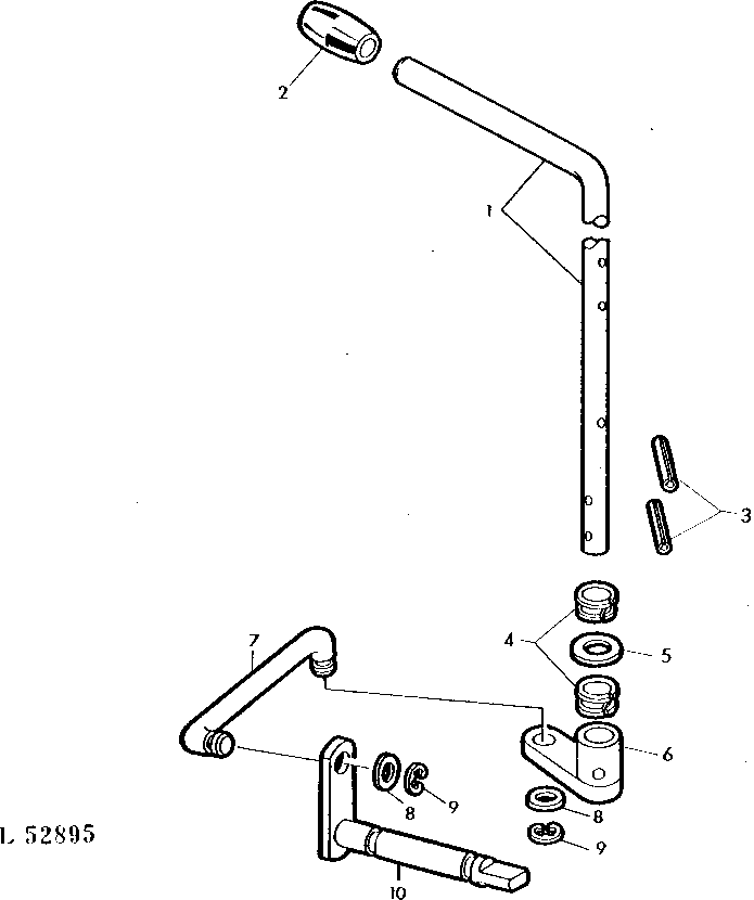

Disconnect vent tube on right forward side of shifter cover.
The HI-LO will have a rod connected to a lever on the left side. There is a snap or E ring holding the shaft in the lever (might want to buy a spare E ring) Disconnect HI-LO rod from the lever
The shifter cover is held on with 7 bolts, 4 across the front and 3 across the back. In the front the bolts also hold the Independent PTO lever/valve operator to the shifter cover (might want to get that gasket too). Some bolts are different lengths, mark or remember which go where.
Put both shift levers in neutral. Remove the shifter cover.
On the bottom will be a metal plate. No need to remove it. In the plate will be the O-rings. The tube holes will have grooves in them for the O-rings. Replace them all. Lubricate them with hydraulic oil before installing.
Lubricate all the tube ends with hydraulic oil. Reassemble.

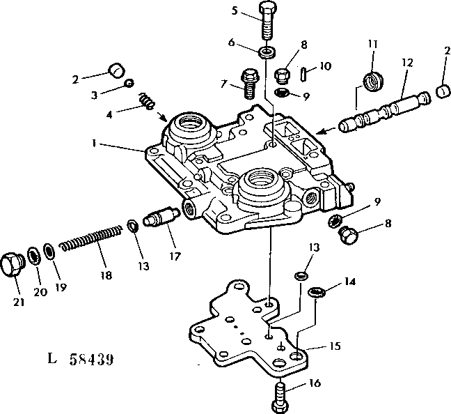

perhaps the plate (15) below the cover is cracked. it would explain why the new o-rings didn't fix the OP's problem.
