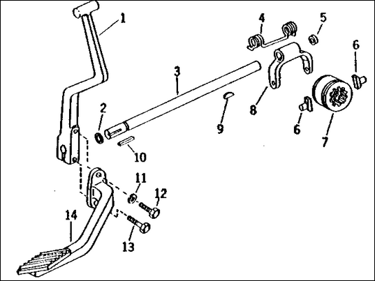

Was looking at a real clean, straight iron, 2240 with a JD 143 loader. Around 1,800 hrs. But needed all new rubber. The diff pedal was propped up with a chunk of 2x4 and as such ,likely no longer functioned.
Figured it would need to be split for R and R.
What do you suppose would be the "worst case scenario" regarding cost, etc.
Thanks in advance.
   / jD 2240 with busted differential lock? #2
Most diff lock assemblies are held in the unlocked position by an internal coil spring. If that spring is broken then the weight of the pedal would keep the diff lock engaged all the time, which isn't a good thing. My guess is it works fine, just nothing keeping it from locking all the time.
Again, in most cases, this repair would require the tractor to be split. Or maybe the right side axle housing removed for access if the diff lock pedal shaft goes thru that case to enter the housing. I can't tell you from this vantage point.
Maybe do a "parts" search on deere.com and try to find a parts diagram for that section of that tractor???
   / jD 2240 with busted differential lock? #3
Not sure of the model number, so I might have the wrong picture here. This is a parts diagram for the diff lock pedal assembly. Part #4 is the spring that would hold the diff lock in the unlocked position. It's not a coil spring but rather a twist spring. As you can see, if the spring is broken the weight of the pedal is going to engage the lock all the time.
A minute or two on the tractor moving it around will confirm this.

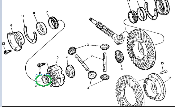

Diff lock on this tractor is operated I believe by locking the Left Hand final drive shaft to the differential housing. The final drive shaft and even the LH housing side can be bought through aftermarket channels like a&i. Like $150 (a-t28908) for shaft, $415 (a-r51500) for diff housing but I think the problem part is the shift sleeve itself (r51501, it is not available through Deere but can be bought from aged inventory re-sellers like the parts depot, normally a dealer will have to get you the price). That would be a couple of thoughts on the worst case side assuming the final drive and/or diff itself is still just fine. Best case scenario would be the torsion spring, hope you have that kind of luck... I don't.

I rooted around on JDParts but could not find what the actual locking mechanism looked like; i.e. pins that engage the differential, etc.
The linkage was pretty straightforward. The detail of the differential, not.

My guess is spring is broken allowing pedal(key 14) to drop engaging diff lock when not needed. Normal problem is shaft(key 3) gets rusted tight in axle housing.

You have to pull the left axle assembly, not split the tractor to access the differential lock.
