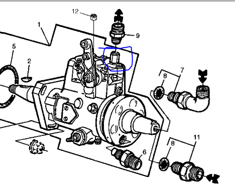

Check to be sure check ball in fitting encircled in blue isn't clogged & that fuel return line from IP to tank is not clogged. If check ball is clogged then more than likely fiber drive ring in inj pump is deteriorating requiring IP repair. After cleaning check ball engine may operate for an extended period of time but is subject to exceed normal rpm's IE run away.

@ pumpguys..."the fitting on top"...do you mean the return line?
   / JD 270 Skid Steer no fuel issue...??? #6
Yes, the return line AND FITTING.. fitting removal is very important..
A clogged fitting will shut one down and/or keep one from running.. so remove the fitting for diagnosis..
fitting he's referring to remove is the fitting encircled in blue in the photo I posted.

Thanks...Some progress...opened the fitting on top (return) and got a lot of air and fuel...but it kicked off and will run but poorly...am in the process of changing the filters etc....stay tuned...
