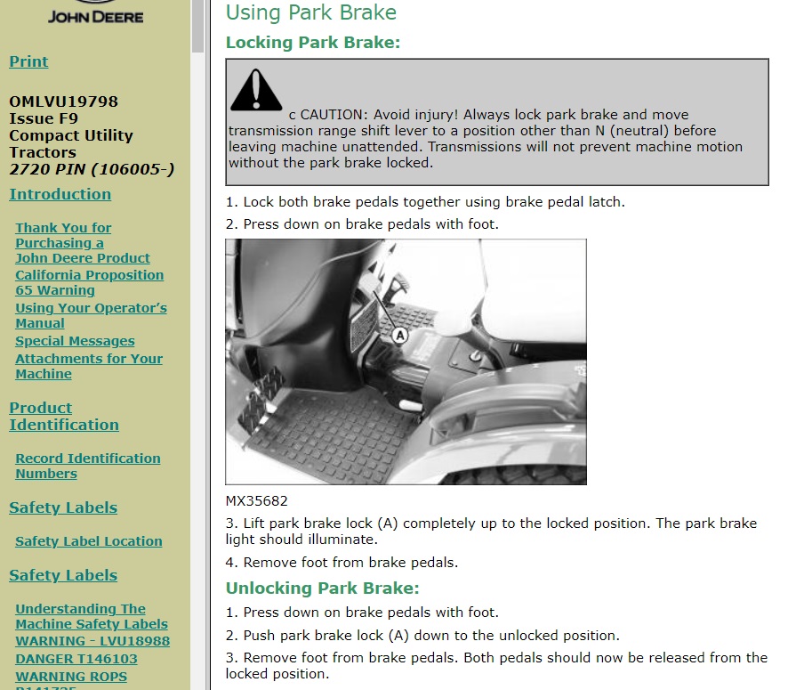

There seems to be a difference between the Euro model 2720 and the American 2720.. Euro had a hand lever for a park brake, and the Amer. has a lever lock to hold the brake pedals engaged when both are locked together.
Here is the Amer. directions from the oper. manual. But agree that the brakes should be equally adjusted.. there are turn buckles per jdparts. Maybe the foot deck or covers under the seat need to come off?
No idea why JD didn't just install the Euro system on the U.S. tractors as well. It is a superior setup. They did finally go with the Euro system on the Gen-2 2032R/2038R.
The deck covers do not need to be removed. All adjustments can be made from underneath.
Note for the OP... if the turnbuckles have never been adjusted the lock nuts can be VERY tight. Make sure you use good well-fitting wrenches.
