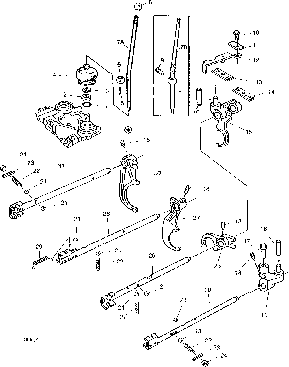

I have a JD 2840 while I was operating it began to feel like the brakes started to engage stopped the tractor and killed the engine. I start it but when I take my foot of the clutch the engine dies no matter what gear or hi low position selected. My hydraulics still operate as normal to include the pto. Any thoughts on where to start my trouble shooting?

   / JD 2840 won't go hydraulics and pto are working engine dies when clutch is disengaged #3
Are you sure it's not in 2 gears at the same time? The tabs on the shift rails that gearshift lever fits into have been known to break off leaving trans in a gear.
I took off the cover plate in the picture you posted. Where the selector levers engage the shift rails (31,28,26,20) in the diagram everything seams normal. Could there be a problem at the other end of the shift rails?
   / JD 2840 won't go hydraulics and pto are working engine dies when clutch is disengaged #6
It's possible the set screw that attaches fork to rail has loosened. Also it's possible a gear has galled to a shaft. Has tractor ever been operated real low on hyd fluid??
   / JD 2840 won't go hydraulics and pto are working engine dies when clutch is disengaged #7
as txjim stated the two post shifter on the 40 series is troublesome at times, it sure sounds like its stuck in two gears, do both sticks return to the neutral position ? or does one feel like different than the other,
