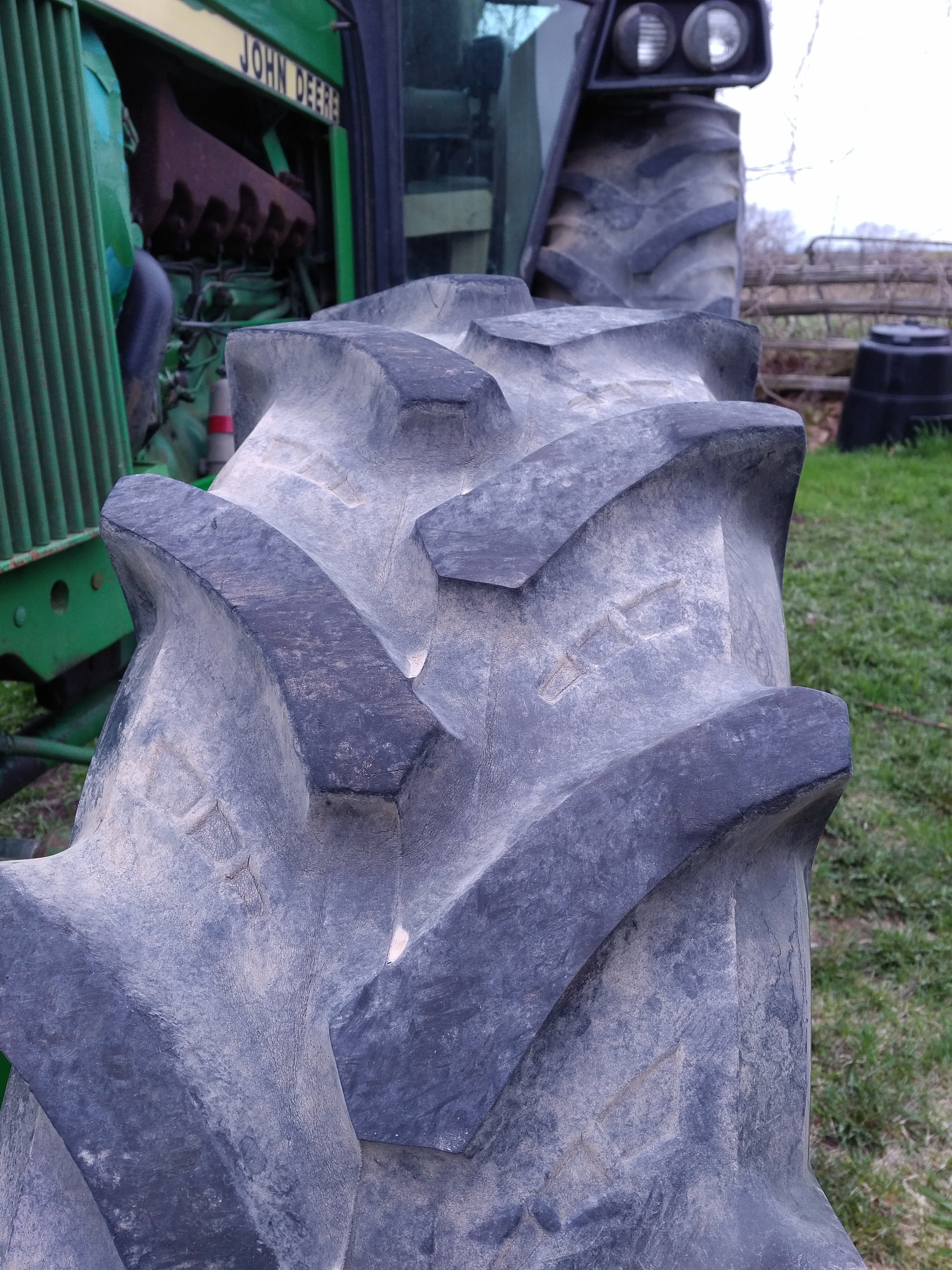

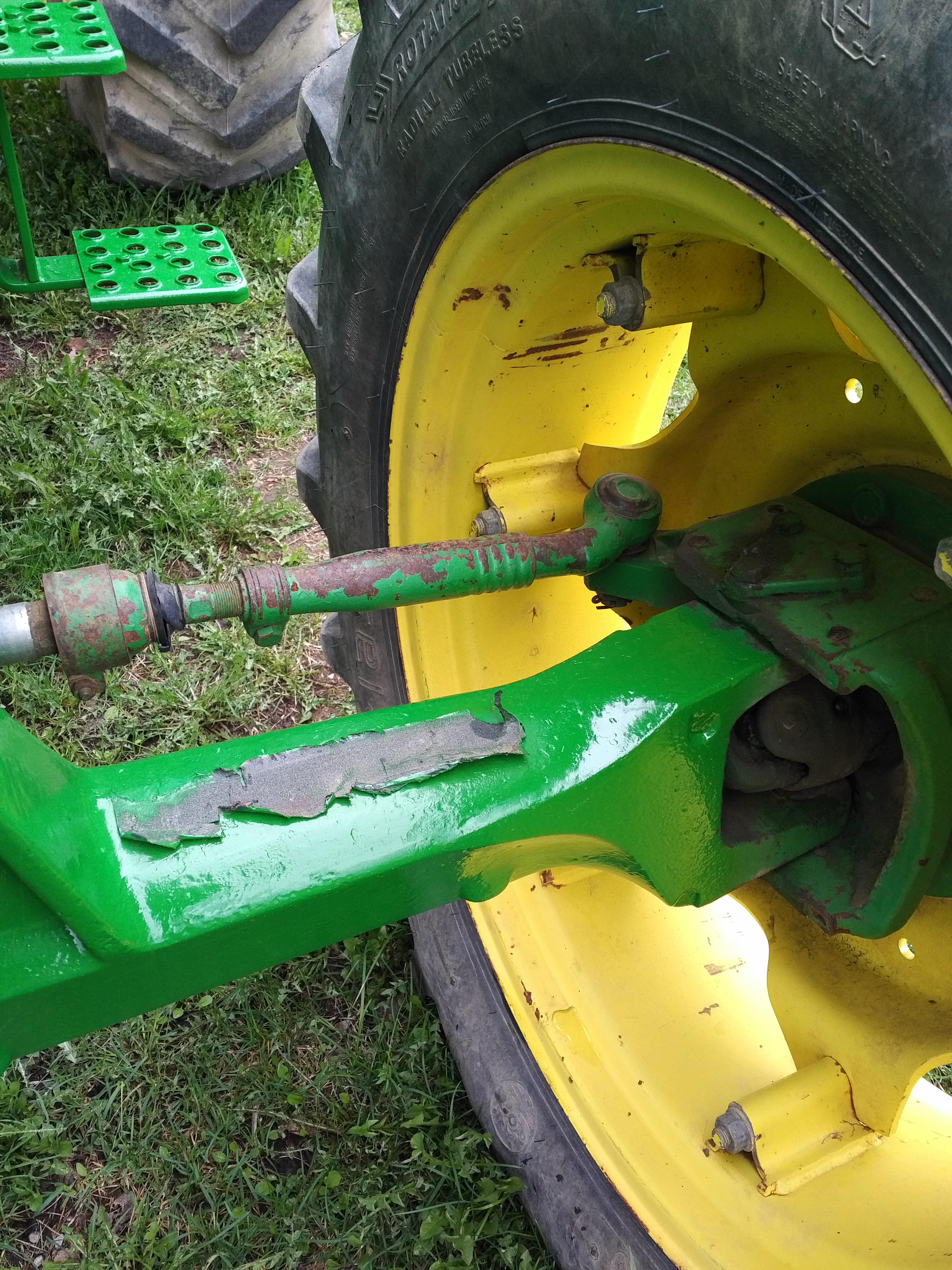

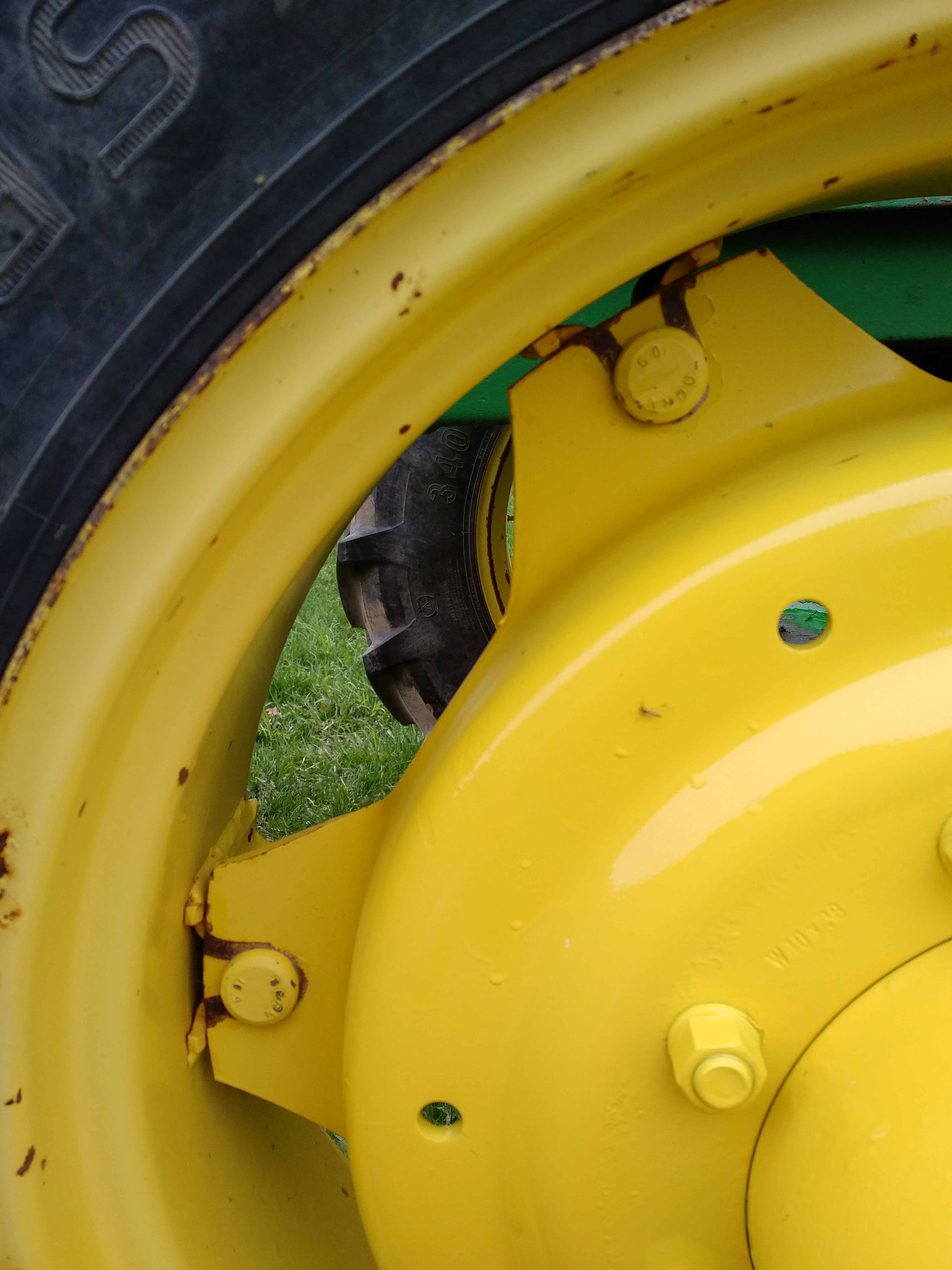

Jacked up the front end. No play in and out when grabbing the tire top and bottom which means the king pins should be good. Slight play toe in and out on the right side and a tad more on the left side where the tierod meets the hydraulic shaft where they couple together.
I took a picture to show that the rims were flipped around at some point. I just got the unit and going over a few things so maybe that explains the worn lugs on the outside?

The rims are designed to be able to flip them around to get different wheel spacings. That should not be causing any tire wear. You can flip the centers and also flip the fronts in different configurations for 8 different tread widths. I would replace the loose tie rods and adjust the toe in and you should be fine. Your picture of the tire wear appears to show lots of road travel. Front mfwd tires tend to get wear similar to that when travelling a lot on hard surfaces.

Just to confirm, Adjust the toe inward?

Of course if all is fine you can swap the tires to the other rim, thus making the inside now the outside. Just to be sure I make it clear, take tire off the left rim and install on the right rim.
