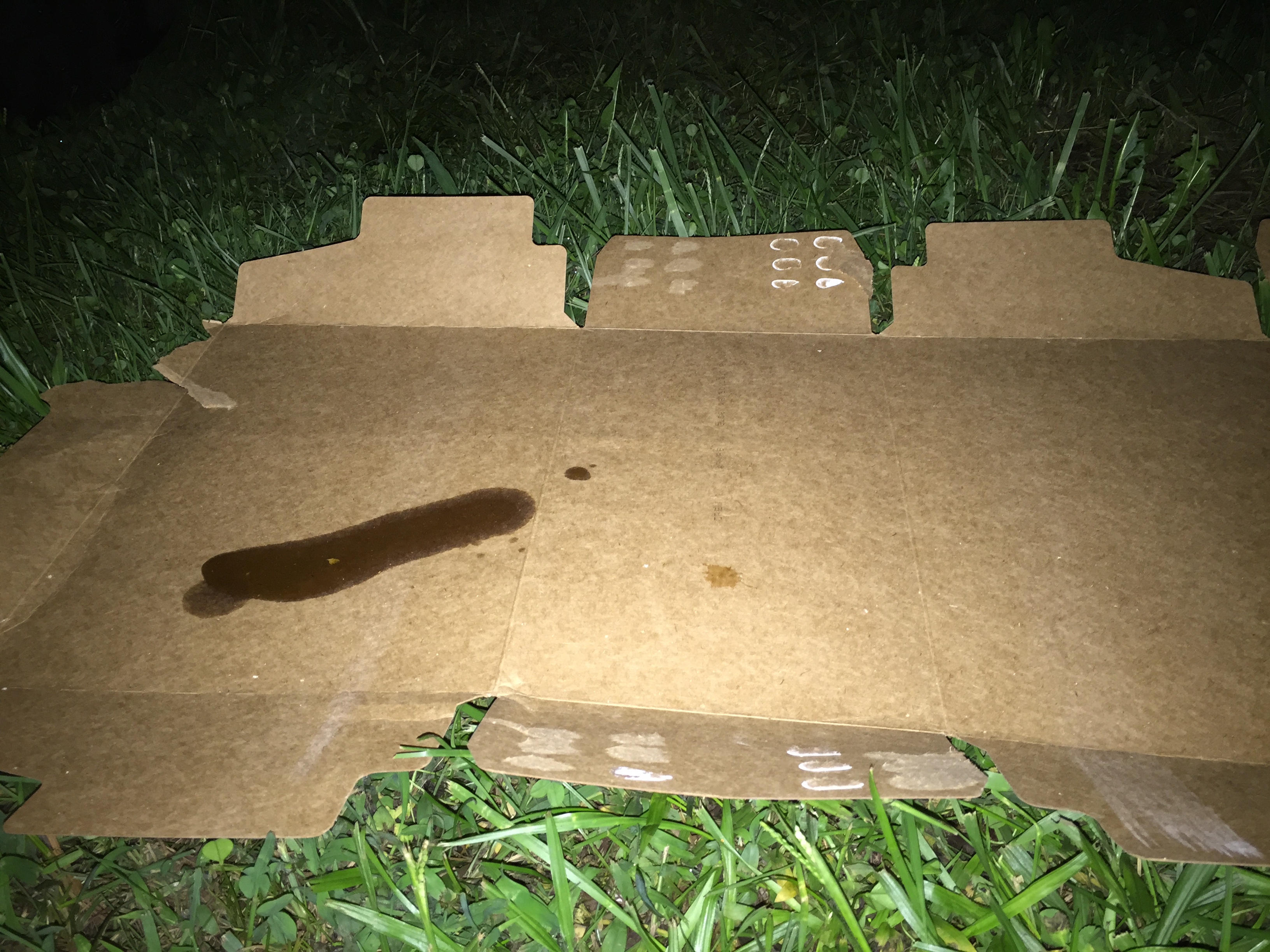

Good afternoon,
I recently purchased a John Deere 300 Industrial tractor w/ loader.
I have been working through the leaks and have fixed a few.
It is leaking from the power steering shaft out the side of the transmission.
I found this thread which helped me locate and purchase the correct seal. (it wont let me post this link until I have 3 posts but it was a link to a tractorbynet thread)
I noticed in that thread that when he replaced his seal, it was still leaking because the oil was coming through the shaft splines where his seal wasnt seated.
When I opened the inspection port on mine and went to loosen the steering arm bolt, it was loose already.
Is this what my steering arm and shaft should look like when tight or should these two parts be flush?
It looks to me like the shaft is recessed about 3mm and possibly that is why it is leaking?
Thanks for reading this post and I hope you have a good evening.
View attachment 667798View attachment 667799
   / JD 300 Industrial PS Leak
#2
Here is my result after tightening the bolt. I assume it is seated correctly.
I will work to replace the seal and will post a video of the process. At the moment, I just need to locate a longer bolt which is required to thread in and knock out the shaft from the steering arm.

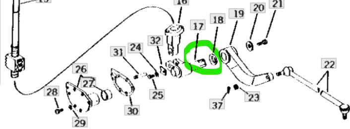

Seal(key 18) should seal off oil before oil gets in contact with splines. Spines on shaft & lever are tapered so shaft when splines are tight should remain recessed in lever.
