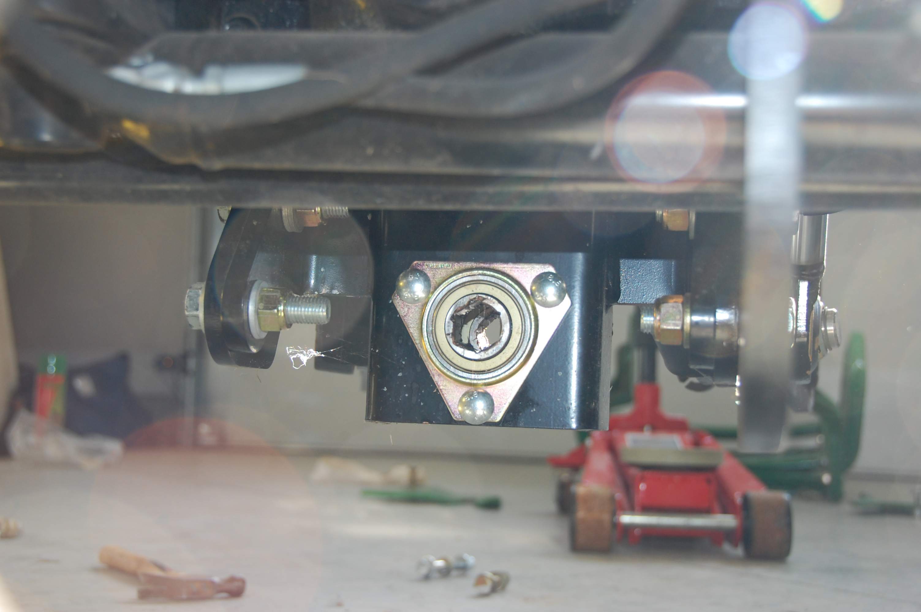

Thanks, I have figured out there are two problems. First, I realized that my drive shaft was too long even if I could get it through the bearings. Went back to the dealership and they agreed, not sure how I got the wrong shaft in my kit.. But they found a new kit and the driveshaft was about 4 inches shorter than the one I had.
So, that's a step in the right direction. But I still couldn't get it through the bearings. I finally unbolted one of the bearings and that allowed it to have enough slop to get it lined up correctly.
When I did that and got the spline all the way in, it was still just a tad too short, looks like maybe 1/4" or so. I think the lead bearing might be mounted on the wrong side (something else the dealer did) so I'm about to take it off and mount it so that it's on the "inside" of the bracket. I think that will give me just the right relief to get it on the mid pto shaft.
   / JD 3000 series front hitch for snowblower
Yep, that did it. I put the bearing on the inside of the box bracket that it's mounted to and left it a bit loose and the shaft went right on. Then I tightened all the bolts and it's good.

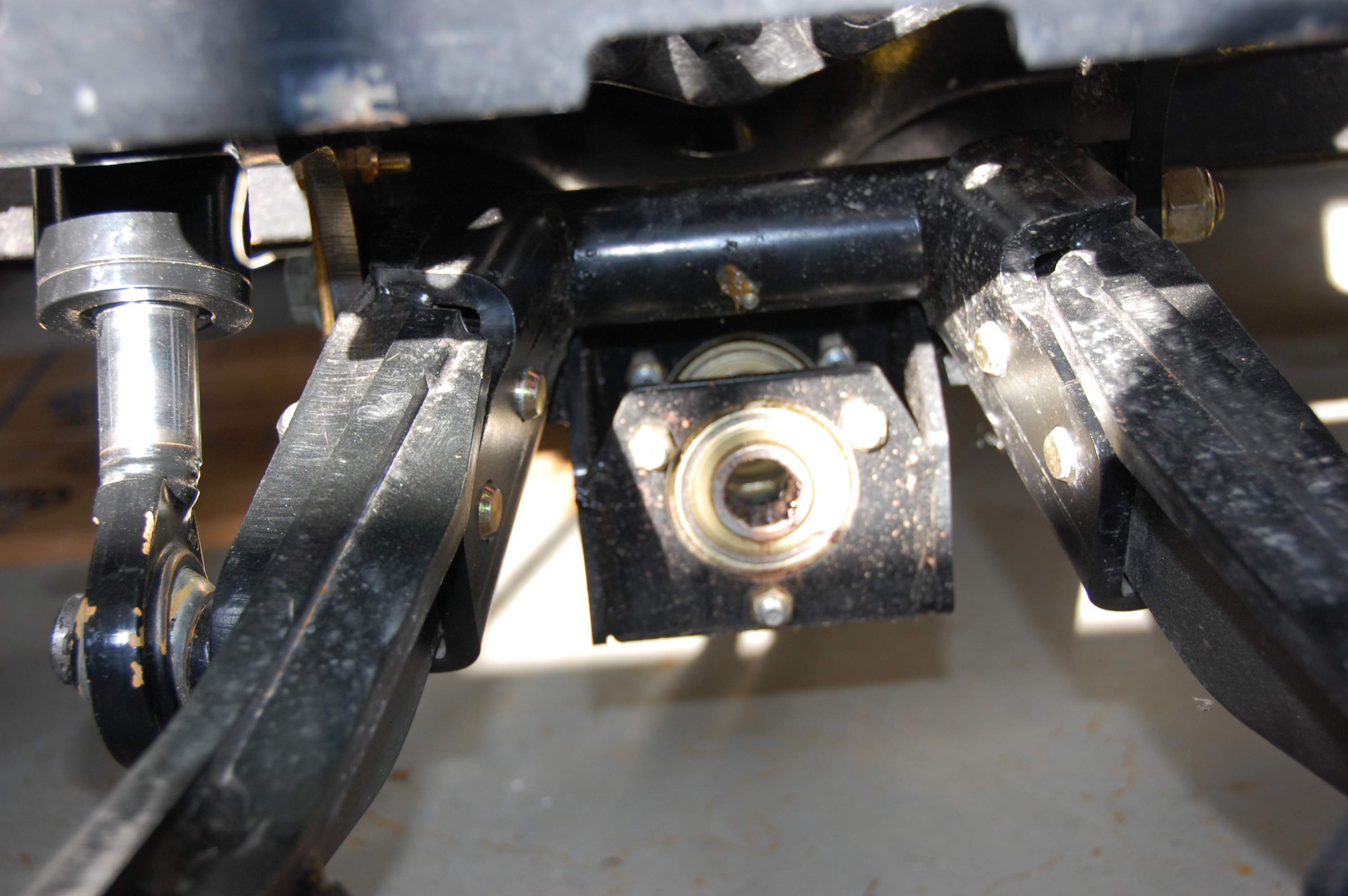

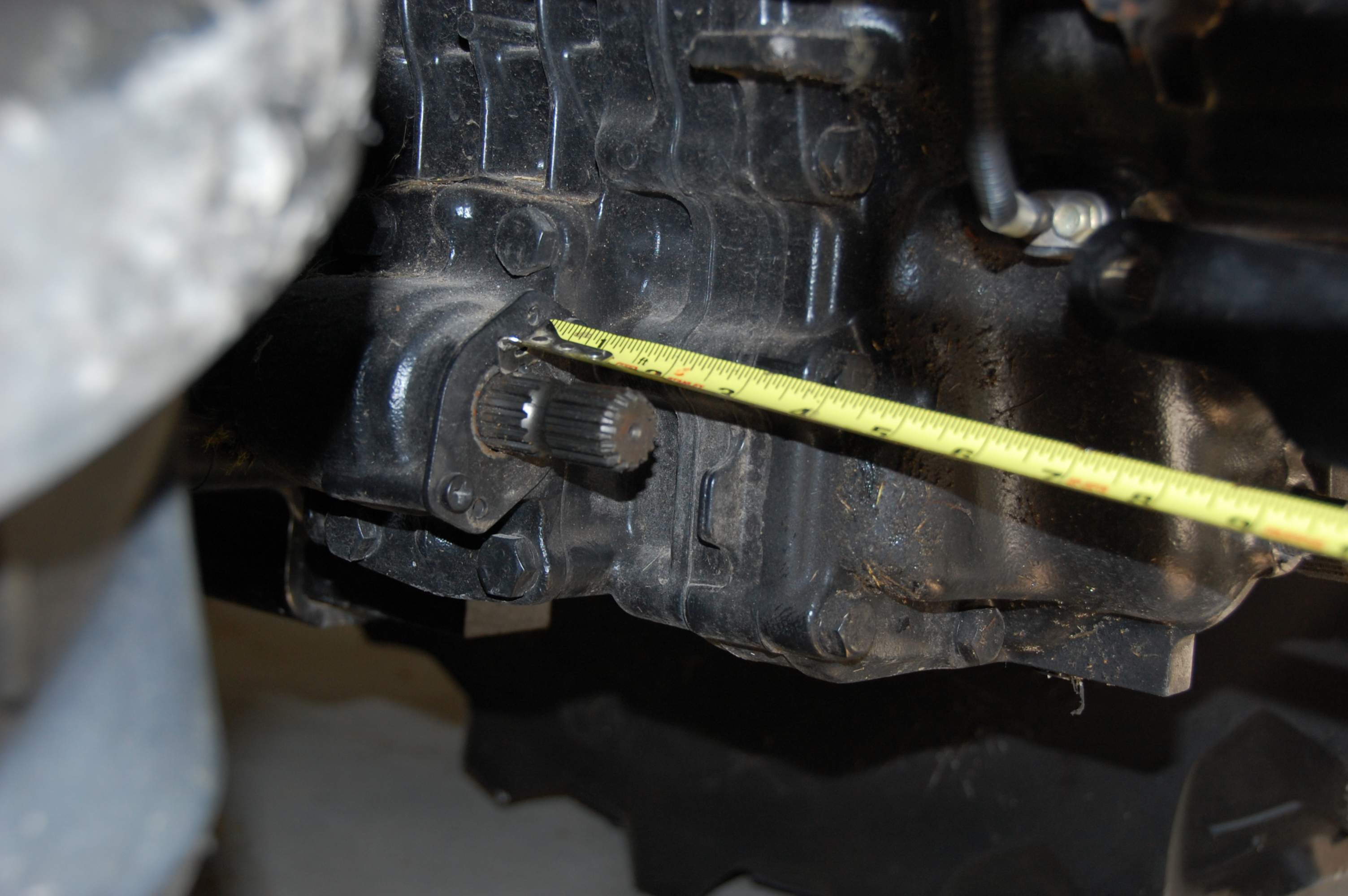

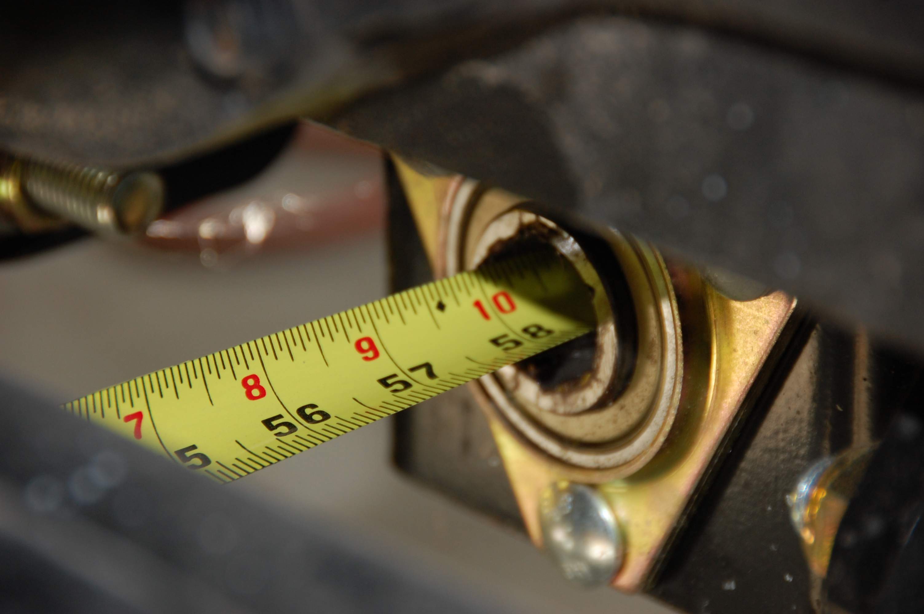

Here are some pics. First pic is the front of the hitch. The 2nd is the back side of the front hitch from underneath, that's the bearing I had to remove and put on the inside (the pic shows the wrong way before I moved it). Then there is a measurement from the mid pto to the front bearing, that's what I took to the dealership with my shaft to show them it was too long.
