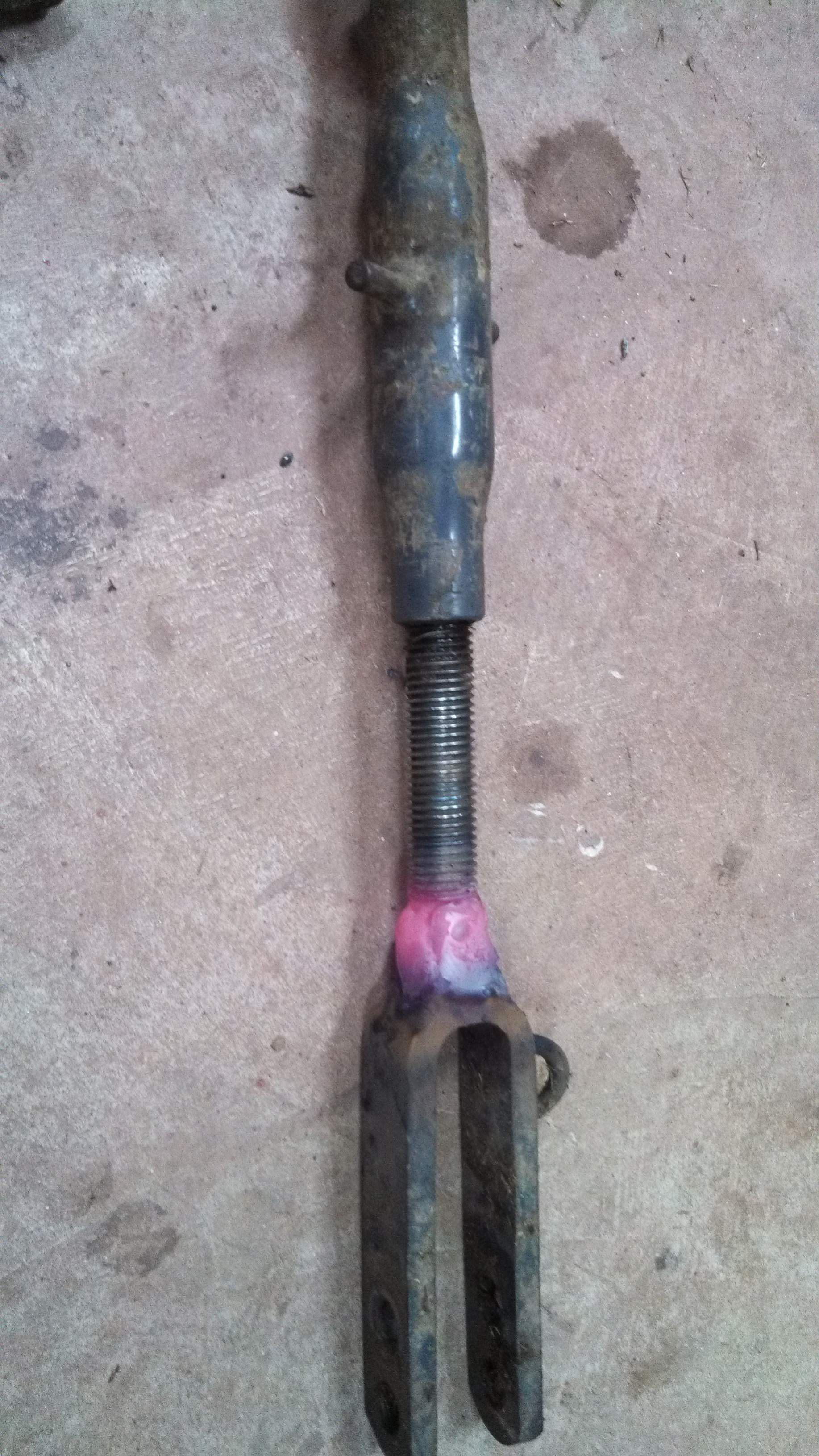

Not familiar with the specif model, but alot of 3PH's have different holes for attaching the vertical links. Perhaps yours is in the highest setting?
Some have multiple holes on the arm, and others have multiple holes in the link.
Here is a picture of one of my sidelinks (I broke and had to fix).
Notice I have 2 holes where it hooks to the arm. Do you have something similar? or perhaps post a picture of yours?

Its not on the rocker arm. Rather the lower end of the vertical link that hooks TO the rocker arm.
ITs also possible that the rocker arms were not put back on where they were supposed to be. And they are a tooth off, which would give higher lift, but not go as low.
Again, a picture is worth a thousand words here.

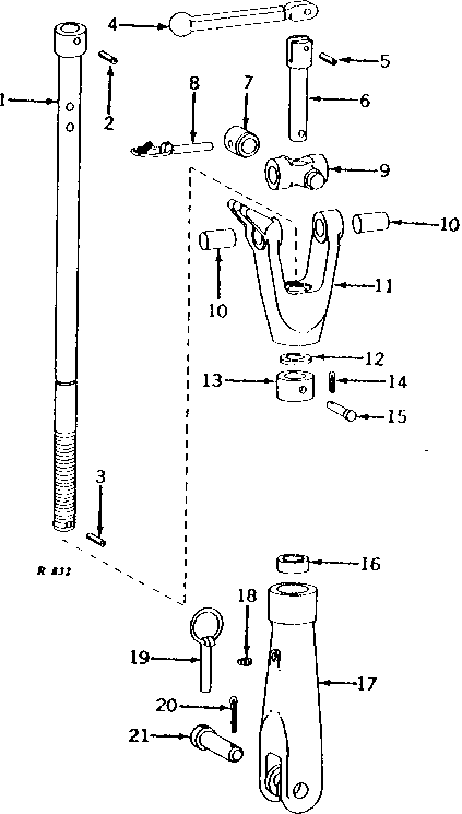

What size rear tires do you have? oversized tires definitely have an effect on height of hitch. The lift links on a 3020 should be adjustable in length. Turning handle #4 will shorten and lengthen the lift link. If link is frozen up, you need to free it up so you can adjust it.
