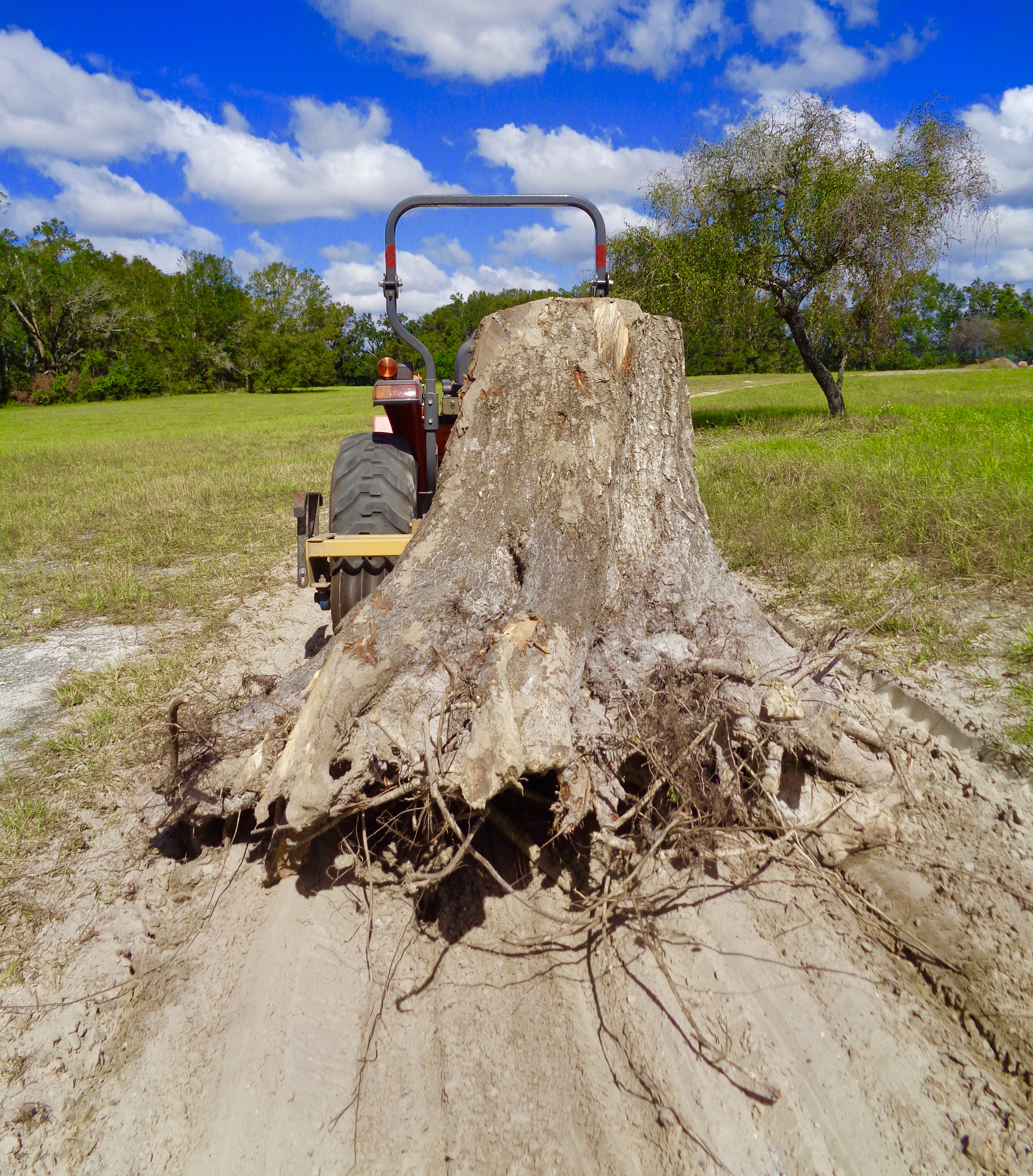

I know that the drawbar on a 3032e has a vertical load capacity of 882 lbs. does anyone know how much I can pull with this drawbar?
   / JD 3032e drawbar pulling load capacity #2
Are you asking about rear/center drawbar or Three Point Hitch cross-drawbar?
Rear/center drawbars are engineered for heavy loads. Your limitation will be tractor traction, a factor of tractor weight, 2-WD VS 4-WD, tires and soil condition, rather than any limitation inherent to the drawbar.
A cross-drawbar has the advantage of allowing load to be lifted slightly at the tractor end, reducing load friction with the ground. You seldom see a cross-drawbar with a lot of use without bar sag. Lifting above rear axle height can make tractor unstable. Caution required.
MORE: https://www.tractorbynet.com/forums...ar-center-tractor-drawbar-use.html?highlight=
https://www.tractorbynet.com/forums...actor-three-point-hitch-cross.html?highlight=
