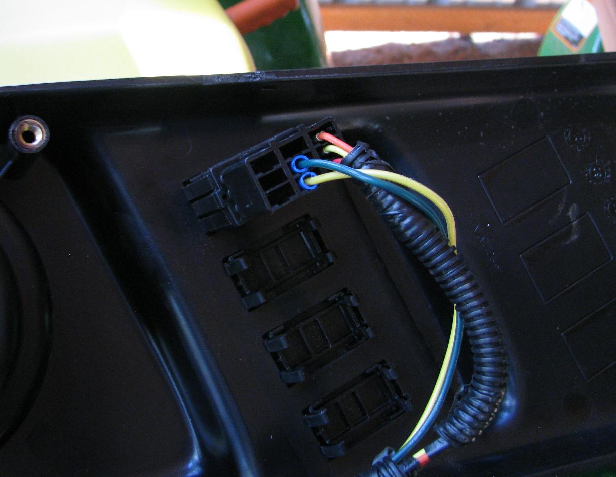

One of the shortcomings of the 3032E is the inability to use the PTO to power a log splitter, wood chipper, etc. without having to over-ride the seat switch. Some use a sand bag on the seat, others short out the seat switch with a jumper, or install a micro switch under the seat so that the seat can be tilted forward to use the PTO. All these solutions have some safety problems.
Fortunately, the PTO pull switch has some extra contacts that are not used. The attached photo shows where to connect them to wires spliced to the seat switch leads. The other safety features will now work normally, and the seat switch is over-ridden only when the PTO is used.

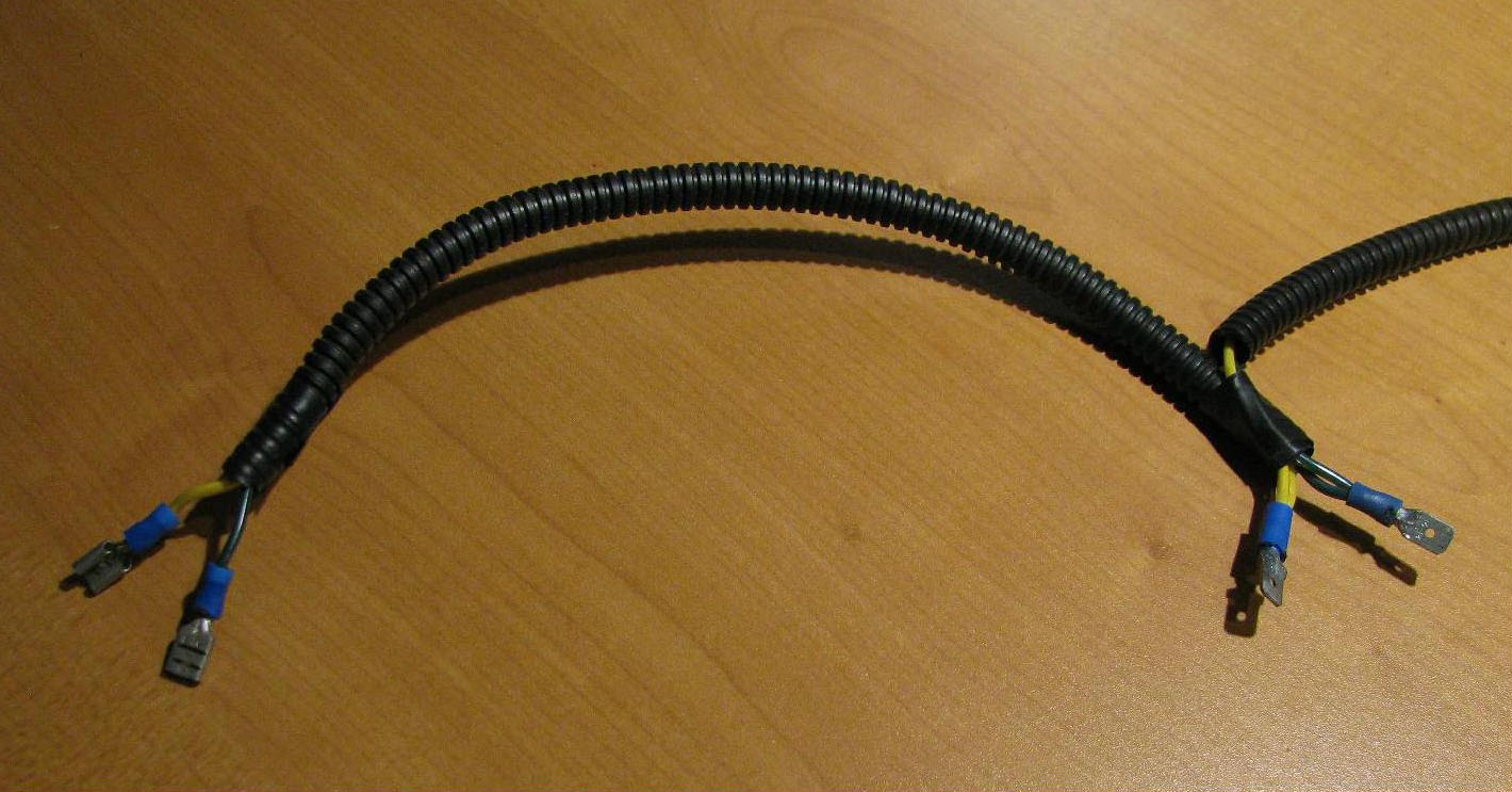

Hank: Could you please be more specific on how you connected the wires to the seat switch. I like the idea of this because I can keep the other safety features.
   / JD 3032E PTO/Seat Switch Over-ride
#9
Jim,
The easiest way to do it is to make a pair of wires about 7 feet long, with a 1/4" female flat connector at each end of each wire. Then splice in a pair of male flat connectors about 1 foot from the end that goes to the seat switch.
Pull the plug off the seat switch and insert the male connectors into the plug you just removed. The female connectors go on to the seat switch.
Hank
