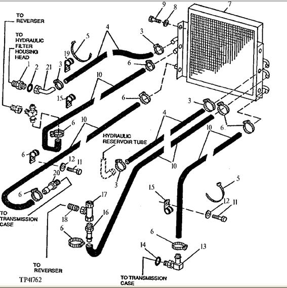

Hi,
I currently have a 1996 John Deere 310D, which is equipped with a cooler that has 3 coolers in one for the hydraulics. The bottom cooler (not sure what it is for) started to leak. I took the cooler to the local Radiator shop and asked if they could repair it. They said they could not as the leak was in a spot difficult to get to without possibly causing damage to the cooler above it. He suggested either getting a new cooler or by passing it with a standalone cooler.
Can you by pass with a generic transmission cooler? It looks like there are only 2 loops in that cooler, so I think possible a smaller standalone cooler may work. Does anyone know what this cooler is connected to? I think the top cooler is for the hydraulic and the middle cooler is the transmission, but not sure what the bottom (3rd) cooler is for??

Looks like the lower is connected to the transmission by the schematic for the 310D.

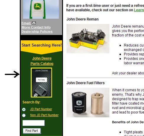

Go to jdparts and do the free registration. Then sign in and go to the parts catalog. Look up your model number 310 and get to an alphabetic listing, or other options. Not a repair manual, but shows the parts and numbers. Great resource for any Deere owner.
Here is what the home page will look like, and the arrow where to click. See kennyd profile for good info too.
I couldn't answer the ?? about the cooler being adequate. If there is room, I wouldn't see why not. Prolly cheaper than a new one from Deere.
