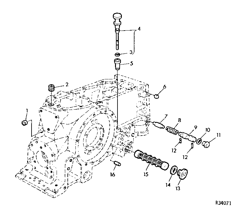

How long since hyd filters were changed & sump screen checked/cleaned? If no very recently then that would be the 1st things I'd recommend to do. Sump screen(parts key 15) can be accessed on RH side of trans housing retained in case by a fitting with a hose attached.

I changed the filters but that didn't help. I'll check the sump screen.
Thank you Sir.
