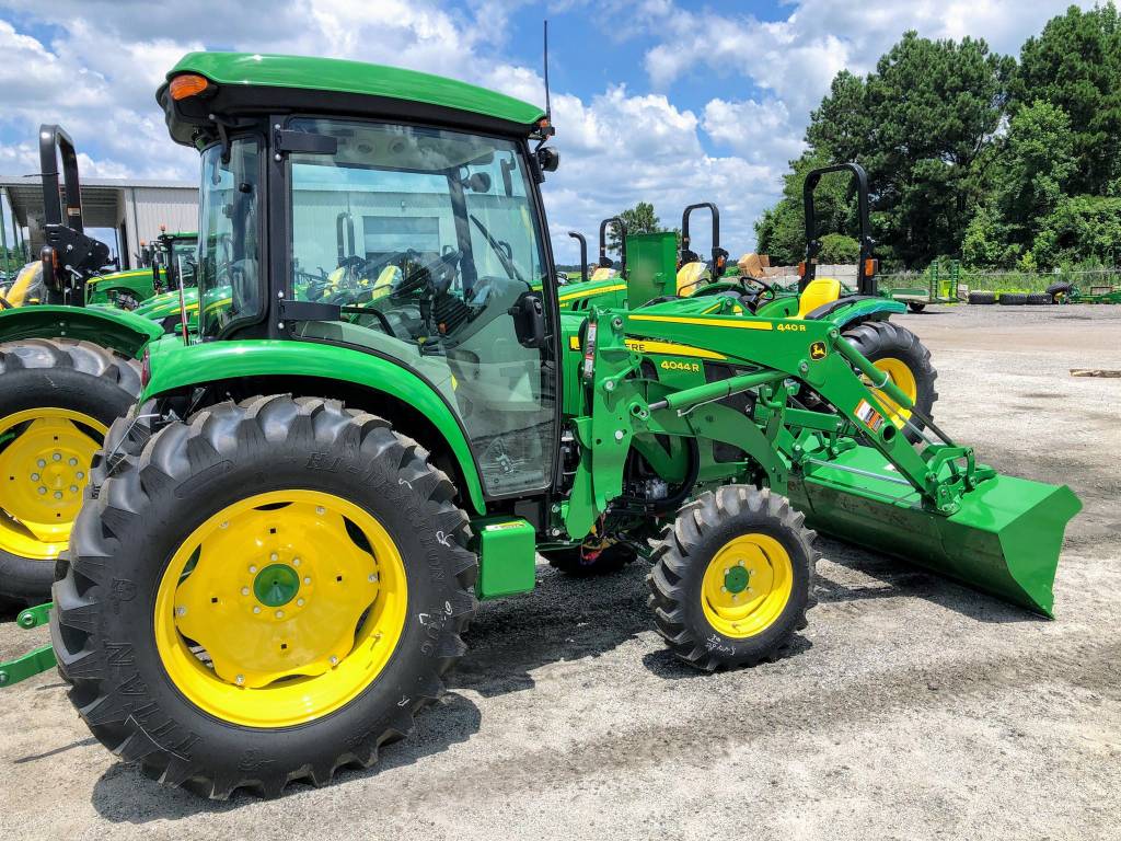

After test driving a 4044R Cab Hydro I decided I preferred the Hydro. Ended up finalizing the deal on the one I tested.
ETA on delivery isn't set yet as they have to install extra functions.
   / JD 4044 with cab and PowrReverser transmission?
