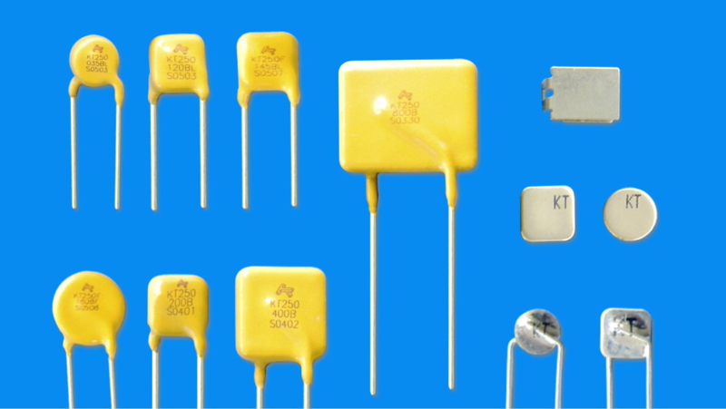

I just read a thread in the John Deere owning/operating forum about a 4400 I think not starting. Someone said to check the thermistor. It's behind the fuse box in the mess of wires somewhere. Should look something like this
Also do a search for thermistor on here. I've read a couple different threads talking about it and I think it caused the problems you're describing. I'm not sure how to check it when you find it. Might need a voltmeter or something. Might be able to tell just by looking at it, I don't know.
Anyway I'd look there before I starting shooting ether.
   / JD 4100 won't start #12
I remember them saying the thermistor is small, about the size of your fingernail so you might have to look for it a little bit.
Ok I did a little looking and there was another thread on here about a 4200 not starting. They replaced the thermistor and it took care of the problem. Said the part # was LVU10323. Cost $4
