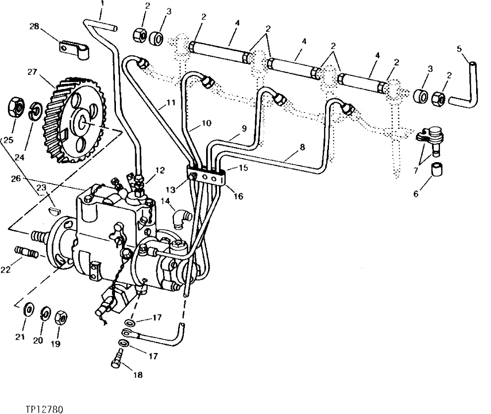

Please help. The backhoe will Start right up. It will then stall right out unless I hold down the pedal. But revving it up it is sluggish. Has no power, can't push into a pile. I replaced the fuel filter, the air filter, also the fuel pump, bled the fuel filter and the entrance line to injection pump. What else? Injection pump itself? Glow plugs? Please help

Check the fitting(parts key #12) as it contains a ball that can be plugged causing pressure in inj pump to get too high stopping fuel flow. If fitting(parts key #12) is plugged then it's likely the inj pump drive ring in pump is deteriorating. Do you have good fuel flow from fuel tank to inj pump?

I checked the ball valve and it was free and clean. I have great fuel flow to the injection pump. Thank you for helping. Is there also a Reedvalve that could be stuck?

I checked the screen to the intake of the injection pump, it was clean. I do have constant voltage to the solenoid in the pump, so my next step is to open the top of the pump to see if the solenoid is staying open. If its bot that, I guess I'll check to see if any if the injectors are faulty. Thoughts?
