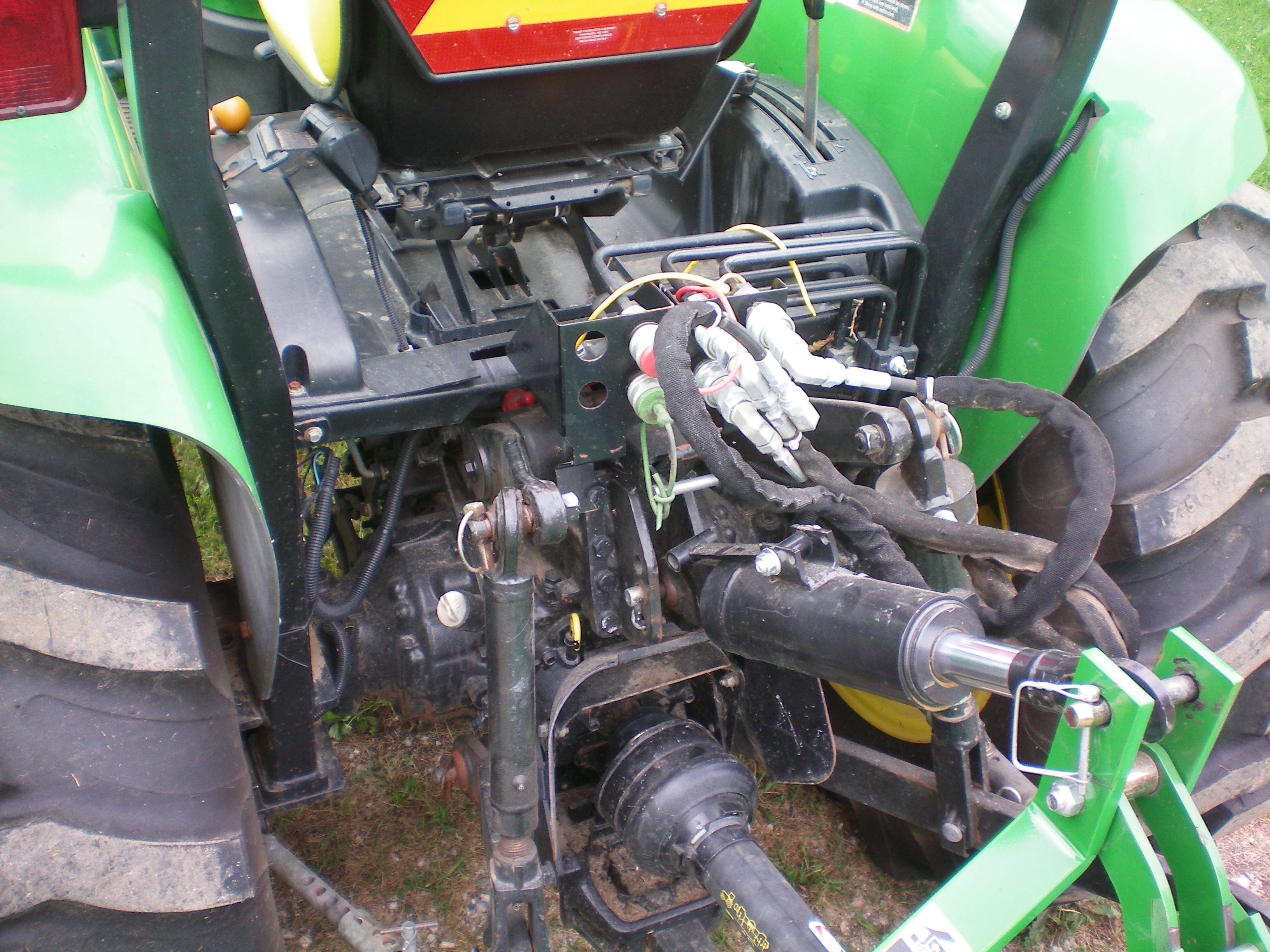

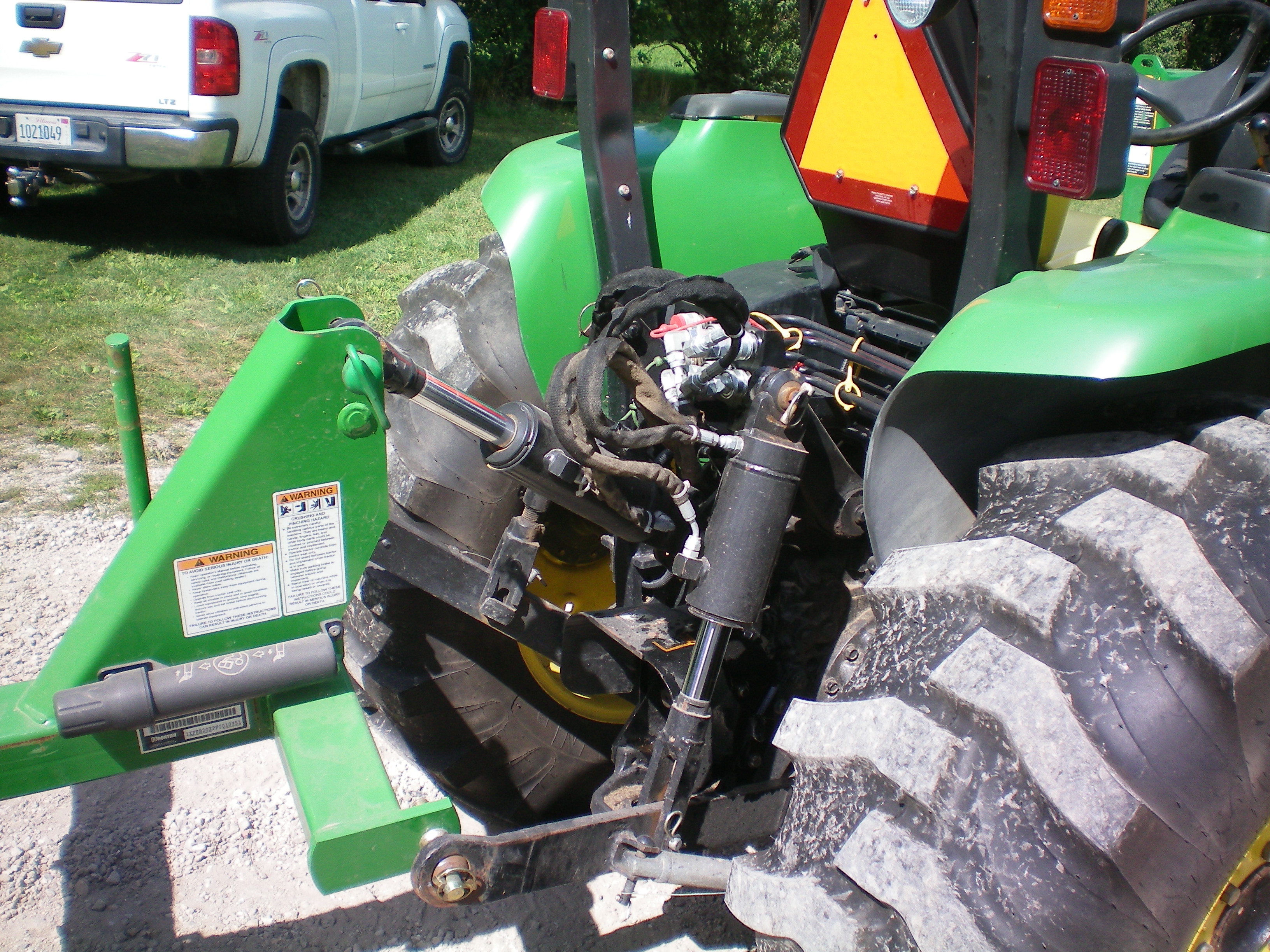

100_0304.jpgI just happen to have a 4120 that is for sale and has the 2 rear kits
1 is for the top link and side draft arm has a toggle switch which changes flow from loader control to rear 3 point control
the 3rd scv [ mine is an older machine 2008 ] is controlled by lever next to seat , you could run hoses from that under tractor up loader arms to bucket
I will have to get some better pics for you but this is what I have100_0310.jpg
