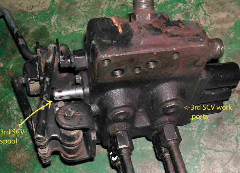

What you can do is buy the parts from JD that include the bracket on the
valve, the cable remote control, and the friction lever that goes on the
fender. The work ports are accessed on the bottom of the triple SCV, so
you can just buy standard fittings and connect them to hoses with QDs.
These hoses do not have to be attached to any bracket as JD does....you
can just attach them to each other when not used, using one male and
one female QD. Or put a terminating bracket somewhere else.
I plan to do it the first way. I have bought the 3rd SCV control bracket, but
nothing else so far. I am ambivalent about the friction-style lever that
JD uses.
