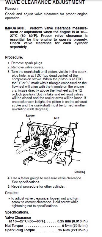

I have a 1998 JD 425 with the 20hp Kawasaki engine and would like to adjust the valves - could someone help me with the following?
-valve settings
-does this engine use flat gaskets or o-ring style gaskets beneath the valve covers
-the rocker adjustment nut torque value
-the valve cover bolt torque value
the engine serial # is: FD620D130255
Thanking you in advance

I'll look in the tech manual for those numbers later today.. if you don't already get them from another member.
A good idea for you would be to secure a tech manual.. well worth the price.
What I found:
re: -the rocker adjustment nut torque value
Valve clearance adjustment nut 79 lb-in
Rocker arm adjustment screw locknut 79 lb-in
re: the valve cover bolt torque value
Two listed for "crankcase cover cap screw" at 186 lb-in, and for the same item 17 lb-ft.
(I suspect the first is really for the Rocker arm cover and is an error, as the 455 diesel shows Rocker arm cover is 160 lb-in)
Valve cover gasket is of the o-ring style (i.e. not flat)
Pic of the valve settings as follows:

The info I have says o-ring style gaskets and 0.010 in. on both intake and exhaust..
