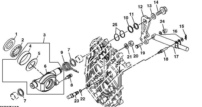

   / JD 425 won't stop moving when forward pedal released #5
Does the forward pedal hang up and not return to 'stop' position and is in synch with the forward motion? There is one rod that goes from the forward/reverse pedals back to the transaxle tranny, so it is either in forward/reverse or stop. Something must be keeping it from returning. Maybe it is the torsional damper #16. Maybe it is the spring inside the tranny #9 that keeps the swash plate #6 from returning to 'stop' or neutral. Hopefully it is something external. Hard to see what is happening unless the fender deck comes off for observation.
Here is what the linkage inside and outside the tranny looks like.

   / JD 425 won't stop moving when forward pedal released #6
The linkages seem to work fine, and the pedal is not getting hung up either. Almost feels like something internal, especially since full throttle will seem to stop it a little sooner

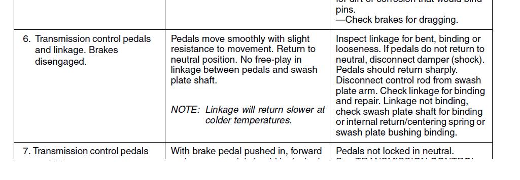

   / JD 425 won't stop moving when forward pedal released #9
I did change the oil and filter, again with no change. I am leaning towards perhaps the spring inside the transmission, but I wanted to read throuh the repair manual first to see if they have any suggestions as to what it might be, problem is trying to read the repair manual online is frustrating to me so I am putting it off. I guess I am old fashioned and like to sit down and still flip through pages.
   / JD 425 won't stop moving when forward pedal released #10
Here is the diagnosis line in the repair manual that may help... like testing with damper disconnected. This may lead to the need to go inside for the return spring replacement.
