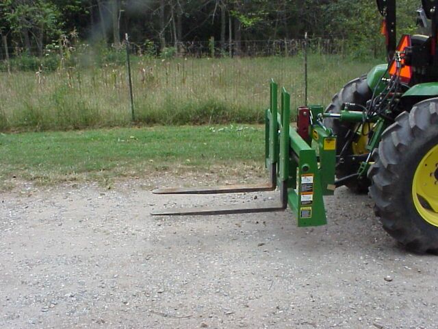

I added some lift pins to my JD 430 loader forks and made a 3pt hitch fork attachment. It also doubles as a carryall with a pallet on the forks.
The top bracket came off an old bush hog and I just bolted it to the forks using the hole for the bale spear.
It works great with the quick hitch and top and tilt. I've posted additional pictures at: Webshots

Nice job Jim, that looks real handy, almost better than off the loader !!
