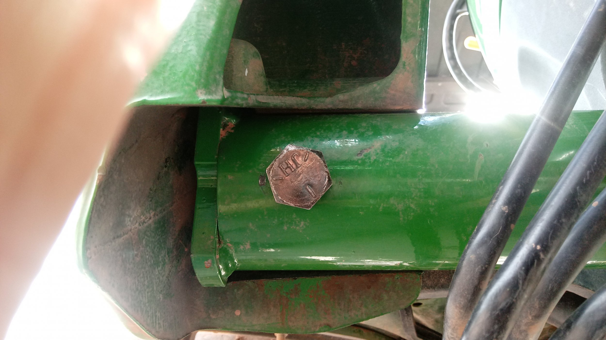

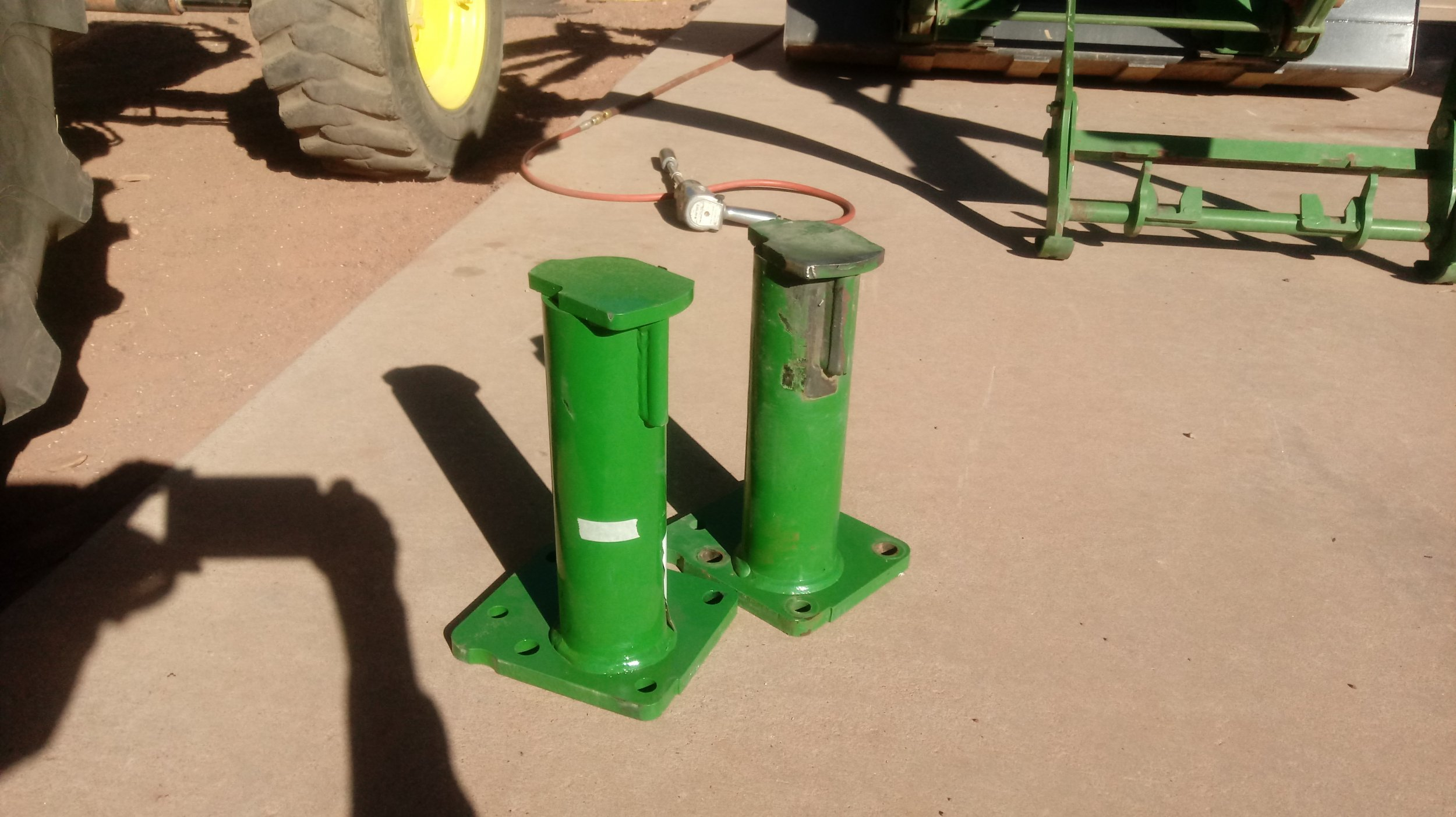

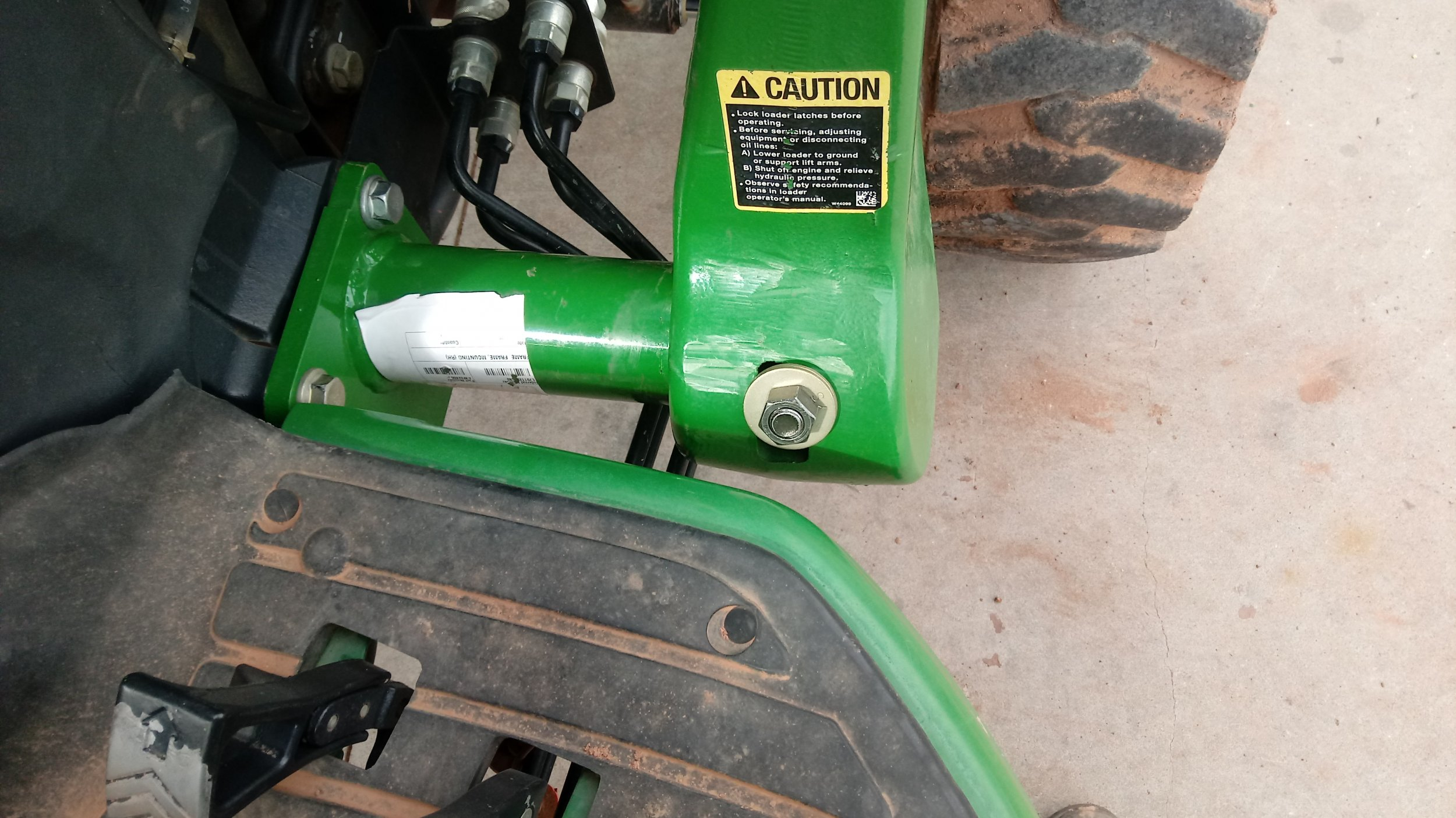

I have an '09 John Deere 4320 with the 400cx loader. It has 3k hours on it. I had trouble with the right hand mount, uncoupling with heavy use. After looking at the wear of the mount and mast I decided to replace the mount thinking it had the most wear v/s the mast, plus it was cheaper:)
It didn't work and still uncoupled. So rather than buy a $1k mast, I did a small mod that should have been incorporated in the first place. I did both sides. It can't come apart now.
