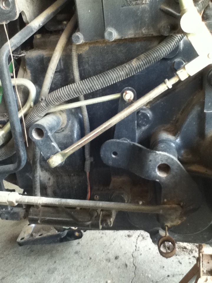

I've tried that. Even tried disconnecting the battery for 10 minutes. The code will only blink when I put it in C and push the pedal. I can drive it around in A and B with no code. It feels like it's not engaging in C, almost like it's in Neutral. When I put it in C it'll roll. Just adjusted the linkage a little more. No go.

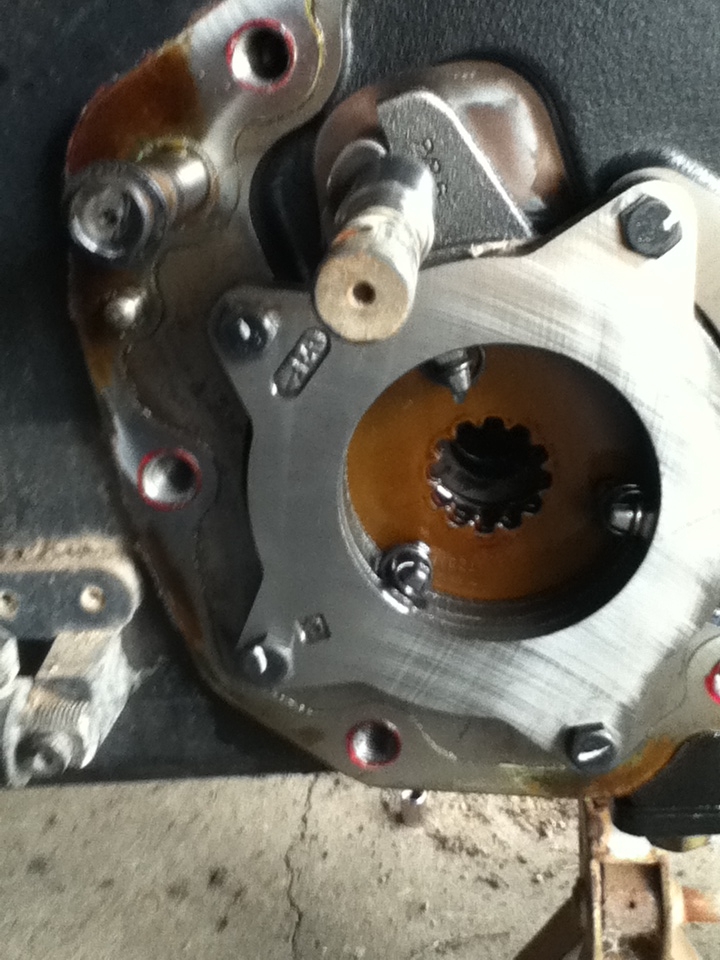

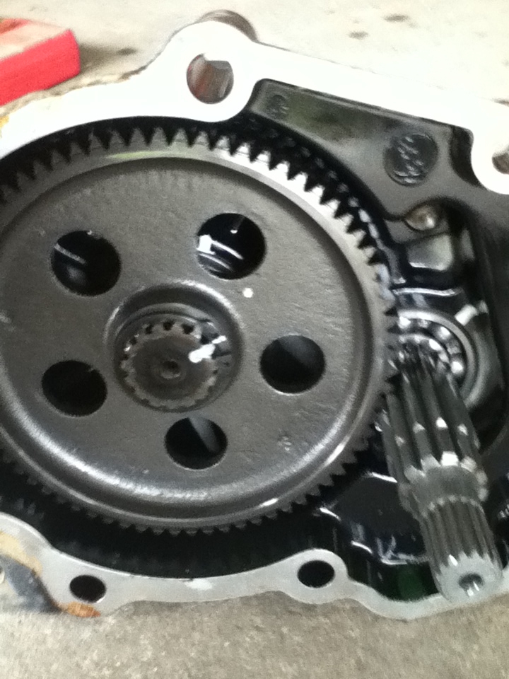

Oh man #5 don't sound good! I didn't even touch that far back for the seal replacement! Here's some pics of the job. Everything went back together smoothly. So I think.

Does anyone have a picture of the range selector gears?
