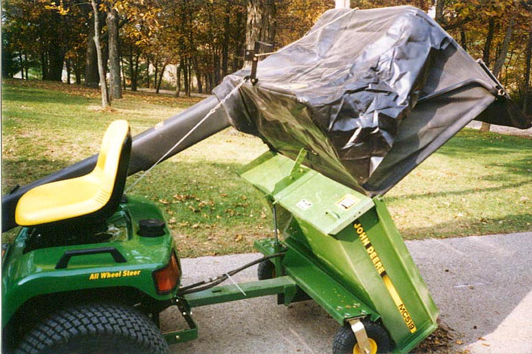

I have a 4300 and a 445. The 445 will power a 4-way front blade (with down pressure or float), a broom on the front, or a snow blower or snow thrower. I use the hyd. connectors to dump my MC519 cart. Next week I will be putting it back on the 445 to begin the fall leaf pickup here and on other properties. The dump is really great.
I have the FEL on the 4300 so do not need anything like that for the 445.
Have you added any attachments to your 455?

Beenthere, that is the first picture I have ever seen of the dump cart dumping, good pic! I wish i could get a cheap bagger for my 4100.
