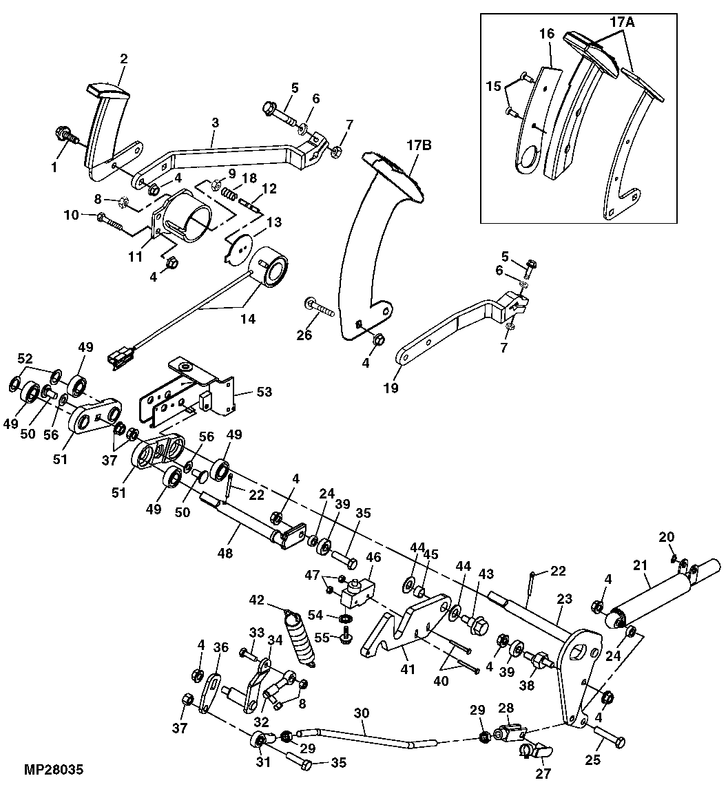

I have a 2000 4600 HST that is sluggish when changing directions from forward to reverse and visversa. I have had the tractor about 4 months and up until the last week or two it has worked fine. It does't seem to be as bad when it is cold. I took it to the dealer a week ago and they changed the fluid and filter and said they couldn't get it to act up. I drove it back to my shop about a quarter mile away, put a blade on it started blading and it seemed to be working normal. About 5 to 10 minutes later and several times of changing directions it started acting up again. When it happens and you chang directions, there is a lag of about 3 to 4 seconds before the tractor starts moving in the opposite direction. Any Ideas? Please

I have checked the linkage and it appears to be ok. The pedals move fine. It acts more like it a hydro problem. There is an electro-magnet along side the foward pedal that seems to have a nut broken off of it, letting it rub against the side of the pedal arm. I'm not sure what its function is.
   / JD 4600 HST sluggish when changing directions #5
That electromagnet is the cruise control. There is a micro switch under there as well but i think thats for neutral start. Wish i could be more help.
   / JD 4600 HST sluggish when changing directions #6
this is a diagram of what hst pedals should like. With tractor engine off, move each pedal and watch the movements of linkages to hydro.
