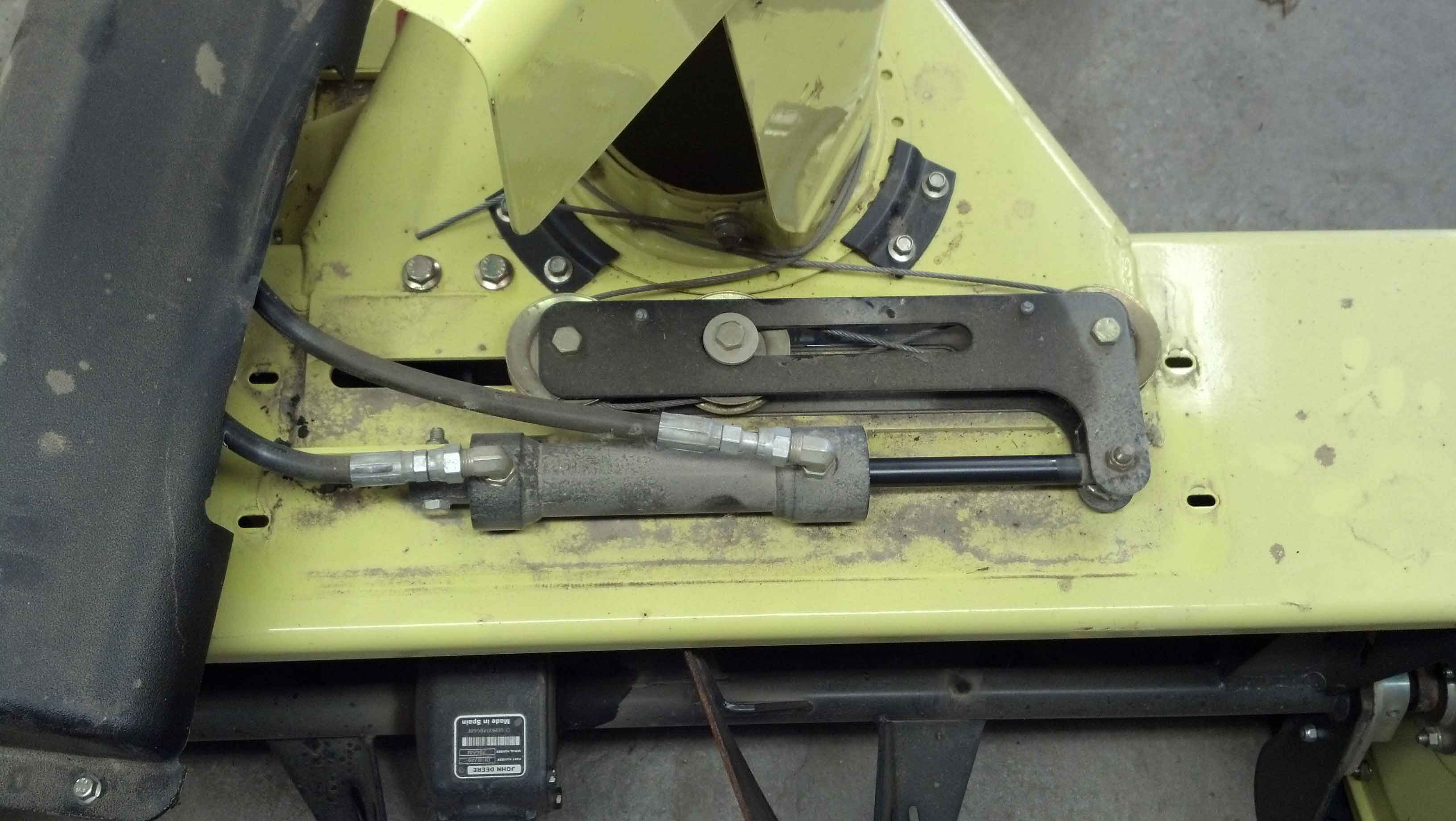

I have a 47" snow blower on a 4100 John Deere. I have had both for a few years, but haven't needed the snow blower. My problem is that after putting on the snow blower this morning, I noticed that my hydraulic chute only moves from a few degrees to right of straight ahead, to 90 degrees to the right. Is this normal? I guess I thought it should be able to swing to the left also. Makes it a little tricky to blow snow if you can only blow it in one direction. I can take it into the local John Deere shop, but thought I would try here before spending that money.

You are right, it needs adjusted. It should rotate at-least 95 degrees left and right of center.

Will it work both ways if you just move the joystick a little bit? If so then do a search for the term "regen" for lots of reading, you can add my name if you use the advanced search.
   / JD 47" quick hitch snow blower chute #5
Doesn't this just have a cable wrapped around the chute activated by a hydraulic cylinder ? I don't see much exploration here. Unhook the cable to check the cylinder. Next stop is the cable. I wish electronic problems were this easy to diagnose.

I would bet the cable broke. Happened to me a couple times.

Thanks for all the responses. First, Kennyd, I thought you had it, but that doesn't seem to do it either. I'm fairly sure it has something to do with the cable, but danged if I can figure it out. It is not broken, and the chute swings great though the 90 or so degrees of travel it does move. I called my service guy and he seemed to think warrenty would take care of the problem so I'm headed in there today. I'll let the thread know what I find out.
Here is a pic of the dang thing.
Thanks again.

Is this the first time you ever use your blower? If so, by the look of your picture your chute was probably not adjust correctly when assemble the first time. When I bought my blower, the chute was not assemble, had to do it myself with the instruction that came with it. Easy to do but still took me a few try before I got it perfectly align from left to right.
